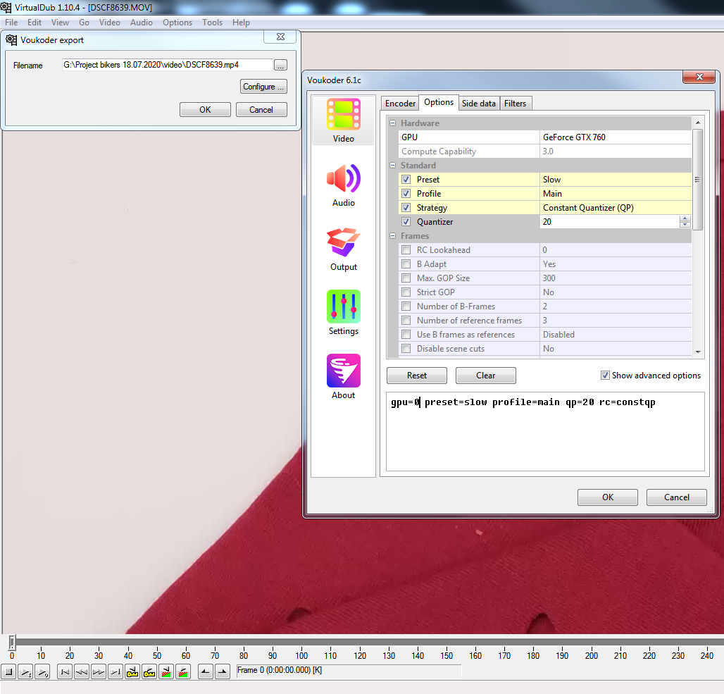

I've ran a few tests with version 6.1c (which shows all encoders), if you select Preset - lossless, Virtualdub crashes, Voukoder shows error. If you select QP=0, everything is fine, but it doesn't seem to be lossless, like with CRF 0 in x264:))

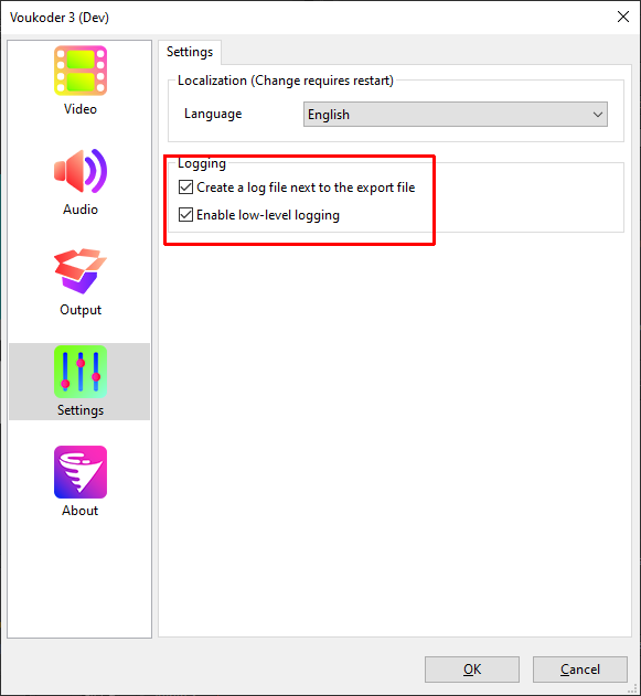

Please try this:
- Make sure low level logging is enabled
pasted-from-clipboard.png - Download and install this: https://www.voukoder.org/_download/voukoder-6.1c.msi
- Start up your app and check if the encoders appear or not (it's okay if they don't appear)
- Open the explorer and go to %LOCALAPPDATA%\Voukoder\Logs
- Open the log file with todays date and copy it to the forum / send it to me.
This file should contain the reason why an encoder could not be loaded

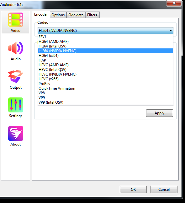

VirtualDub 1.10 with voukoder. I can see all hardware codecs, like AMD (I have Intel) and QSV (I have old intel 2600k without QSV). And NVENC also visible. Attached screenshot.
First attempt to export video - alert window "error in Voukoder", failed. Attached log1.txt
Second attempt to export - success! Attached log2.txt
Third attempt - success! Attached log3.txt
So, 2 of 3, it's working somehow:)
