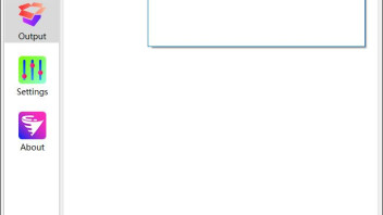

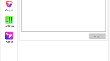

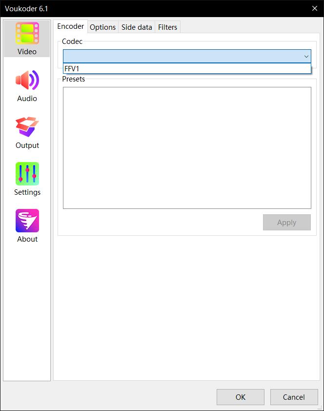

Voukode6.1 cannot be used normally in Premier Pro 2018

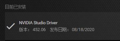

  • My video card is nvdia geforce GTX 1050ti, the current version is studio 452.06, and the connector used is premiere-connector-1.5.0.
    When I install voukoder6.1, I can't set it in PR's export interface. Version 6.0 does not have this problem.
    My PR version is Premier Pro CC 2018. I tried to export in after effect (using aftereffects-connector-0.9.4) as well.
    Please see the picture for details. Hope to fix this version as soon as possible.

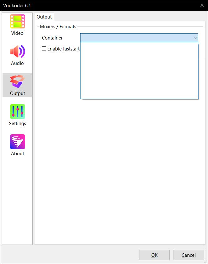

  • Yeah, I'm bored, so I don't know why, but I examined your logs. You forgot to say, that you were able to successfully export with NVENC for two times in a row with 6.1 version, and I assume you were using previously created preset? So with preset (and without calling voukoder's GUI) export is working? Then I found out you connect one monitor to internal videocard (intel) and another to external videocard (nvidia), so you have notebook? Can you try to use voukoder without second monitor? And voukoder hangs when loading (and not unloading) h264_amf, which is AMD hardware encoder. It's really, really strange and I presume maybe, just maybe you were using this version of windows with AMD videocard? And then changed notebook and kept windows? Theese are all IMHOs and maybe I'm digging completely in wrong direction, but!.. :)
    • Official Post
    The strange thing is this error (that the list of encoders is empty) just occurs to a few users only. Looks like the data from the resources files is missing after the initialization.
  • The strange thing is this error (that the list of encoders is empty) just occurs to a few users only. Looks like the data from the resources files is missing after the initialization.
    Yeah, I've tested my CC2018 like an 100 times, everything is fine. I was trying to reproduce it, tried BT.601, limited and full range, different aspect ratios - nothing happend, everything is working. And in voukoder_h's logs I've found this:

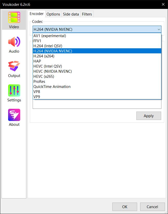

  • The issue with NVENC not being available has been fixed in 6.1rc2.
    Did you try version 6.1rc2?
    I have NVENC in 6.1 release, everything is fine. I didn't try 6.1rc2, I installed 6.1 (from your post here) without release candidates. Here I'm trying to help, because you know... I think I'm smart, I'm from IT departament and as they say "Two heads are better than one":) If I'm completely wrong (with voukoder 6.1 hangs on h264_amf, ffmpeg glitch with AMD hardware encoder) and messing with your work I can shut my mouth and only read with curiosity:)
    P.S. I've just tried 6.1rc2 - NVENC and other encoders are visible and working like a charm, in CC2018 and VirtualDub:)

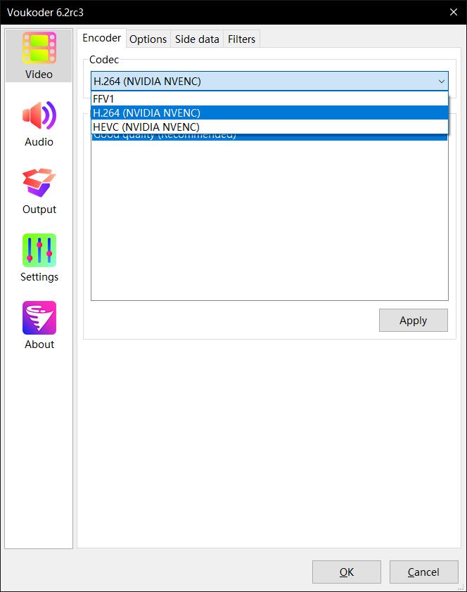

    The bitrate issue is solved. We now focus on the empty encoder /options selection.
    voukoder_h Are the issues mentioned above solved with this version? https://github.com/Vouk/voukod….1rc3/voukoder-6.1rc3.msi
