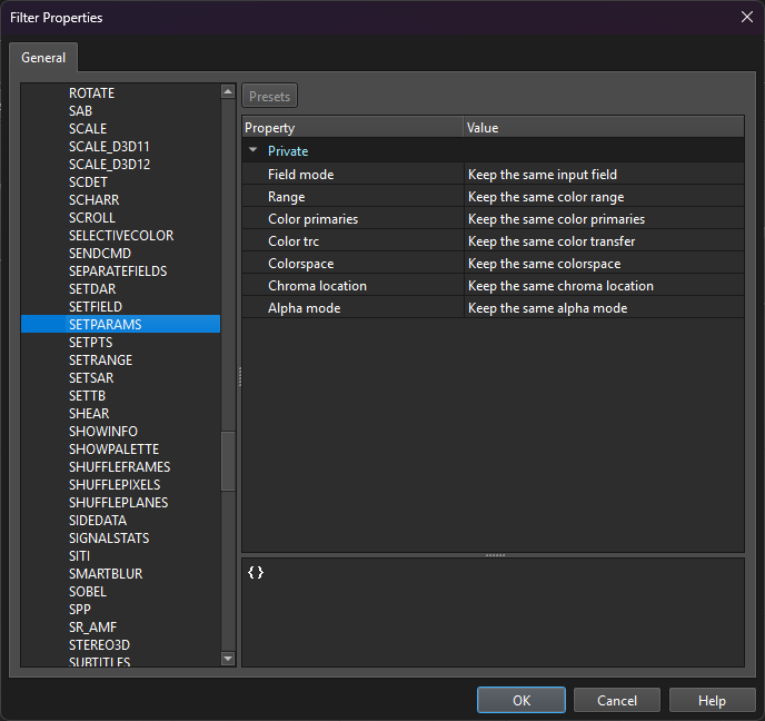

Vouk replied to the thread Vegas - Voukoder ... Pro rendering questions.
I don't have much experience with AMD encoders, but ...
... would it help if you use the SETPARAMS filter?

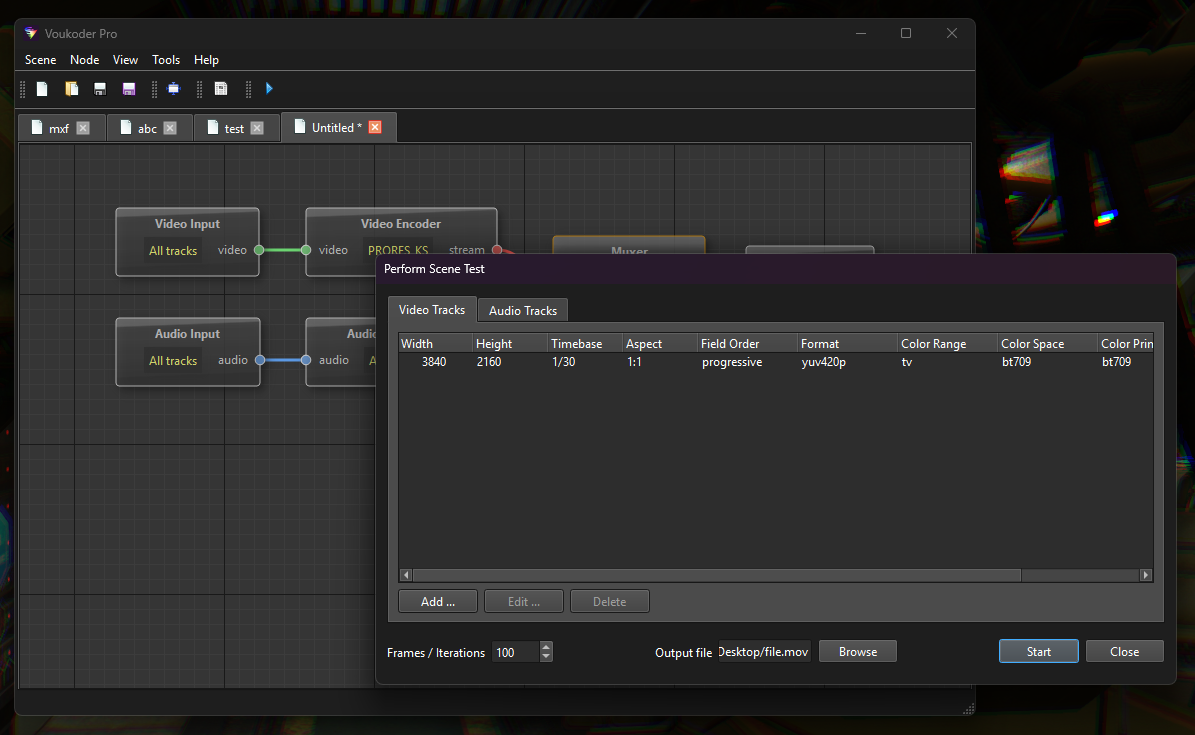

Yes, please switch logging to the TRACE Level:
And then perform a Scene-Test here:
And please paste the full logfile.

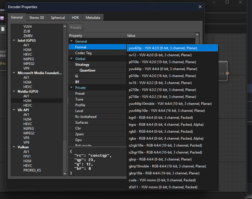

What finally decides about the actual export color format is this dropdown here:
In VEGAS Pro you can just select the format which is sent to Voukoder Pro. So if you send 8 bit data to Voukoder Pro and export 10 bit data to a file, Voukoder just converts 8 bit data to 10 bit, but effectivly it is just 8 bit data packaged as 10 bit. In theory you could do this, but the other way around (10 [or more] bits -> 8 bits) would actually make better results.

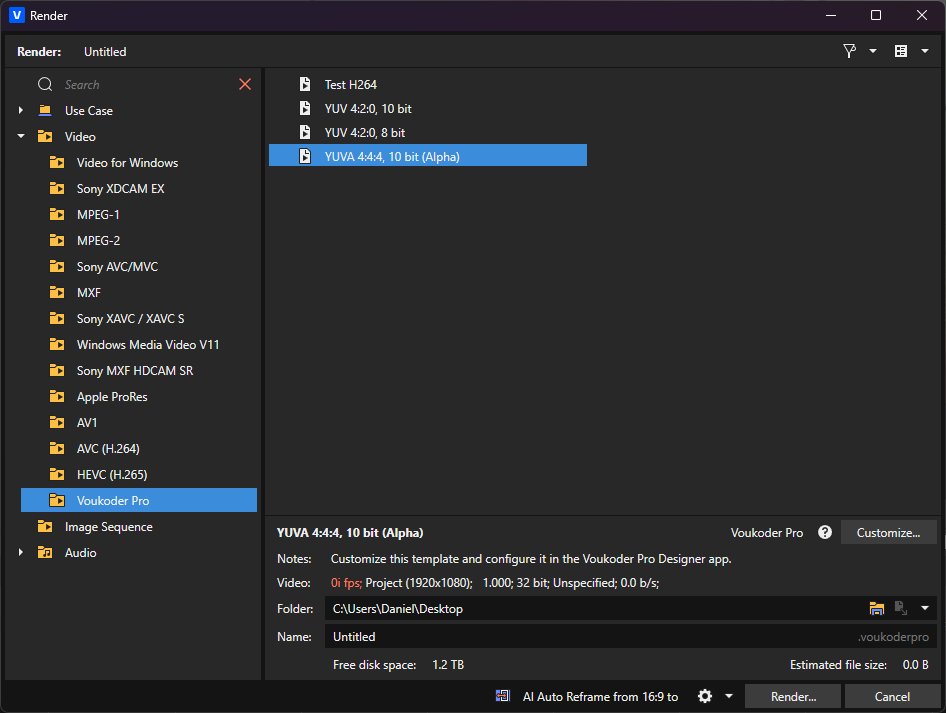

Vouk replied to the thread Voukoder Pro - Alpha Channel Problem.
Thanks for reminding me. I am looking at it now ...
What template did you select to use for Voukoder Pro? If you want an alpha channel you have to feed the alpha channel into it. Only one template does this in Vegas Pro:
