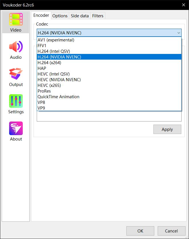

Many thanks to Kleinrotti for finding the issue!

Okay! Finally: https://github.com/Vouk/voukod….2rc6/voukoder-6.2rc6.msi
That is great! It's finally working! Thank you for your repair!

Version 6.2rc3 is changing in an effective direction. My voukoder can display part of the encoder, as shown in the figure. But compared with the previous encoder is still missing.
I'm glad to see that your modification has partial effect. This is the log2020-09-10.zip of this time. I hope to fix this bug completely
