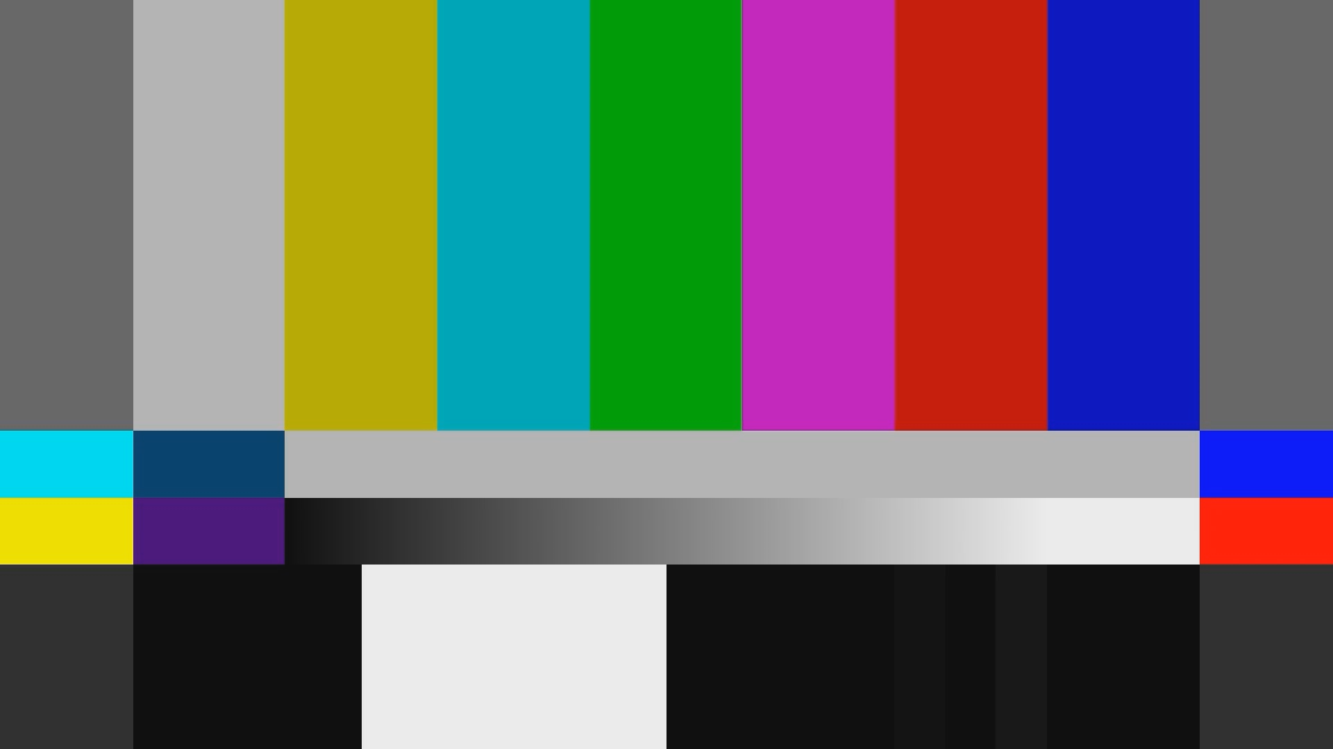

dream I will try to reproduce your exact scenario tommorrow. I still recommend using the "Limited" color range when using YUV. The footroom and headroom is used by some cameras for super-black / super-white. I've read this was a reserve in the good old analogue TV times.
The problem with that, is when you upload that video to youtube, the video will also look "dark" if a user enables the full range in his browser/device or in the nvidia control panel.
Like other people said, its a Vegas problem and the only solution at the moment, is to use the Vegas Pro level filter > Computer RGB to Studio RGB.
Thanks for testing all that!

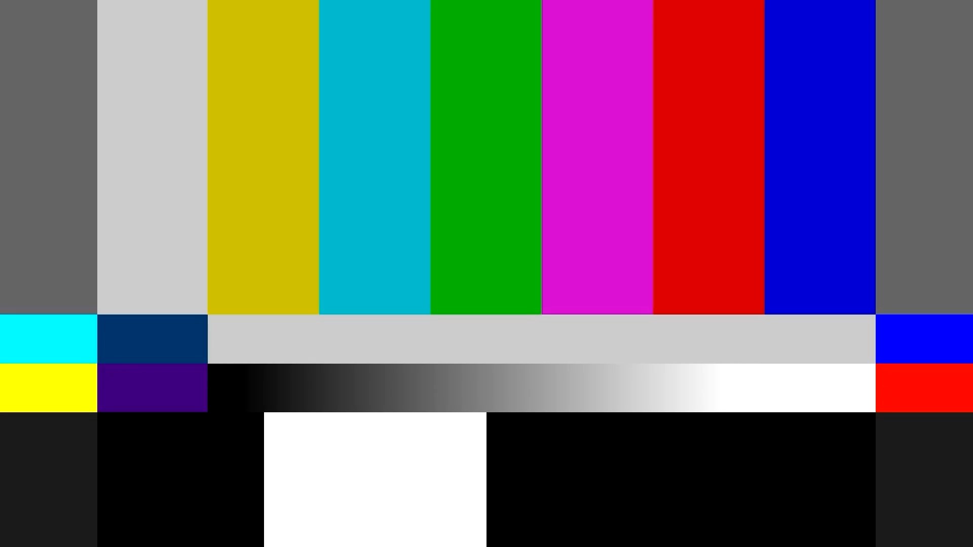

That's not the point at this moment. Let's do a systematic approach and investigate this step by step. Currently we are investigate what goes into VEGAS and what comes out of it. What YouTube is doing with it is a different story (and investigation).
At this point the video levels of the input ("Reference") source and the Output have been always identical. Show me video files where this is not the case and prove me wrong.
Do the steps I did in my previous post, make screenshots and compare them to eachother.
Just read your PDF.

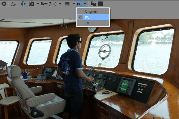

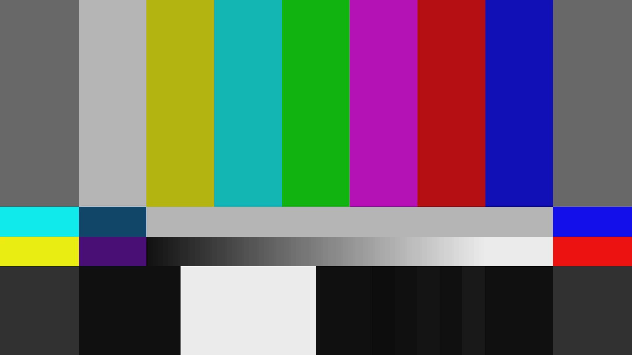

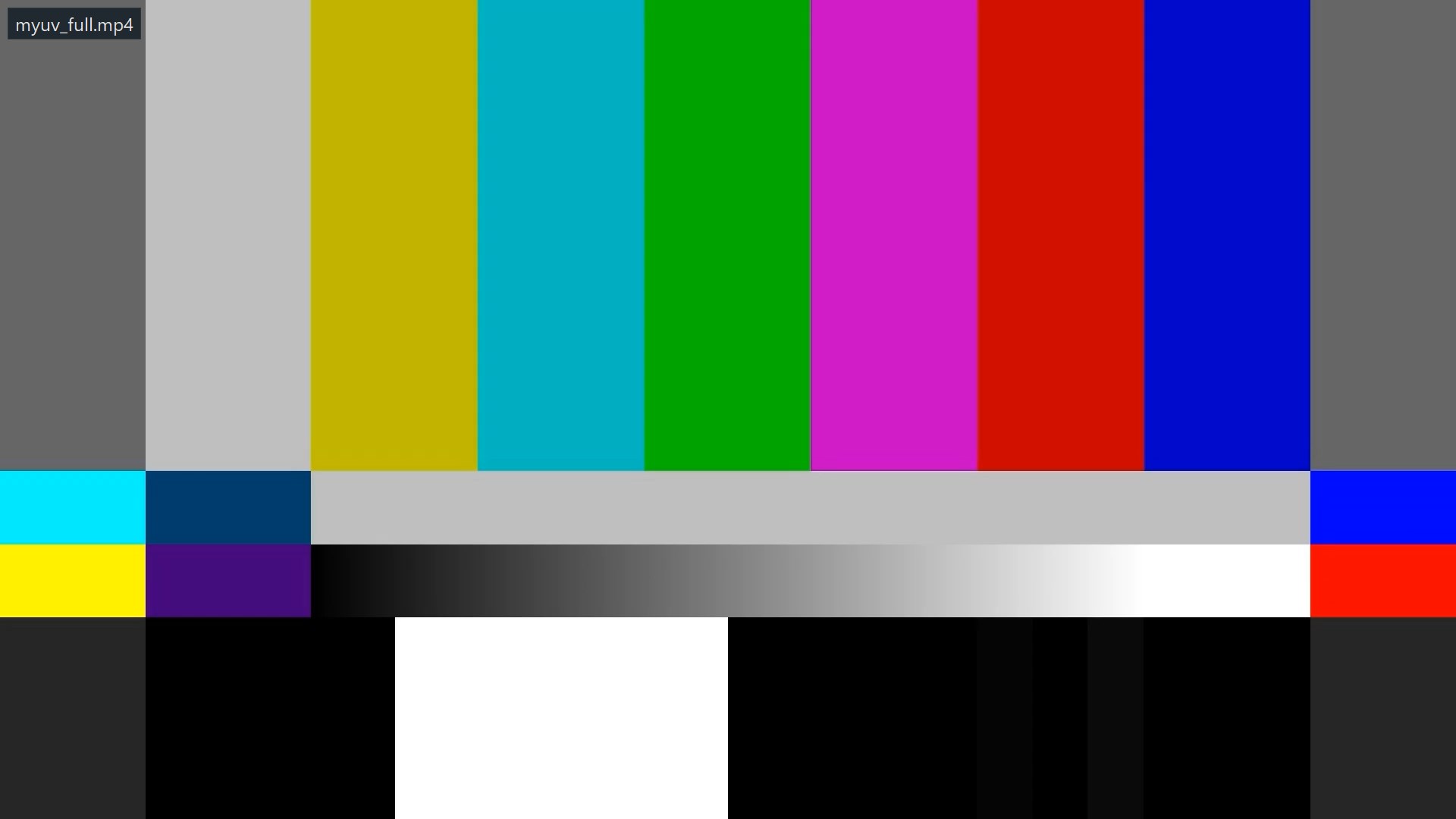

If you feed MPC with video with limited levels meta data, MPC will do a studio swing to full swing conversion. What you then see in MPC is not the source levels, it's the source levels converted/mapped according to the meta data.
Now Vegas Pro ignores limited levels meta data and using the internal preview it will always map the source video data 1:1, no matter what the meta data says. Also the internal preview will always override your grafic card setting. So even if you set your grafic card to display studio swing as full swing, the preview will map the source video data 1:1.
If you download this zipped file (with two video clips in it) and open both videos in MPC player and Vegas Pro you will see the video levels are different in MPC player but they are same in Vegas Pro. This is because the video stream of both files is exactly the same. The only difference is the levels meta data (which is ignored by Vegas Pro).
This is desired behaviour for many pro users because it preserves data which would be clipped otherway and it prevents banding caused by the mapping. But it's up to the user to use additional display options, just like using the external preview (which will then use the grafic card setting) or external preview devices (with it's own settings).
We consider the internal preview to be used just like a technical instrument (similar to a class-1 monitor device and the scopes) while at the same time we use an external preview for the aesthetic part of the job.

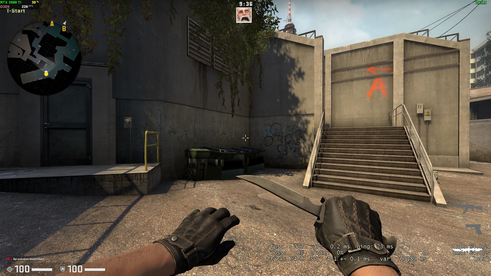

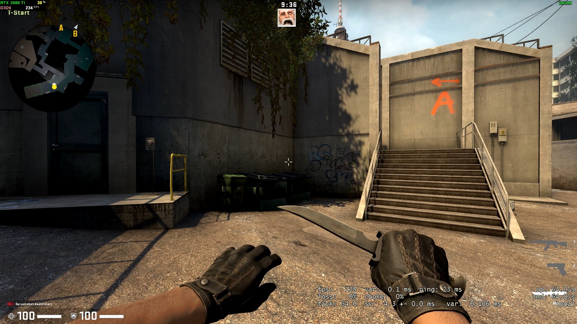

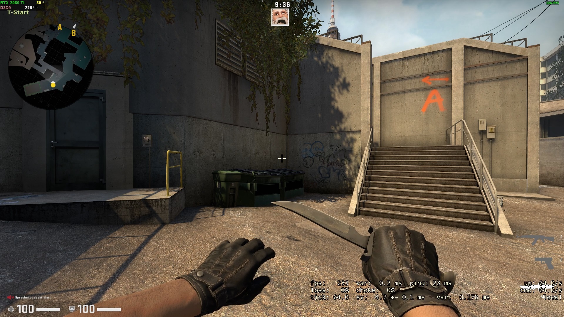

This time i recorded with Dxtory but it shouldn't matter, because i used UtVideo YUV420 BT.709 VCM.
Mediainfo from reference (Source):
General
Complete name : G:\csgo 2019-11-22 14-39-44-832.avi
Format : AVI
Format/Info : Audio Video Interleave
File size : 381 MiB
Duration : 4 s 433 ms
Overall bit rate : 721 Mb/s
Original source form/Distributed by : Video:UtVideo YUV420 BT.709 VCM
Writing application : DxtoryCore ver2.0.0.142
Video
Format : YUV
Codec ID : ULH0
Codec ID/Info : Ut Video Lossless Codec
Codec ID/Hint : Ut Video
Bit rate : 721 Mb/s
Width : 1 920 pixels
Height : 1 080 pixels
Display aspect ratio : 16:9
Frame rate : 60.000 FPS
Color space : YUV
Chroma subsampling : 4:2:0
Compression mode : Lossless
Bits/(Pixel*Frame) : 5.797
Stream size : 381 MiB (100%)
Display More

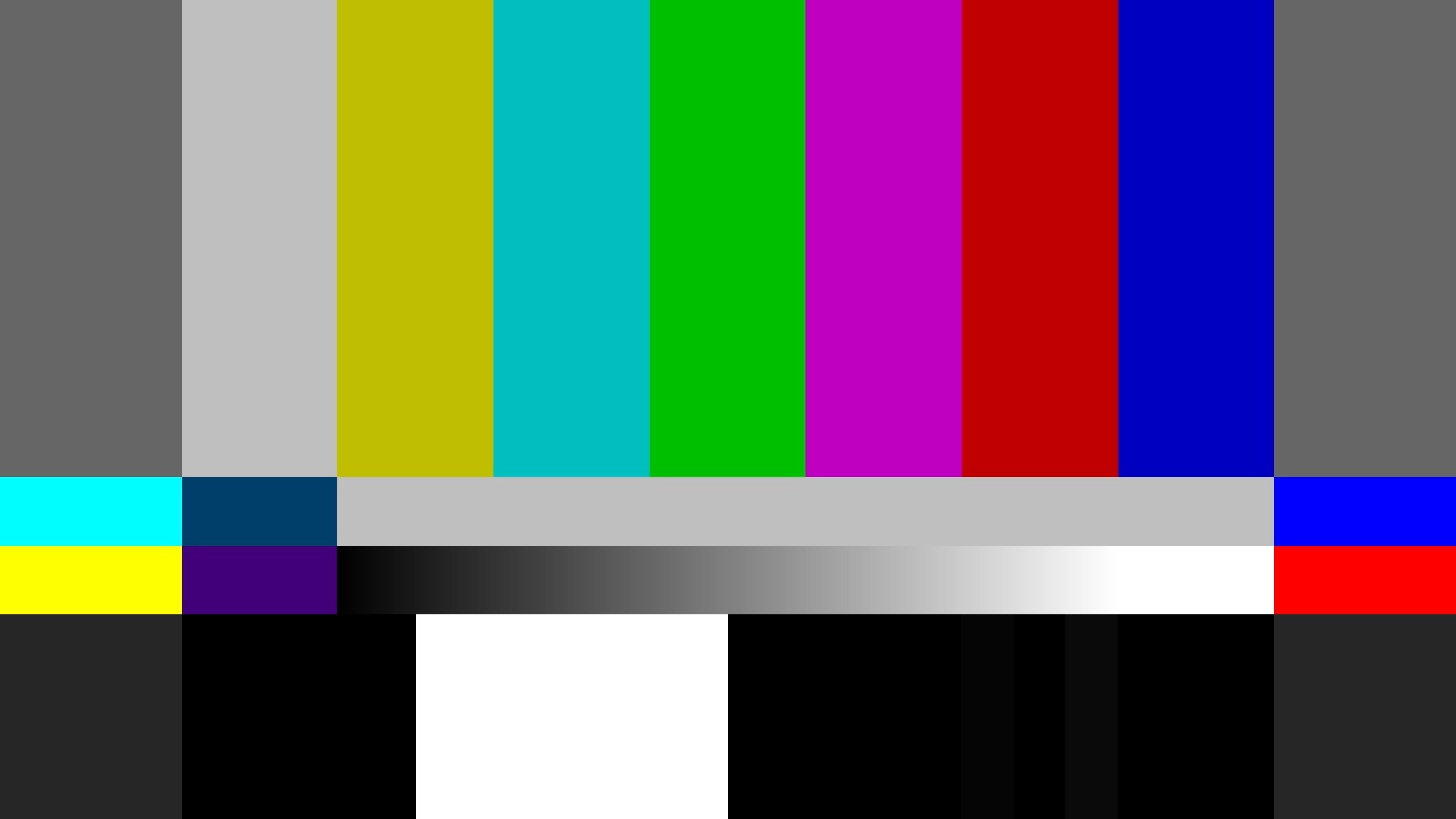

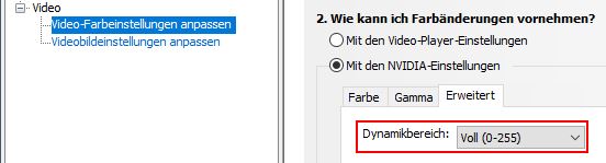

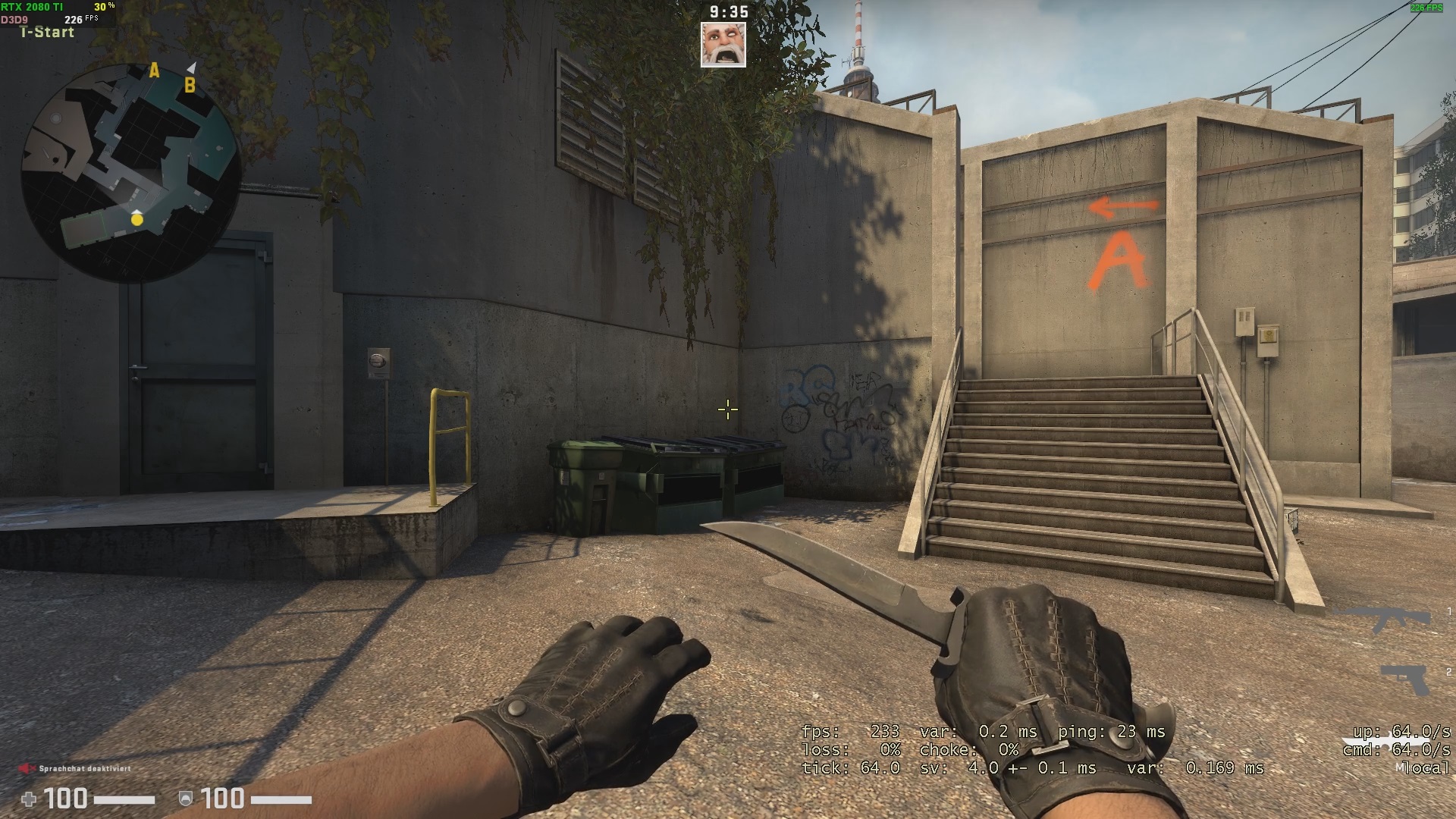

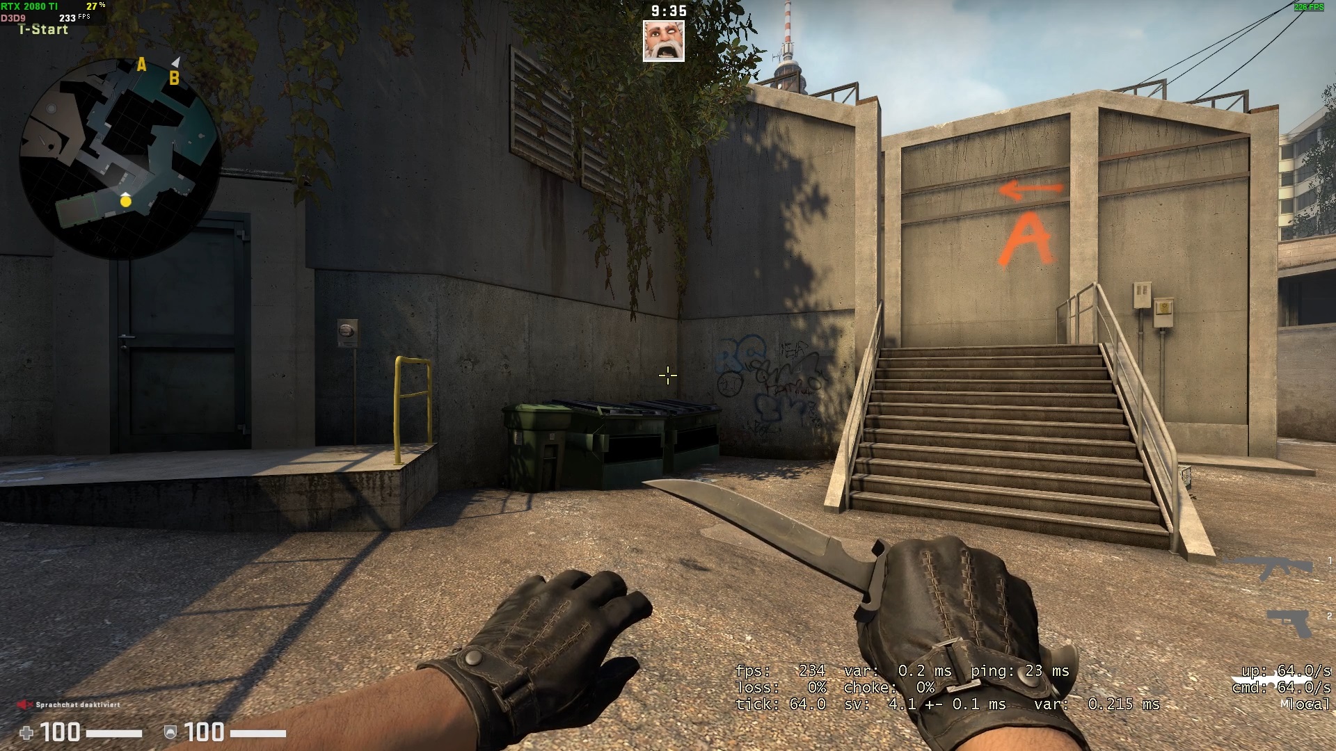

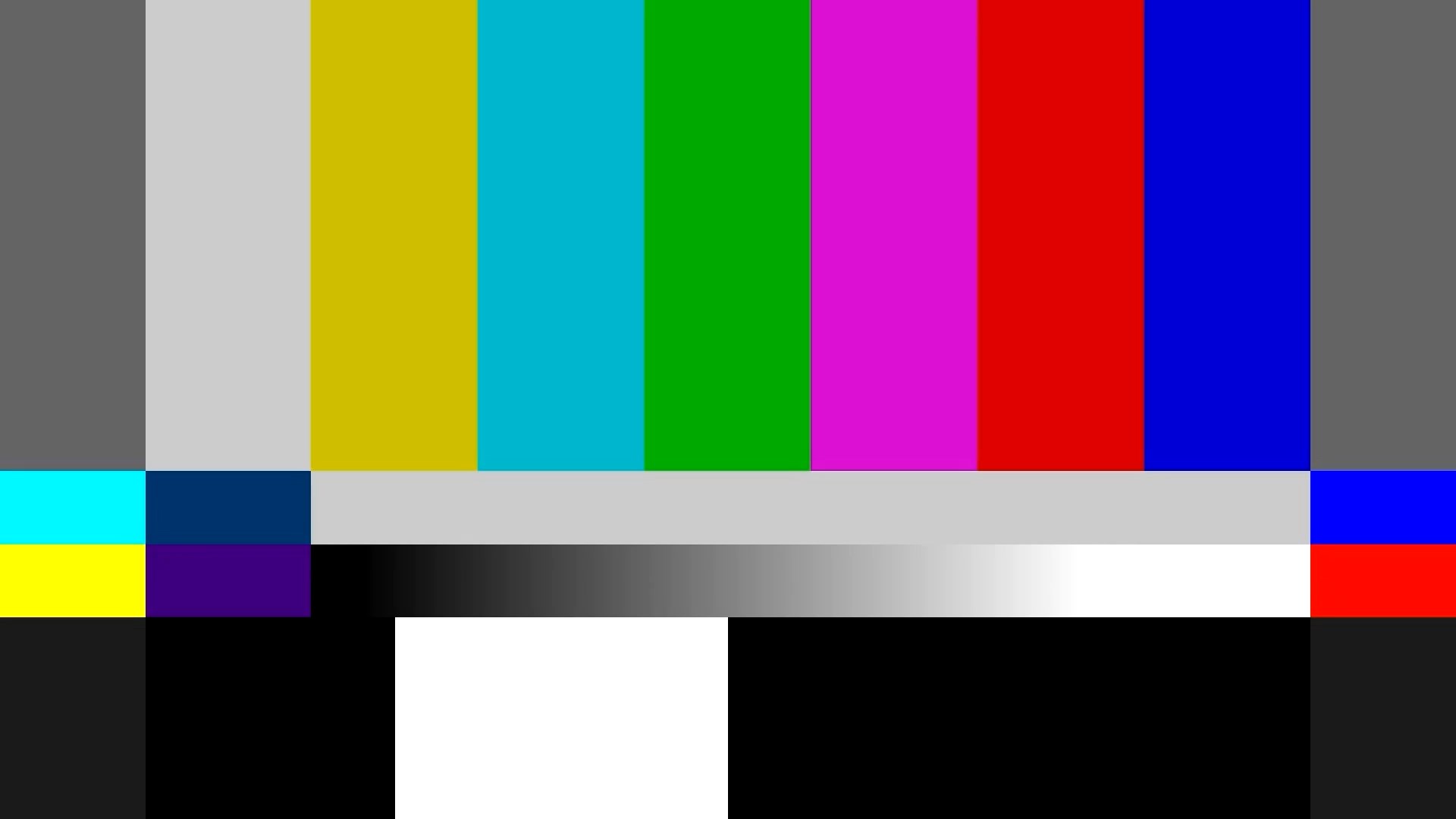

In the table view i try to demonstrate the problem with Vegas and lossless .avi files (i don't know if something else is also affected)
Notice: These are the NVIDIA Control Panel settings i normally use, for this test i switched between limited and full and show the results in the table:
| Reference (.avi UTVideo 4:2:0 BT 709) | Software | x264 Output Limited (16-235) (NVIDIA Control Panel) |
x264 Output Full (0-255) (NVIDIA Control Panel) |
| Vegas Pro 15 | |||
| FFMPEG |
Vegas Pro 15 output
As you can see the output from Vegas Pro 15 is "much" darker when full range is enabled in the NVIDIA Control Panel.
This can be fixed by applying the Vegas Pro 15 filter "levles" > computer RGB to studio RGB.
Then the Image would be bright on limited output, but would look like the source on full.

FFMPEG and other software
FFMPEG, MeGUI and x264vfw (Each software is able to encode with x264) handles videos like the images show above next to FFMPEG.
On limited range the image is brighter and on full range its like the reference source, when you have a .avi source recorded in bt 709, limited range (like i said i don't know if something else is also affected)
FFMPEG settings:
ffmpeg -i "input" -pix_fmt yuv420p -c:v libx264 -preset medium -crf 21 Output.mkv

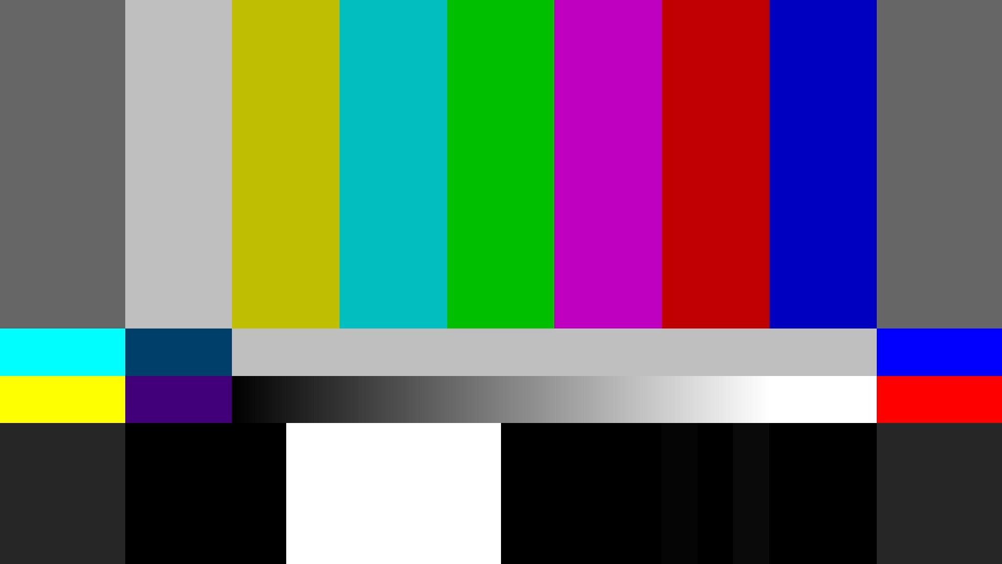

Somehow x264vfw with Vegas can output the video correct, but the process is a bit more complicated to write down, why i choose ffmpeg as an example above...
And again its not a Voukoder problem, but a Vegas Pro problem ![]()

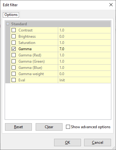

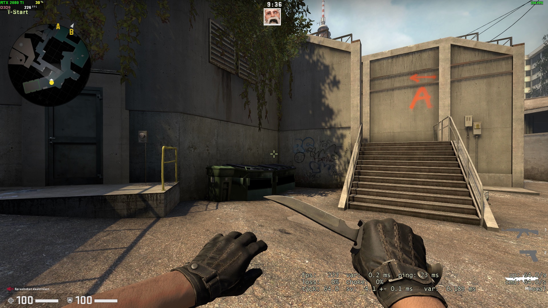

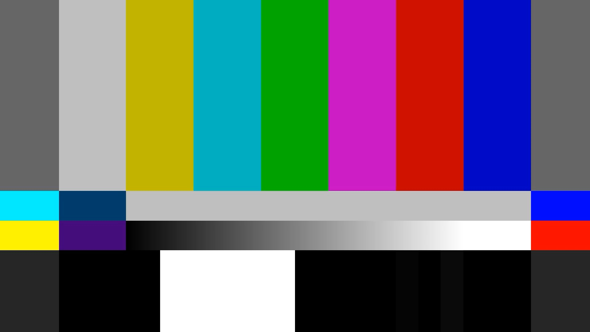

With Voukoder 2.3 my lossless avi files get the correct colors, because i can use this code from ffmpeg in voukoder:
ffmpeg -i "G:\test.mkv" -vf "scale=in_range=pc:out_range=tv" -pix_fmt yuv420p -c:v libx264 -preset ultrafast -crf 21 Output.mkv
Now i get the correct colors in the output with
colorspace filter setting for lossless .avi files recored in limited range:
Output
Input:
Thank you for your excellent work and fast responses.
I now get correct results using the parameter filter for setting the "limited" and "full" flag. Good job.
The new Color Space option hits the nail right on the head now Vouk !

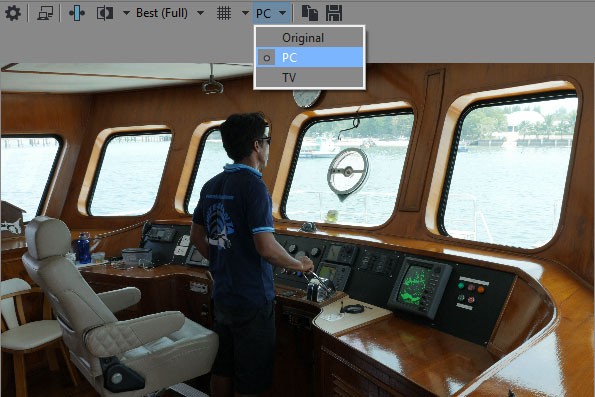

Vegas Pro 18 added a new 8-bit full range default where jpegs, full range and limited range video are all mapped to full range using metadata for video files. If a file isn't displayed properly you can manually change it from limited to full range. Vegas also has limited and full render settings upon export.
I think Vouk is aware of this and the software modified to reflect changes in VP 18.
rsmith02, Everyone is aware of the new Pixel format (8-bit full range) feature in Vegas Pro 18 when it was released (a highly welcomed option)..... So this topic is no longer an issue for Vegas Pro users nor for Voukoder.
