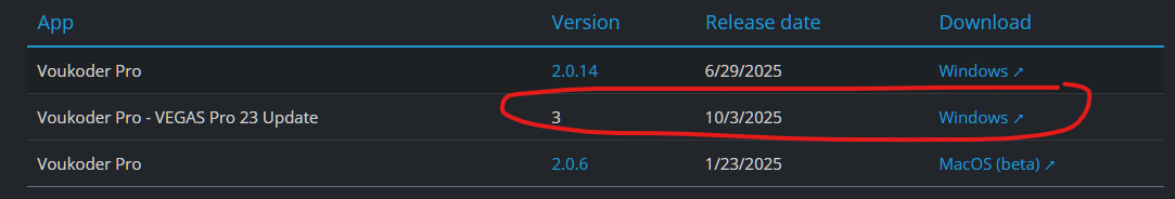

I' ve Voukoder Pro - VEGAS Pro 23 Update copied the files as described in the README.txt
My FFmpeg Version is 7.1 and Voukoder Pro Version 2.0.14

First, I hope you meant with "Voukoder Pro 3 files" actually this file VoukoderPro-2_VEGAS_Pro_23-v3.zip.
This should be copied over the VEGAS Pro 23 directory and install the new Voukoder Pro plugin there.
Otherwise it's never good to mix different versions of tools.
Please tell me the version numbers you have installed.
Confirm V2 working in V23.
(with the new VoukoderPro-2_VEGAS_Pro_23-v3 files copied to the correct places), Nice one. -
