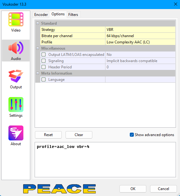

Simple question: the initial download "libfdk-aac.zip"... is the latest version of FDK AAC Encoder??
VBR in HE-AAC is possible now??
I noticed the audio streaming client butt also offers libfdk-aac-2.dll for its users, it's 1.3 MB and supports VBR, HE-AACv1 (AAC+) and HE-AACv2 (eAAC+) with Fraunhofer's qualitative tuning, VBR & CBR and LC-AAC.

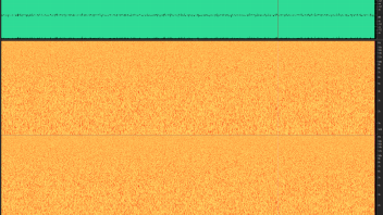

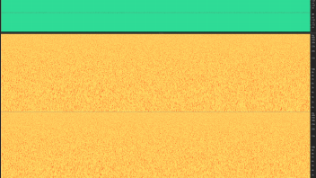

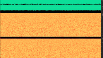

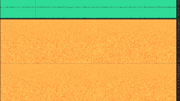

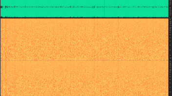

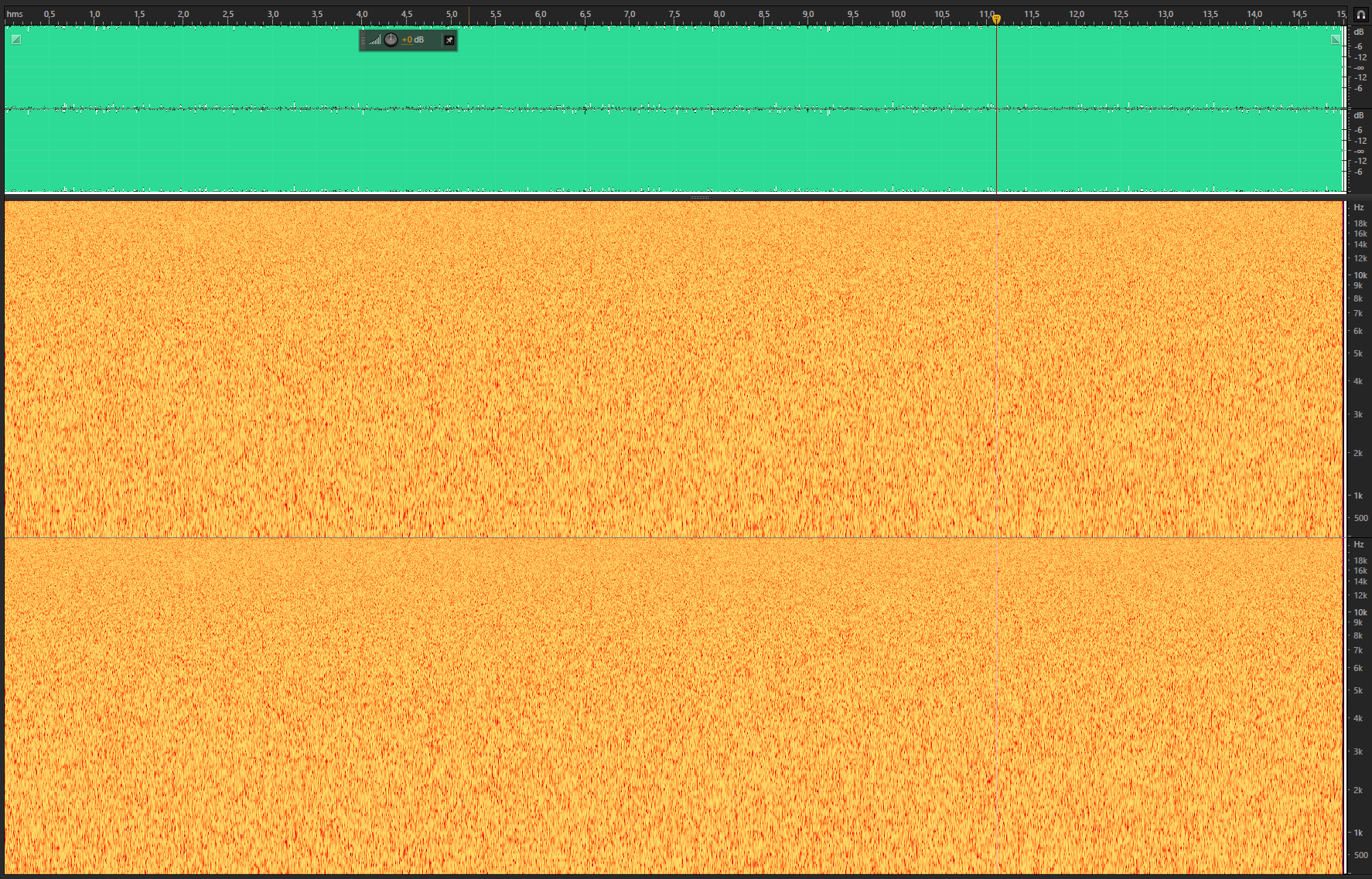

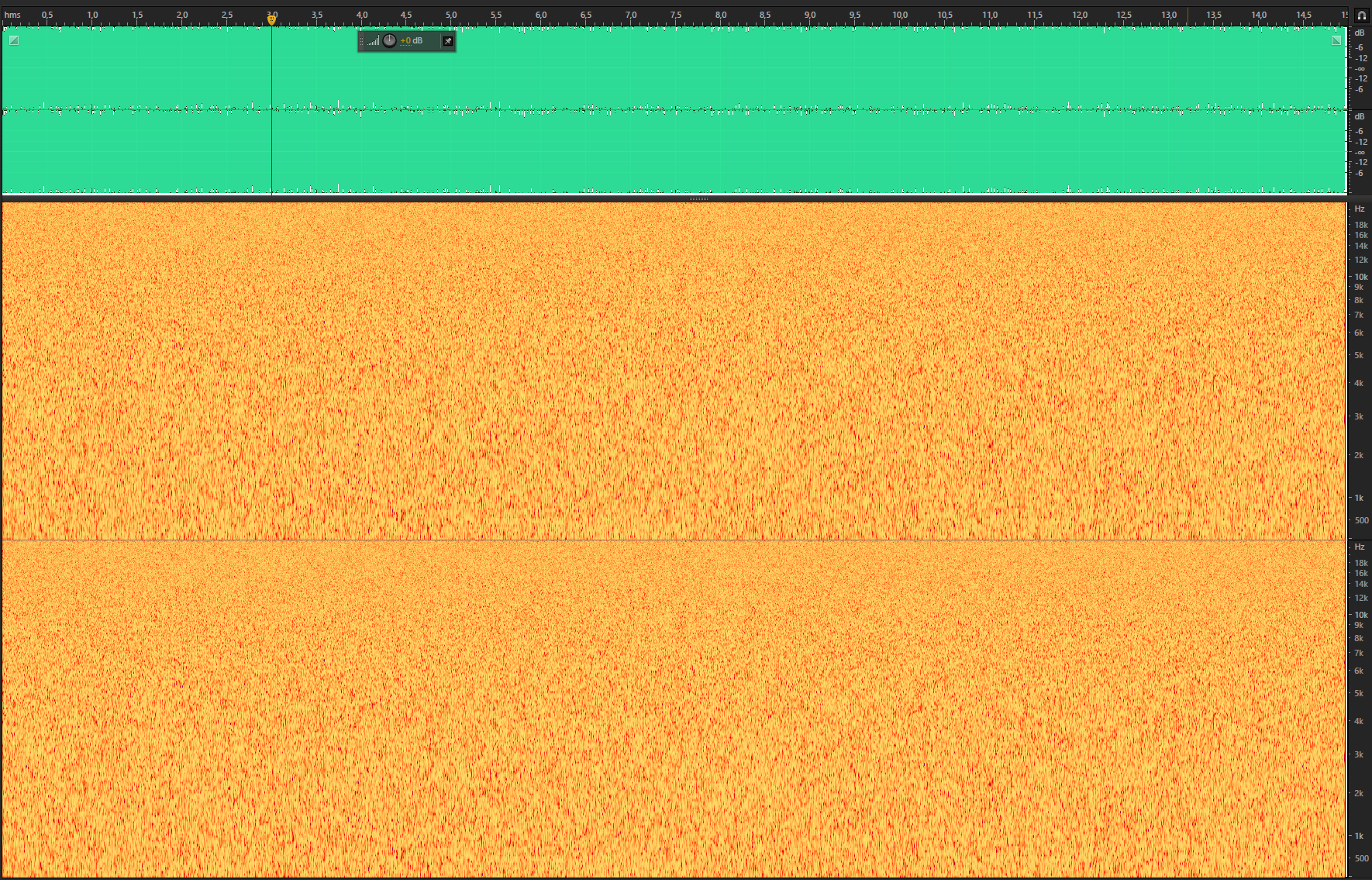

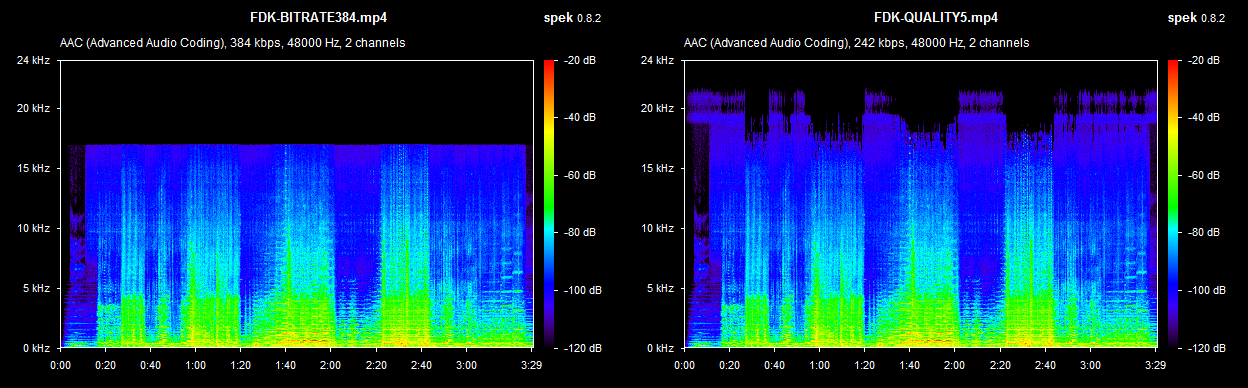

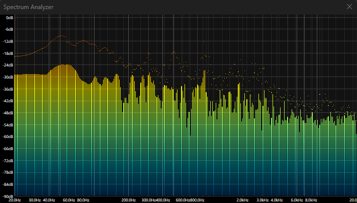

Display MoreI did some tests with a sequence of white noise. I made a screenshot of the spectralview in Audition. The results are attached as PNG-pictures:
01-uncompreessed.png: Uncompressed - this is what it shoul look like

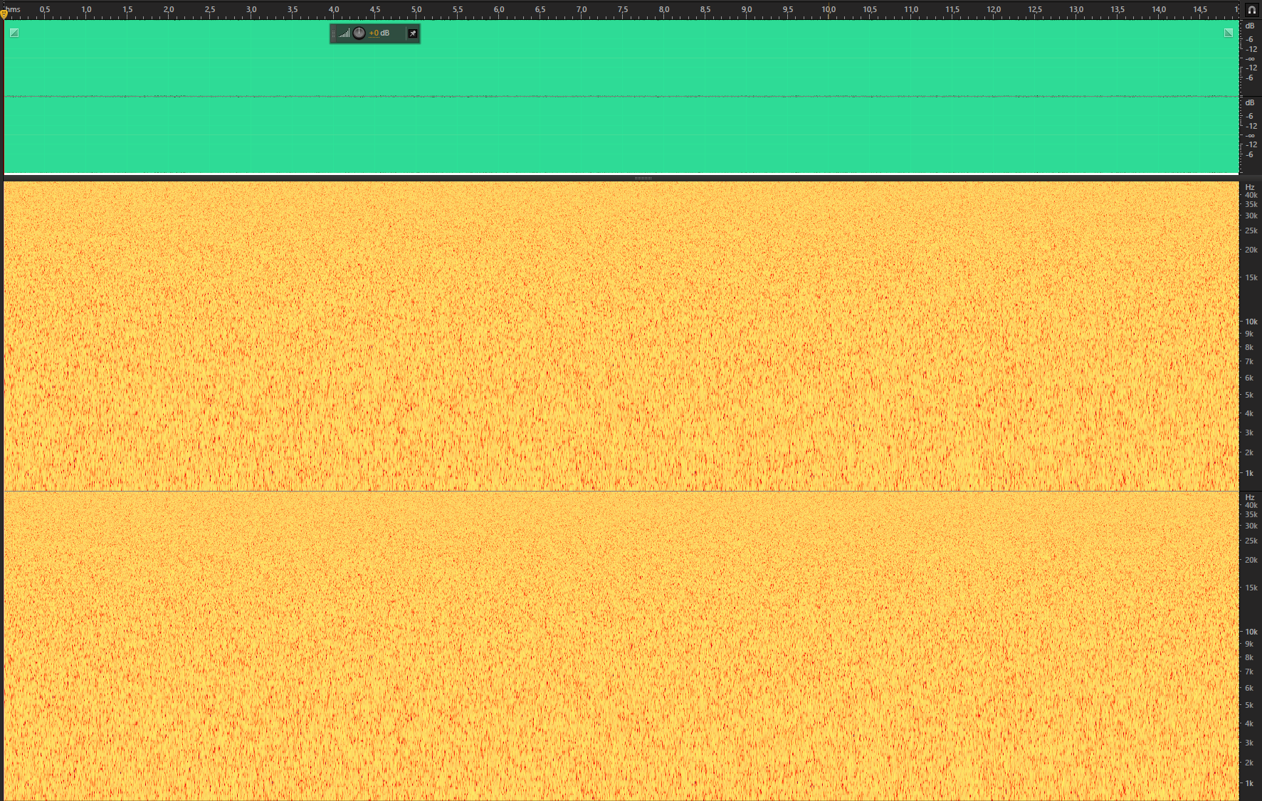

02-AAC-ffmpg_CBR_320.png: The native FFMPG AAC Encoder at 320kbit (48Khz stereo) - look at these "glitches"

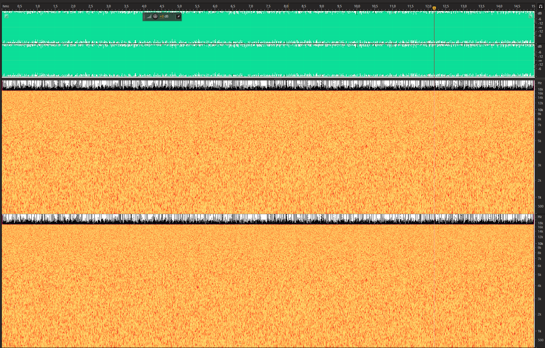

03-AAC-ffmpg_CBR_384.png: Same settings but slightly higher bitrate (384kbit) - noticeably better quality

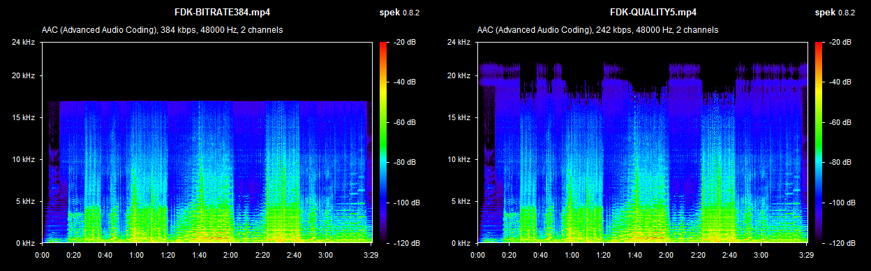

04-fdkAAC_CBR_320.png: fdk AAC Encoder at 320kbit, very good quality, but frequencies above 17Khz are cut

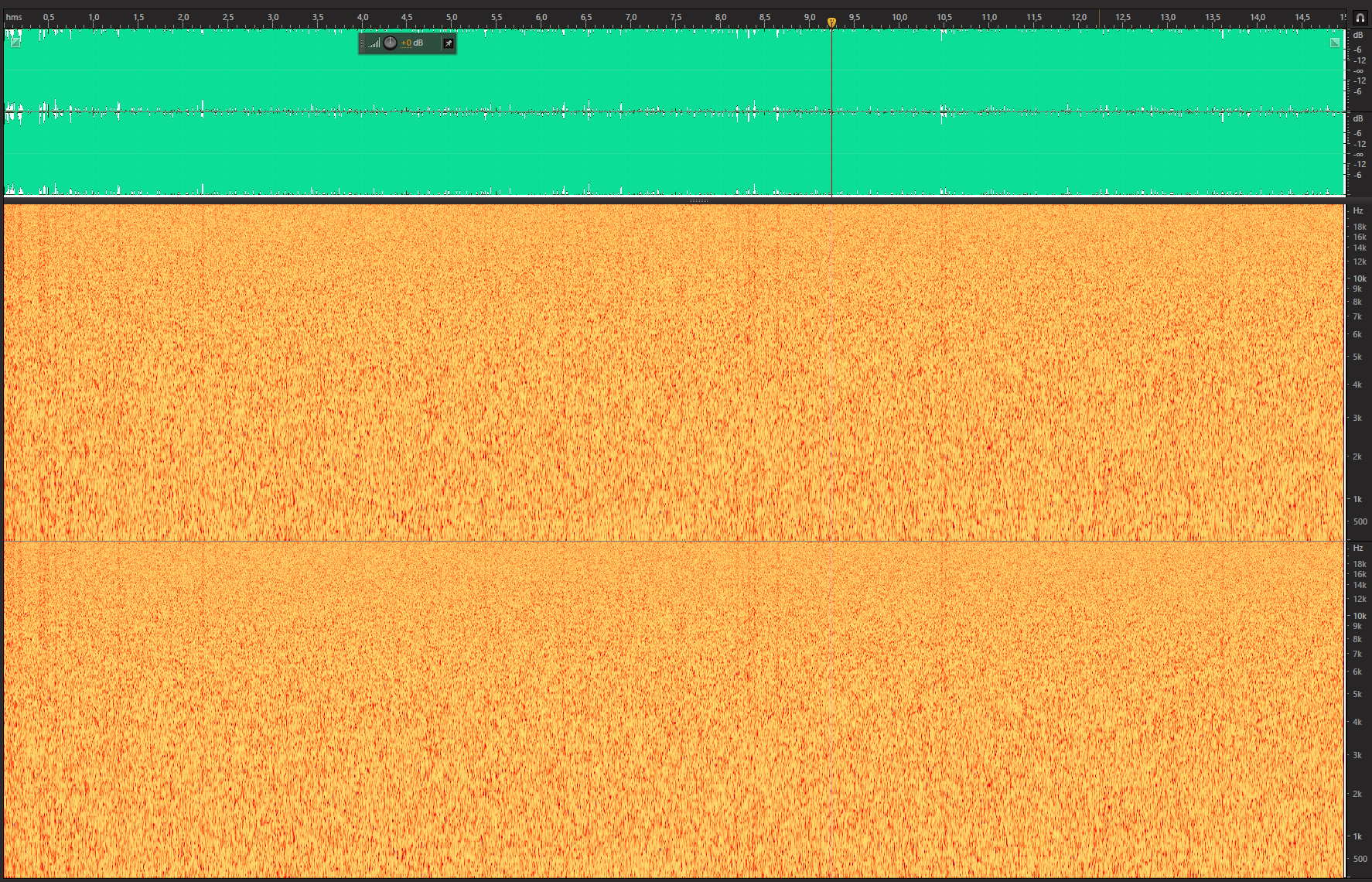

05-AAC_x264Pro-plug-in: AAC Encoder of the x264Pro plug-in. I don't know what encoder is used here but it looks outstanding
So my result is: For best AAC quality in voukoder use the native FFMPG AAC encoder at higher bitrates (min 384) or use the the fdk encoder and live without the 17.000+ frequencies. After some rock concerts these frequencies are blows away, anyway

Which profile are you using for 03-AAC-ffmpg_CBR_384? Low complexity?
