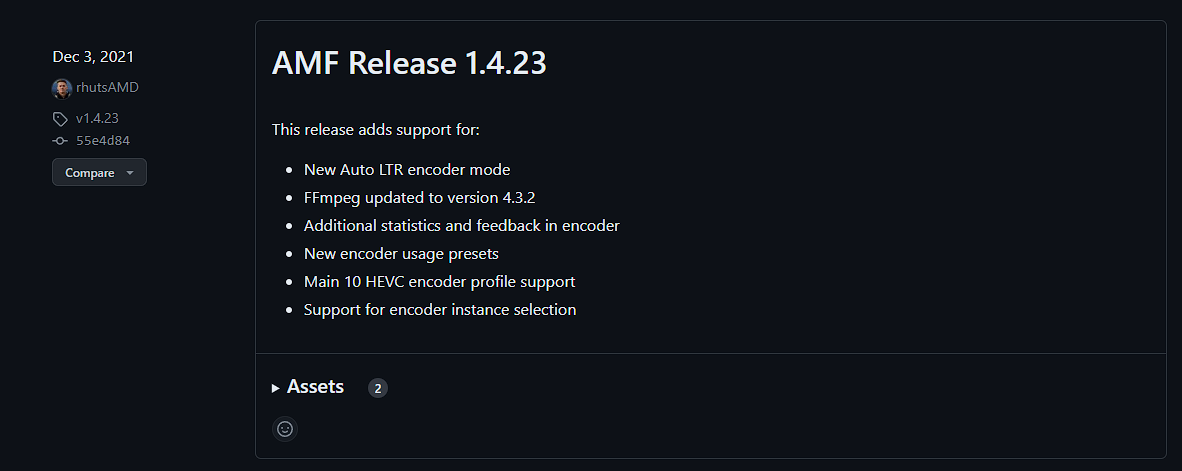

The place your FFmpeg (https://github.com/Vouk/voukoder-ffmpeg) gets AMF from (https://github.com/GPUOpen-LibrariesAndSDKs/AMF) says "Version 1.4.21: AMD Radeon Software Adrenalin Edition 21.10.1 (21.30.25.01) or newer. Added PSNR/SSIM score feedback, new QVBR rate control mode and LTR mode for encoders, added HDR support for HEVC encoder and color converter, new EncoderLatency sample app."
Your FFmpeg says that it is on the latest version of AMF but it clearly isn't. I downloaded your FFmpeg and it was clearly out of date. That's part of the problem.
They added Main10 on December 3rd, 2021. I'm looking through your FFmpeg Github workflows and if I can figure it out I'll make a PR.
It's strange, the static build I downloaded from https://github.com/Vouk/voukoder-ffmpeg/releases has ffmpeg-win64-static-release\include\AMF\ and all the files match the GitHub master branch https://github.com/GPUOpen-LibrariesAndSDKs/AMF but the FFmpeg still shows no main10 and errors out when attempting -profile main10 even though the exact same command in Jellyfin FFmpeg works. I think the FFmpeg build is somehow using an older version of AMF even though ffmpeg-win64-static-release\include\AMF\ has the latest files.

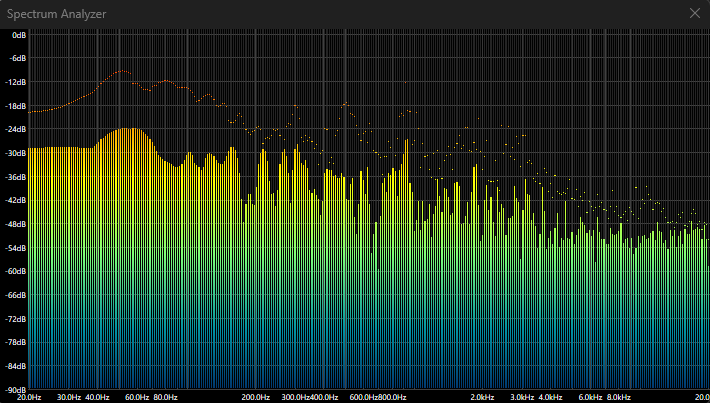

One screenshot is running ./ffmpeg -i '.\Katy Perry - Teenage Dream - 04 - Firework.flac' -c:v copy -c:a libfdk_aac -vbr 4 KP-regular-vbr-4.m4a and the other is running ./ffmpeg -i '.\Katy Perry - Teenage Dream - 04 - Firework.flac' -c:v copy -c:a libfdk_aac -vbr 4 -cutoff 20000 KP-20k-vbr-4.m4a. In the screenshots, you can clearly see one has much lower levels above about 17KHz and that is the first command. The other has normal sound levels above 17KHz and that is with -cutoff 20000. I'll try and test these audio files with Voukoder and see if the cutoff applies or if it's a weird FFmpeg thing. I will get back to you in a second comment when I check.
Voukoder has the same cutoff applied by default. This could be useful: https://trac.ffmpeg.org/wiki/Encode/AAC#fdk_aac
So it's not just FFmpeg, it's the FDK AAC encoder.
Chapter 3.1 which is on page 23 of the FDK AAC docs explains something about the bandwidth and the API for it: https://github.com/mstorsjo/fdk-a…/aacEncoder.pdf
