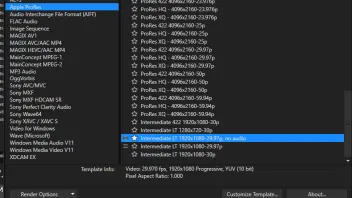

    I got my 14-day trial license, ran Voukoder Pro and installed the license. Saved a scene. Ran Vegas Pro, but there is no Voukoder in the list of options:

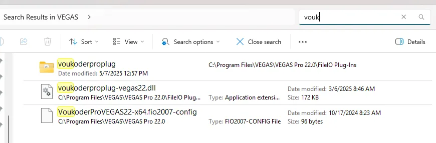

    Looking at "C:\Program Files\VEGAS\VEGAS Pro 22.0" I see the file "VoukoderProVEGAS22-x64.fio2007-config" so I assume that means that the "connector" was installed properly.

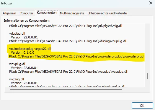

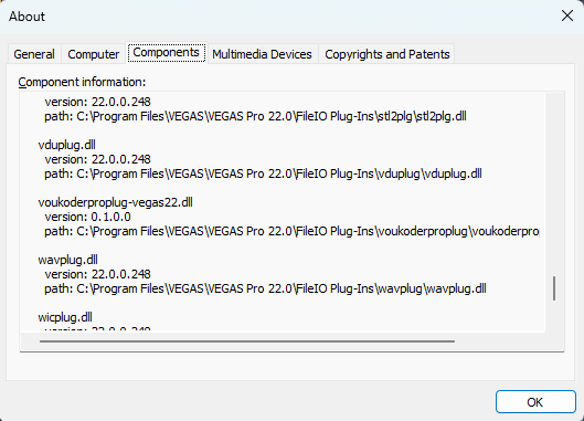

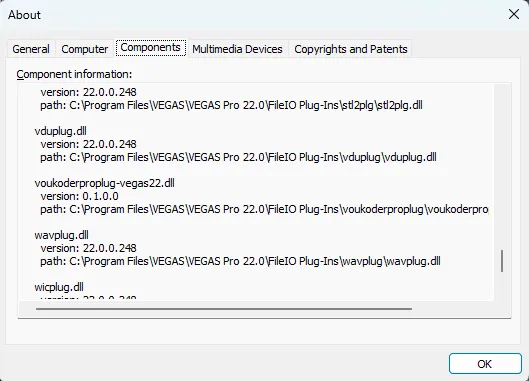

    In VEGAS Pro go the Help > About and click on the Components tab. Does Voukoder Pro appear here?
  • Yes. The plugin is in the list:
    Also, there's no evidence that Voukoder was installed on any of my previous versions of Vegas. So, like I said, I'm pretty sure this is the first time I've tried any Voukoder product, pro or non-pro.
    And the installer I used was: VoukoderPro-2.0.10.msi

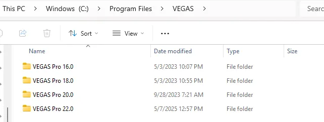

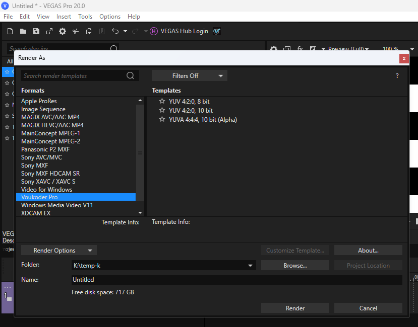

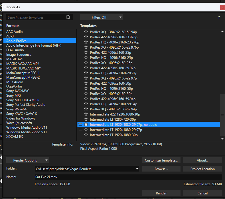

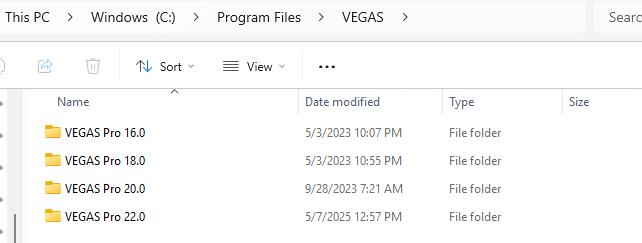

  • In addition to Vegas Pro v22, I also have v20 installed on my PC. I uninstalled Voukuder and reinstalled it for Vegas Pro v20, and it worked:

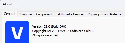

    I was able to successfully render a *.mov file. So, it looks like this issue is specific to Vegas Pro v22. FYI, I am running the most current release of Vegas:
