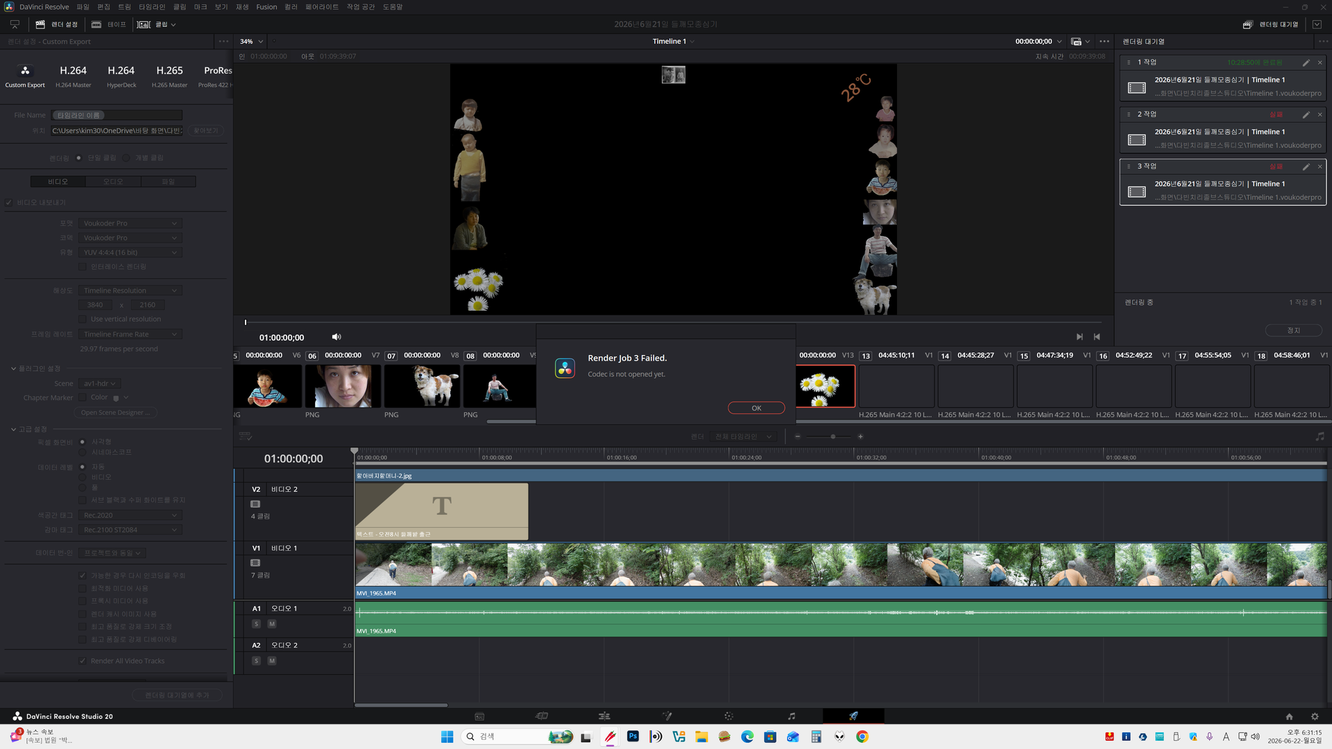

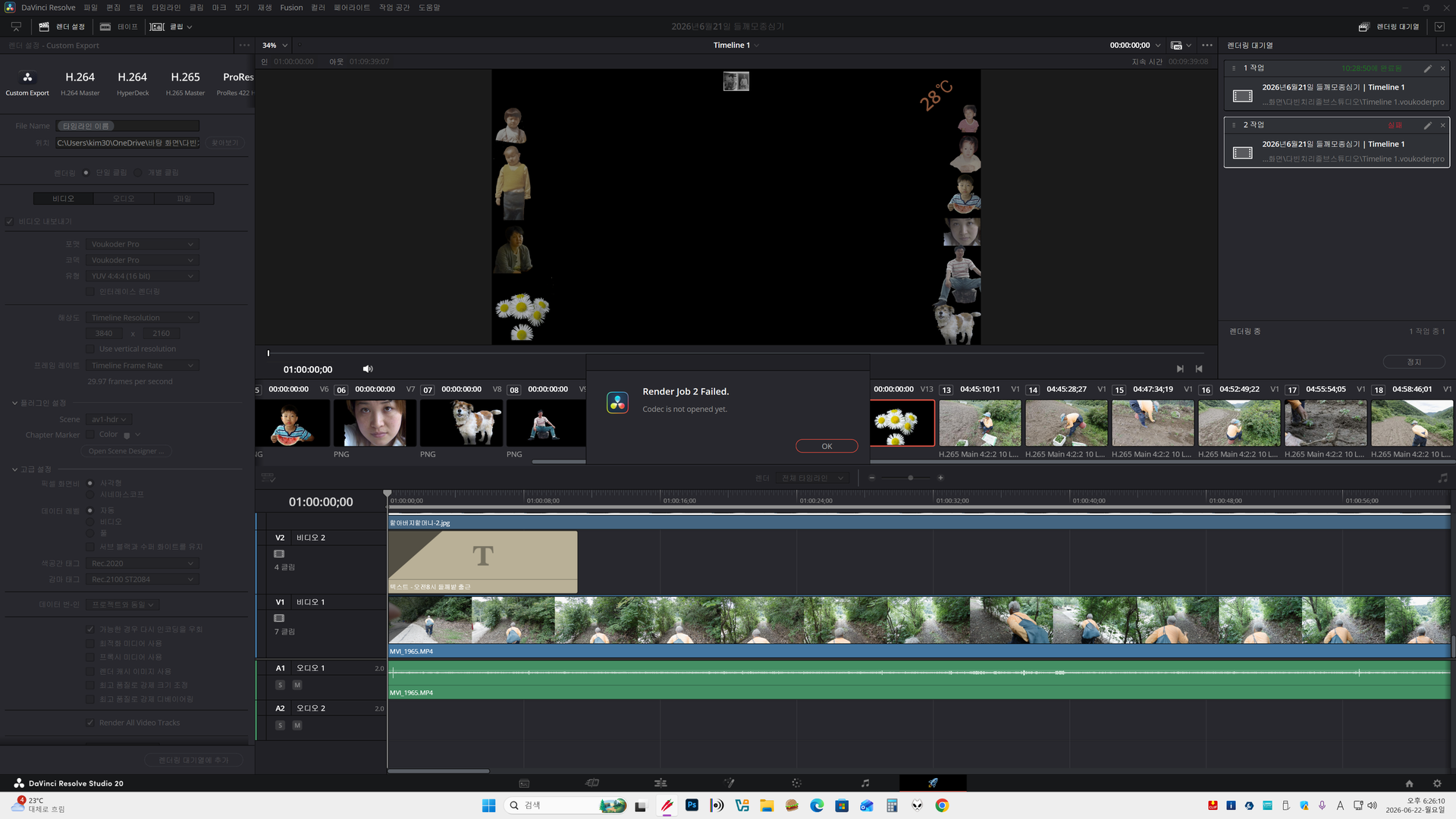

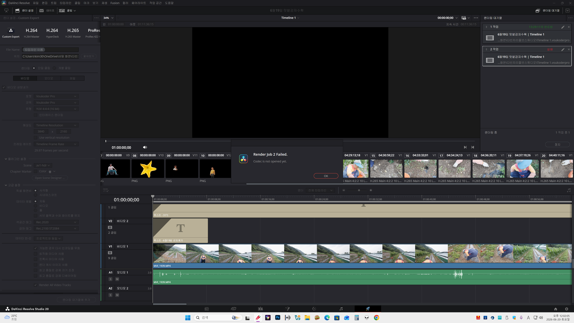

When I tried to encode in DaVinci 20 using the latest VoukoderPro 2026 3.1.4, it threw an error and failed to encode. So, I switched back to VoukoderPro-2026.0.18 and ran the encoding again
Error occurs when incoating voukoderpro2026 3.1.4 in da Vinci20

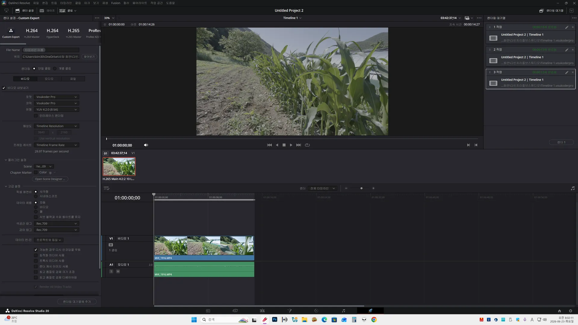

An error occurs when encoding with 'VoukoderPro-x86_64-2026.1.6' in DaVinci Resolve 20

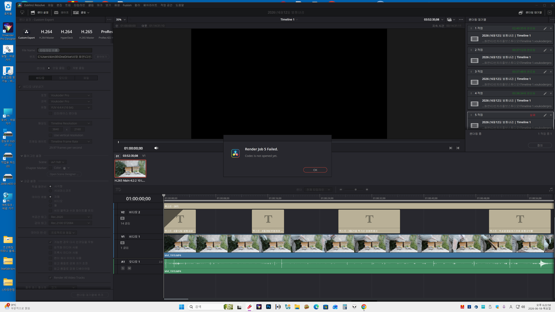

VoukoderPro-x86_64-2026.1.7 에서 error.
I found this in the DaVinci logfiles:
Code[0x00002158] | SyManager | ERROR | 2026-06-22 18:25:46,047 | There is no current clip, SetCurrentFrame failed. [0x00000330] | IO | INFO | 2026-06-22 18:25:51,220 | Plugin Info :: Voukoder Pro Plugin :: Unable to open Voukoder Pro (Error code #-11) [0x00000330] | Task | ERROR | 2026-06-22 18:25:51,220 | Error occured during recording of C:\Users\kim30\OneDrive\?????? ??????\??????????????????????????????\Timeline 1.voukoderpro : Codec is not opened yet. [0x00000ac4] | Task | ERROR | 2026-06-22 18:25:52,842 | Error occured during recording of C:\Users\kim30\OneDrive\?????? ??????\??????????????????????????????\Timeline 1.voukoderpro : Unknown error. -

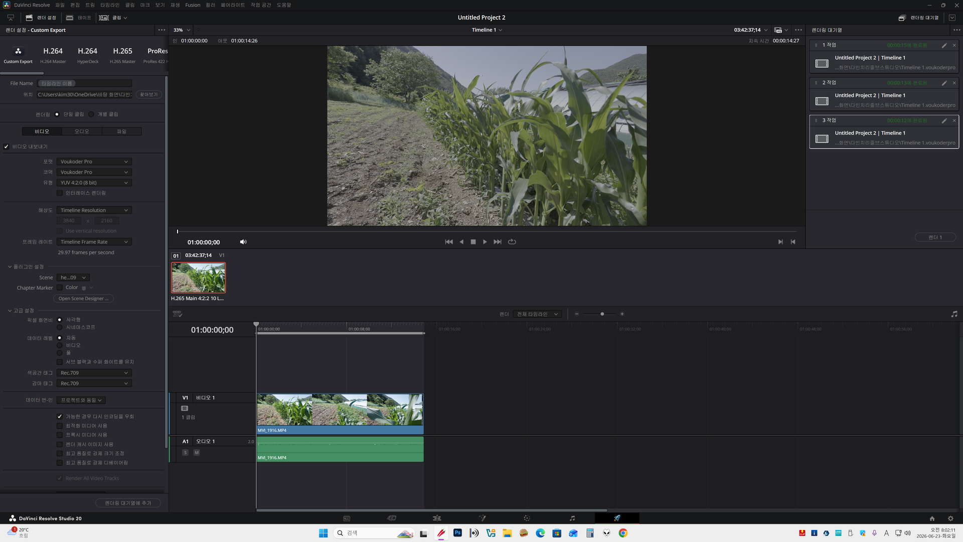

전에는 인코딩출력을 바탕화면에 했었지만 지금은 d:\드라이브에합니다.

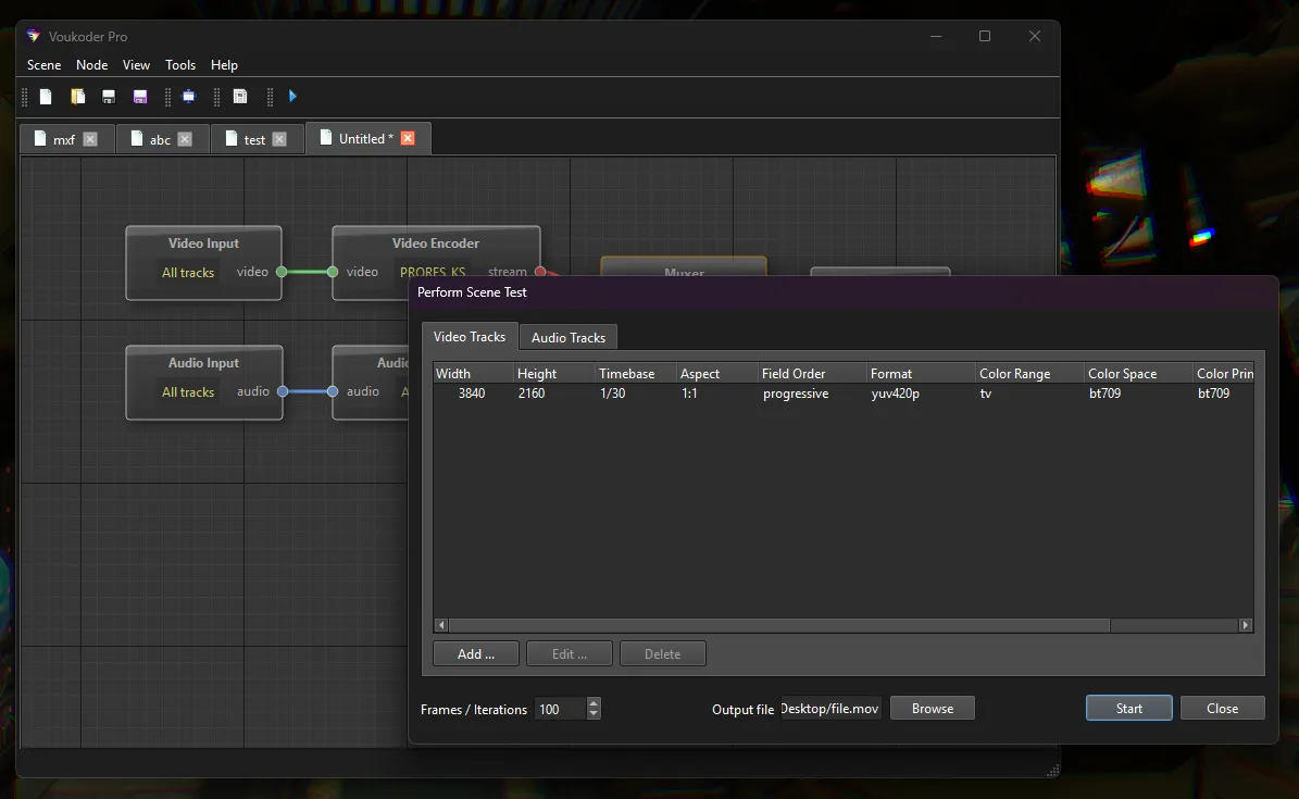

I'd try to export data exactly as in the scene log!
