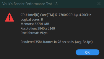

    I did tests with a 1-minute sequence (3840x2160 60p, cineform codec source; no fx or anything).
    With 2.2.0 (and 2.2.3) it exported in around 2:30 (basically 2.5:1 time ratio)
    Then I ran VRPT , and it completed with about 1.6:1 ratio:
    Finally, I've tried 1.1.3 and it finished in 51 seconds (0.85:1).
    I re-ran this several times, and even with different compression/profile settings, these numbers remained pretty much the same.
    My specs are i7-7700k@stock, 32gb ram, 1080Ti, win10. Source/export on fast disk (no bottlenecks).
