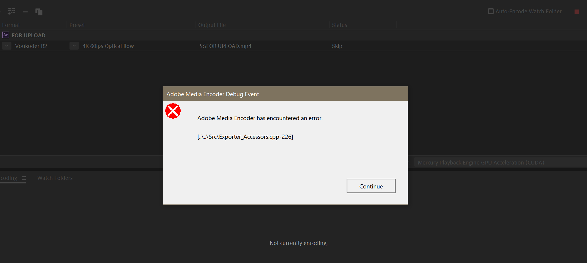

I reverted to the older versions but the error ocurred again. Already cleared the library cache but it didnt fix it. Reinstalling AME also didnt help.
Version 1.1.2 seems to work now.
