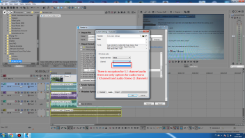

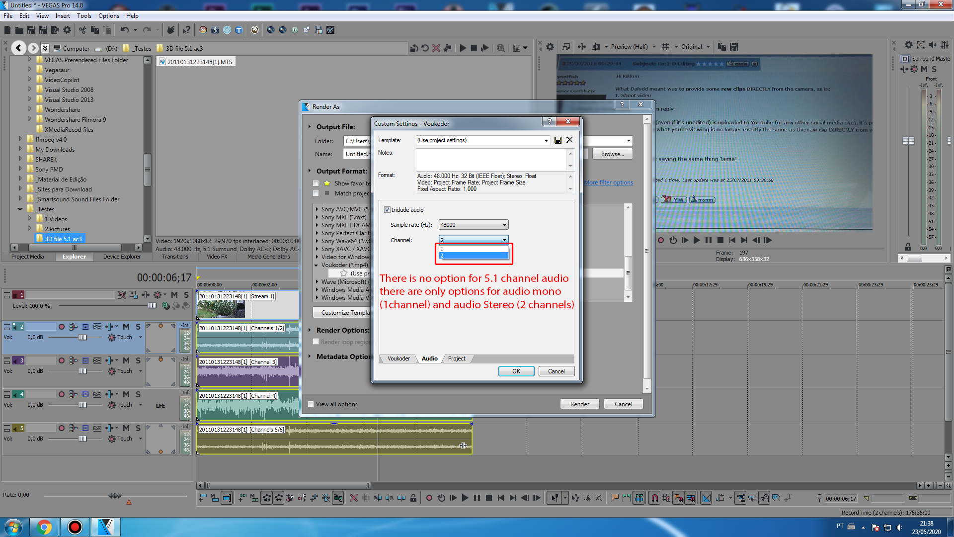

  • In the audio configuration page there is no option for 5.1 channel audio.
    I tried to do a test with 5.1 audio, but only the options 1 channel and 2 channels appears, even though the Vegas project properties are set to 5.1 channels and the Voukoder template is set to (Use Project Settings).
    Apparently it is only possible to render mono and stereo audio in this version of Voukoder in Vegas Pro.
    In previous versions of voukoder there was no "audio configuration page", but it was possible to render 5.1 audio just by setting the project properties of Vegas to 5.1 in audio section , and voukoder automatically applied the project properties to the rendered video.
  • Due to this problem I had to revert to Voukoder 3.0 with vegas-connector-0.5.1 because in this version Voukoder will use the Project Properties to do the Render. Just set the Project Properties in Vegas to 5.1 audio and the Voukoder rendering will take place correctly.

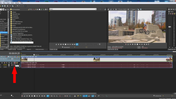

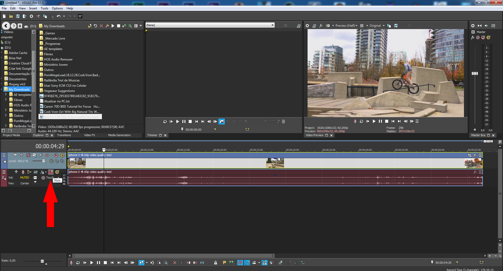

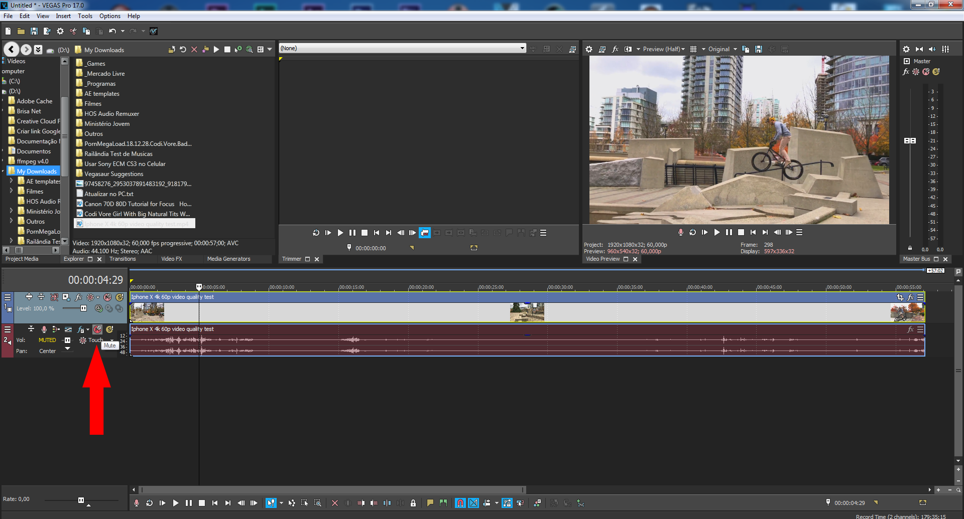

  • Until MAGIX updates the SDK of Vegas to allow for More than Two Audio Channels, I don't see a problem using the project settings again. When the user wants to disable the audio, just use the MUTE option on the project's audio tracks before rendering.
  • I wanted the feature to render without audio. I was using this for testing only.
    If I need to choose what to have at the end -- 5.1 or ability to render video only, I'd choose 5.1 for sure.

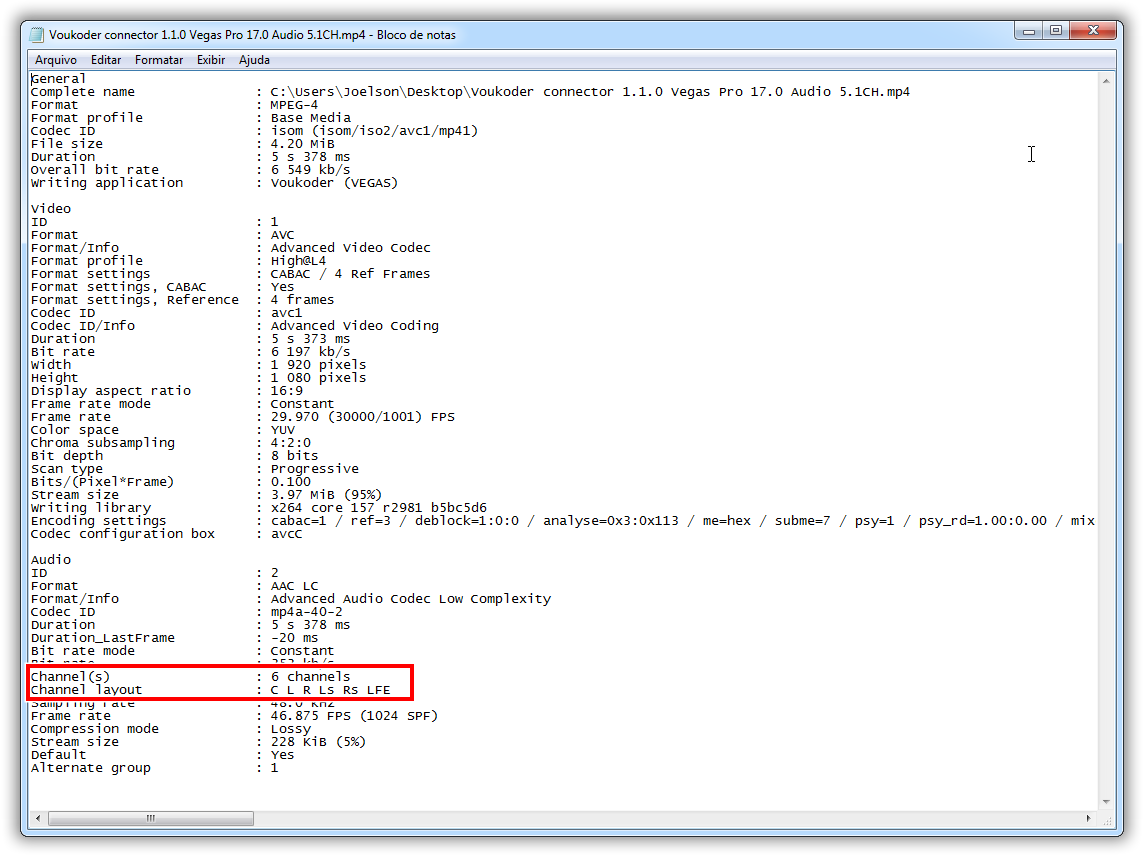

  • I successfully tested on Vegas pro 14.0 the Voukoder Connector 1.1.0 for the older VEGAS versions (12-17).
    Rendering occurs correctly on videos that have audio with 2 channels Stereo and also on videos that have audio with 5.1 channels Surround.
    The problem of audio 5.1 as fixed.

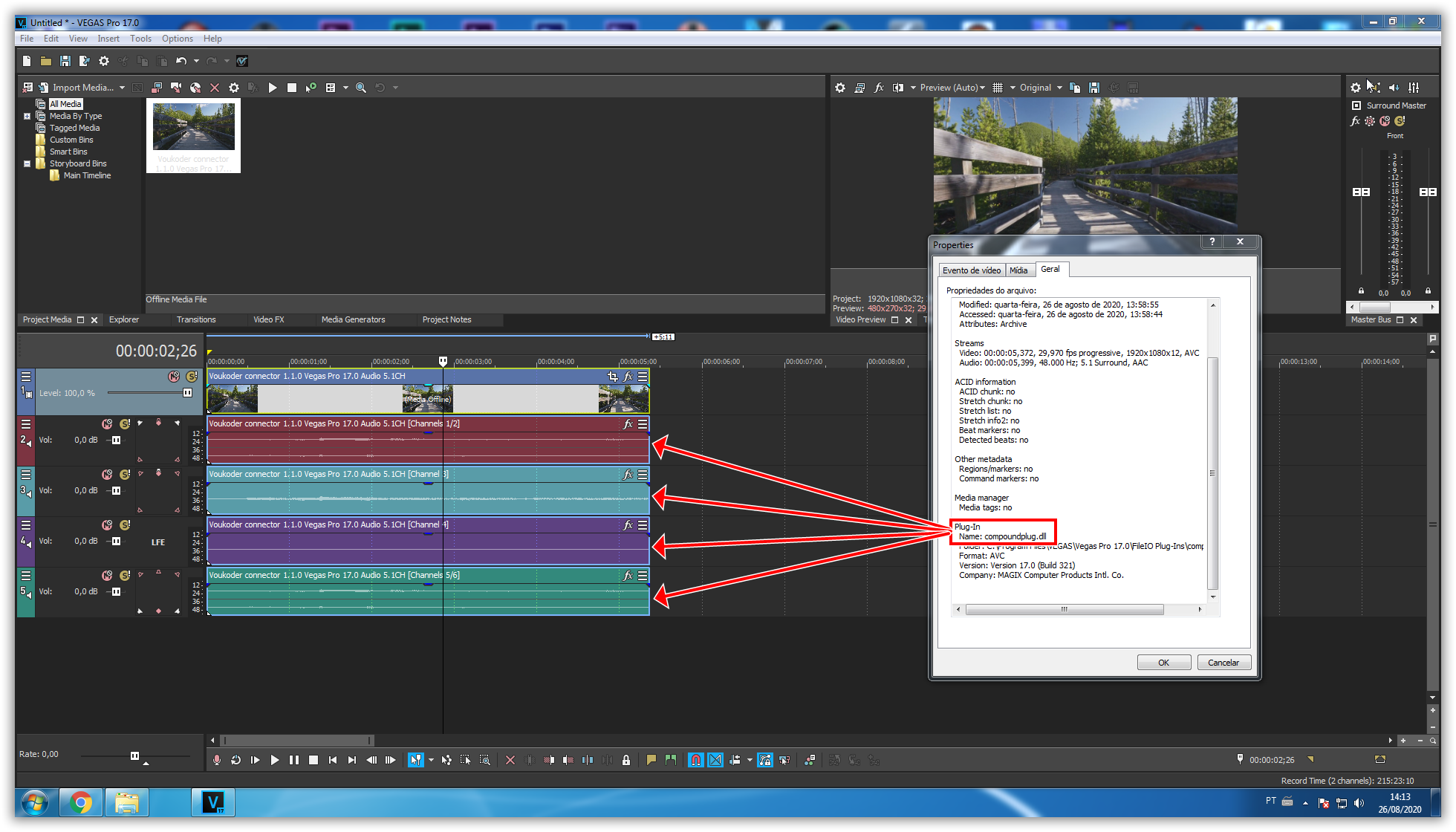

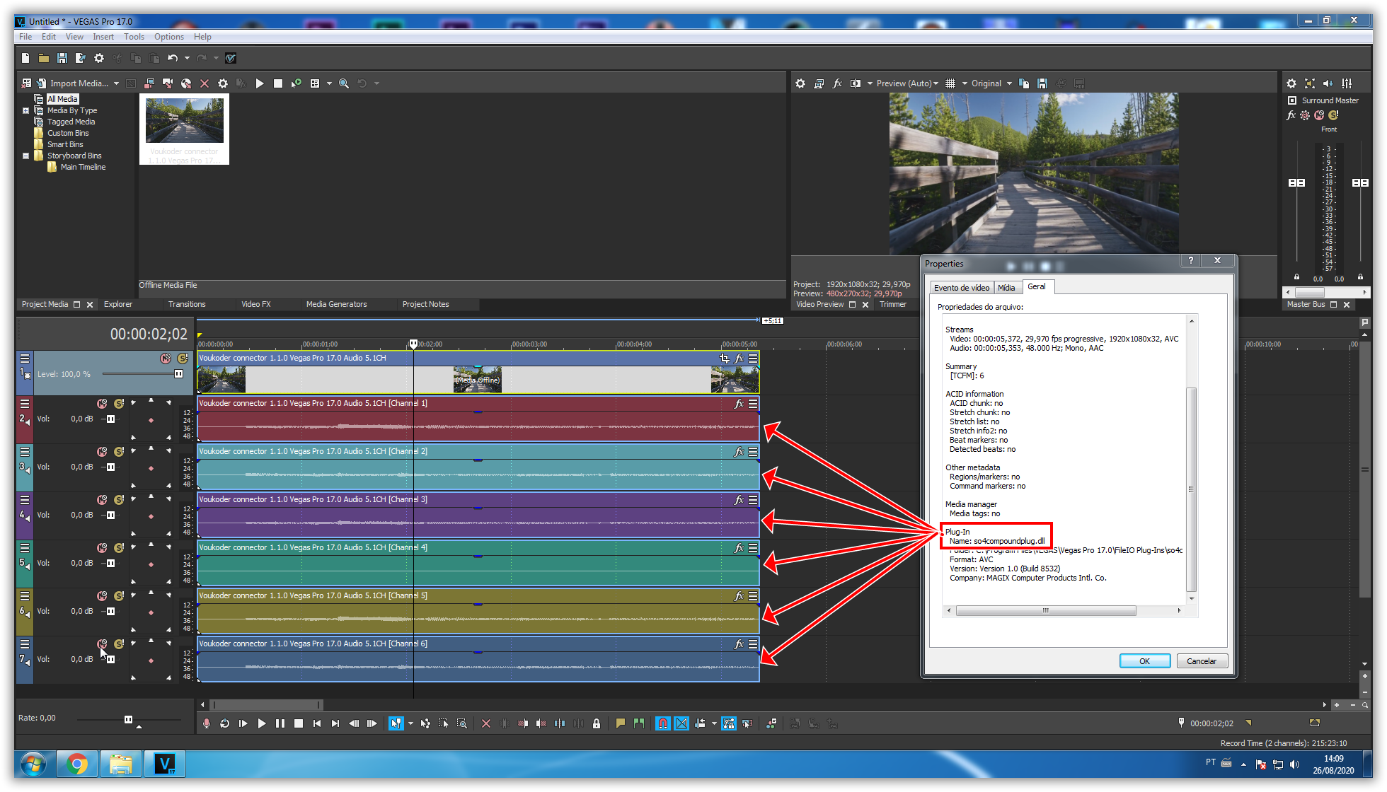

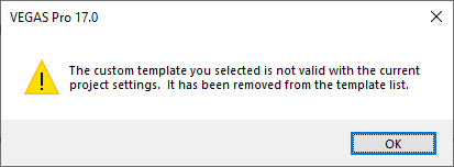

  • I just tested Connector 1.1.0 on Vegas Pro 17.0. The audio of the 5.1 surround project is encoded as 2-channel stereo, all 6 channels are mixed in the stereo channel. MediaInfo reports "Channel(s): 2 channels" but also does report another line with "Channel(s)_Original: 6 channels" and the next line "Channel positions: Front: L C R, Side: L R,LFE". So there is still hope ...
  • Interestingly, when I place the rendered clip back on the timeline of Vegas Pro, I do get 6 audio tracks under the video track, playing the 6 distinct surround channels. There seems to occur some mixing somewhere.
