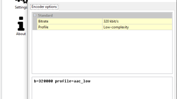

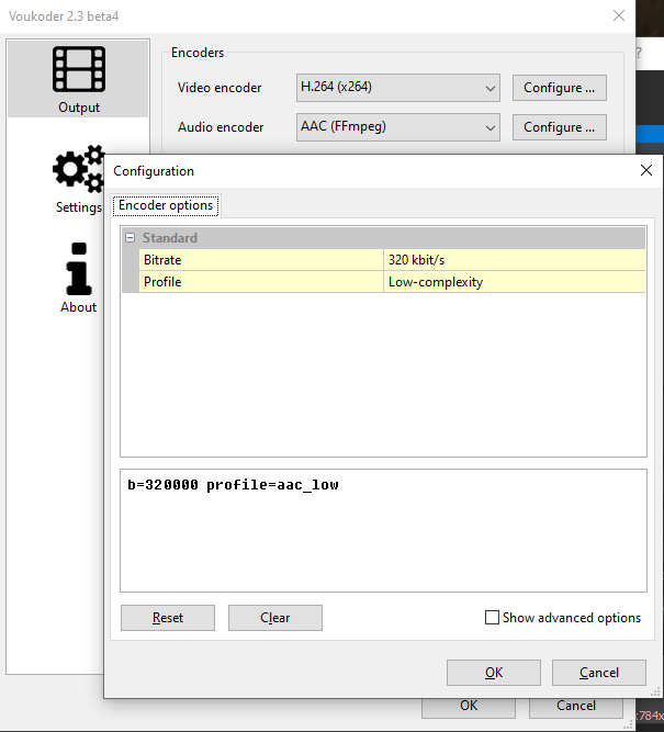

  • So when I export like this ...
    .. I get:
    which should be okay, right?

  • Interesting... so it is doing VBR.
    Format : AAC LC
    Format/Info : Advanced Audio Codec Low Complexity
    Codec ID : mp4a-40-2
    Duration : 11 min 50 s
    Bit rate mode : Variable
    Bit rate : 233 kb/s
    Maximum bit rate : 320 kb/s
    Channel(s) : 2 channels
    Channel layout : L R
    Sampling rate : 48.0 kHz
    Frame rate : 46.875 FPS (1024 SPF)
    Compression mode : Lossy
    Stream size : 19.7 MiB (1%)
    Default : Yes
    Alternate group : 1
    I thought I could add custom parameters into the encoder dialog but I guess not. Is there somewhere else I can look to force it to do CBR?

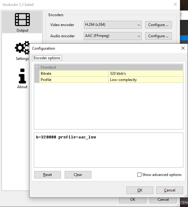

  • Here's the log file:
    And it still did audio in VBR:
    Any ideas?
