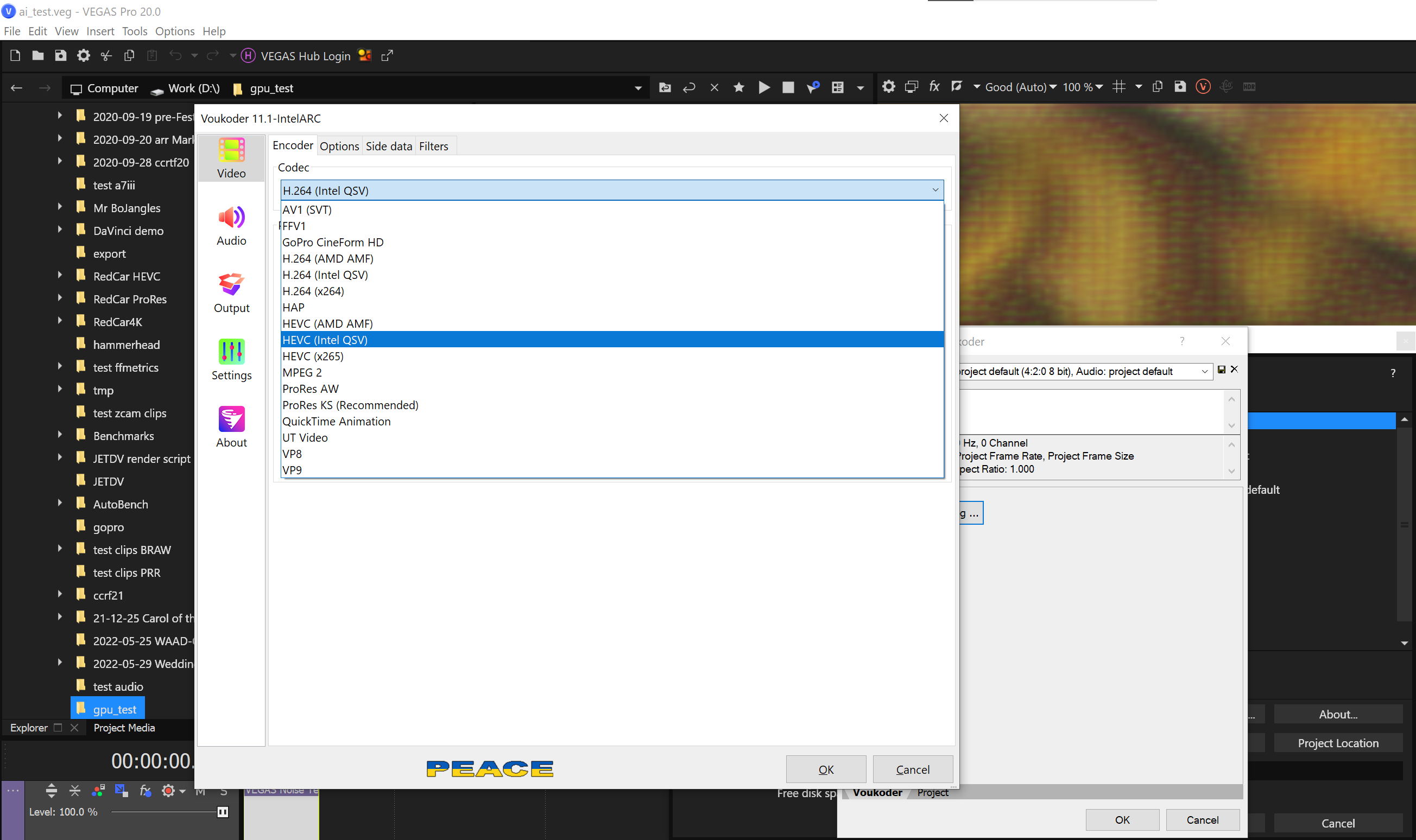

    Just tried Voukoder 11.1-IntelARC with an Intel Arc a380 board and was able to do hardware renders for AV1(Intel QSV) in both Vegas 20 and Resolve18 Studio. But not with 11.3.2. Curious what ffmpeg is used for 11.1... I cannot find an ffmpeg with "av1_qsv" as an encoder... only as a decoder in 5.1-full.

    The changes required for av1_qsv are not part of the latest stable FFmpeg 5.1 release yet. It is currently custom built from an unstable version where issues have been experienced already. Once FFmpeg supports it in a stable release (maybe 5.2?) it will be fully supported in the normal voukoder release.

    Thanks. Also, for some reason not seeing h264_qsv or hevc_qsv encoders on my systems with uhd630 or uhd750 igpus if I install 11.3.2. But they do show up if I install 11.1. Can also encode with them in Win releases of ffmpeg 5.1 from gyan and btbn.

    I don't know about this. The IntelArc release (and also all future later versions of Voukoder) is using Intels new OneVPL framework instead of MFX. I'm not sure if the supported chipsets change with this switch.

    Here's the Voukoder dialog/codecs I get on a 9900k/uhd630/Radeon7 system with Voukoder 11.1 running Vegas 20:
    The Intel Qsv stuff goes away if I update to 11.3.2. Same deal on my 11900k/Arc380/6900xt system except I see more qsv with 11.1... adds qsv av1 and qsv vp9. But only if I point windows to Intel in display/graphics entries for the host app... set either to power saving (win10) or specific gpu (latest win11). When I run ffmpeg 5.1 itself, it is only influenced by the windows setting for decoding, not encoding. It just doesn't have av1_qsv and vp9_qsv but it's got the other 2 encoders no matter what the windows setting is.
