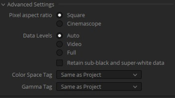

  • just strange DVR is using the 0-255 range as default (auto). AFAIK 16-235 is standard.
    Actually 0-255 is very important . Formats like DCPs, prores 444, Image sequences, IMF master files are full range. Years ago, Resolve was more focused on only rendering master files.
    Grading is done in full range. Resolve takes the limited range and expands it to full with YUV files. RAW files are RGB and is full range. Keeps everything consistent when grading. Also grading monitors are almost always in full range.
    As you noticed, Resolve only goes to 16-235 for non-RGB deliverables like prores hq and h264.

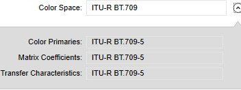

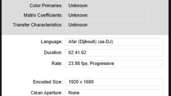

  • Just an update. I downloaded version 0.3, and I still get unknown colorspace.
    When I render an uncompressed MOV from Resolve, and render a prores out of Premiere, it shows ITU-R BT.709
    Connector: 0.3.0
    Resolve: 17.1.1
    Yes, Both variants are support. I just want to avoid DVR is using full range as default but is using limited range instead. Of course the user can switch this to full range if needed.
