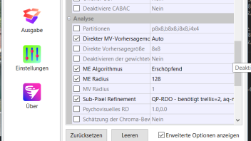

    Sorry, that might be an idiotic question, but how can I configure the preset you give us in Voukoder (for me Premiere Pro)? I can just select the 3 given presets for x264.

    Quote from CptDayDreamer
    Thats fine for me, its in the options page menu above the presets. The downside is you have to input every setting manually in every video project for current version (mouse select), I think the later updates than this comment would just add more presets, but you probably still have to do the calculation, and especially HDR info related parameters manually:)

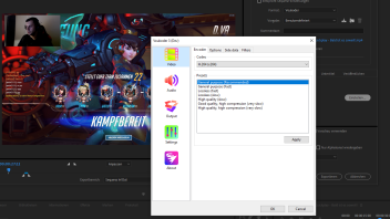

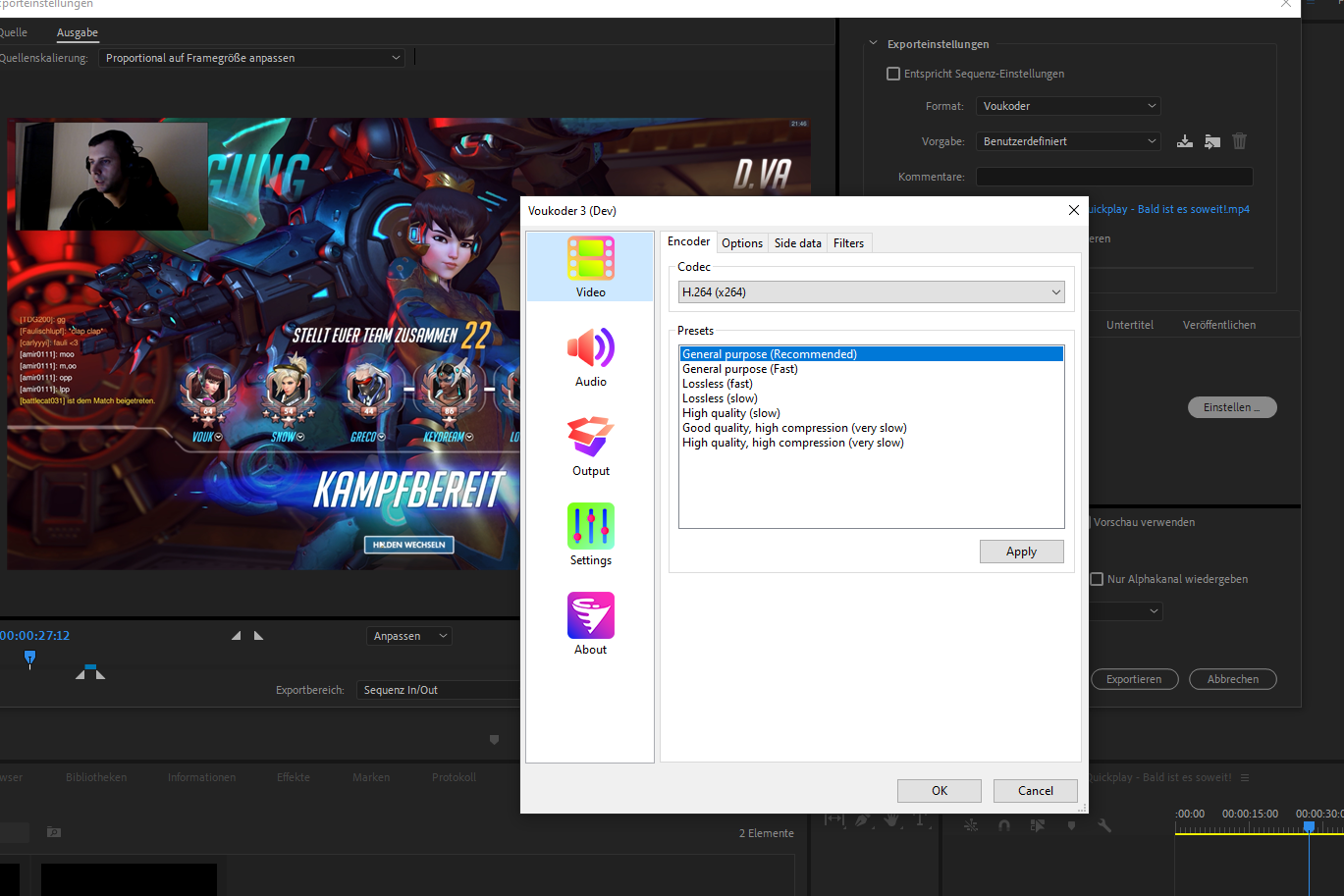

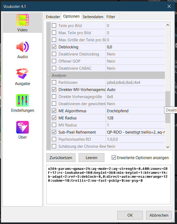

    iAvoe I've also downloaded 5RC2 now to test your presets. High Quality, High Compression would run like 24 hrs for a 30min video? Is that normal? I'm on Ryzen 3700X and GTX 1070.
    And the more interesting thing is that the high quality preset always fails. The lossless (fast) preset as well. Adobe Media Encoder logs this:
    Adobe Premiere
    Es war nicht möglich den Encoder zu initialisieren.
    Dieser Fehler tritt meinstens bei einer ungültigen Parameterkonfiguration auf.
    Which means that this parameterconfig isn't valid.
    Did you tried this one Vouk ?
    HQ HC only really seems viable for short clips on my 9900k@5GHz, anything too long absolutely explodes the encoding times.
    Noticed the issue of some presets straight up not working myself also, something worth looking into maybe.

    • Official Post
    • #18
    Okay, found it and fixed the issue.
    btw: I configured the presets for around 60 fps output without any post processing (rescaling, etc)
    Adobe Premiere
    Display More
    Yep, it is, this setting has maxed high cost parameters. However there are even slower modes that are less effective. I uses this only for ~5min videos though
    I'm not sure why it's not working though
