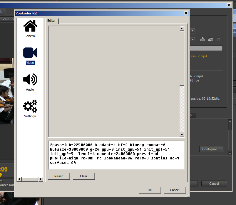

  • No idea what I have to clear but just upgrade from 1.x to 2.0.5. First time calling plugin works fine, created profile and encoded video. 2nd time in, it crashes after I go into configure parms and go to video tab.
    Restarted PPro (cs6), enter plugin, bring up Configure, go to video tab. All good. Cancel out of configure. NOW go again to enter configure, go to video and boom, it get hung. Attached is screen grab.

  • Even simpler. With CC 2015 I don't have any profiles saved. Enter plugin (everything default at x264). Click configure, click video (everything default) click OK. Click configure, click video, BOOM. It does sometimes take 2-4 times but it will crash.
  • Windows 7, 2015, GTX 950. Fails with x264 and NVENC. Seems way too basic a failure. 1.x plugin works fine, have it commented out (changed file type from prm -> prmx) when testing 2.x.

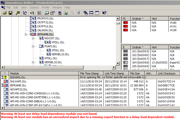

  • I don't known if it could help,
    Here dependences about Voukouder R2 on my PC :
    IESHIMS.DLL is missing and problems with SHLWAPI.DLL and IEFRAME.DLL
    Do you think that may have something to do with this problem?
    Edited once, last by MyPOV ().
  • These dlls are from Internet Explorer but I don't know if this has something to do with the crash. Maybe you can try to enable/disable Internet Explorer in Windows 7 and testing again.
