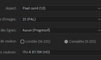

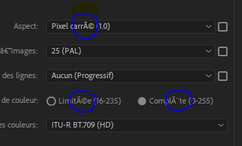

    I noticed a display bug with the last two releases (1.0.3 and 1.1.0) of the connector for Premiere. It does not cause a problem of operation but of display and it does not directly concern Voukoder but the export window. Special characters in French are not interpreted correctly as if it's not the correct character coding table.
    This problem does not exist with the 1.0.2 and earlier of the connector.
    Ok :
    Wrong :
    I got trapped again after switching from Windows 7 Family to the Pro version to manage 32GB of Ram... And it tooks me a little while to find again this discussion.
    May be it should be mentioned prominently (FAQ and elsewhere ?) so that people who test Voukoder for the first time do not come across this problem and immediately abandon Voukoder.
