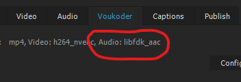

Any guess on when a 13.x will be available with working audio sync AND libfdk? I just went through 2 hrs of hell with Vouk low level crash debugging before realizing my preset was specifying fdk vs default ffmpeg aac. All my presets are like this.
