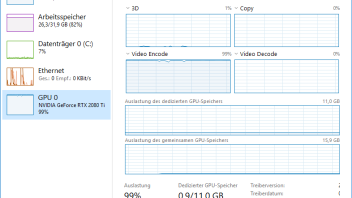

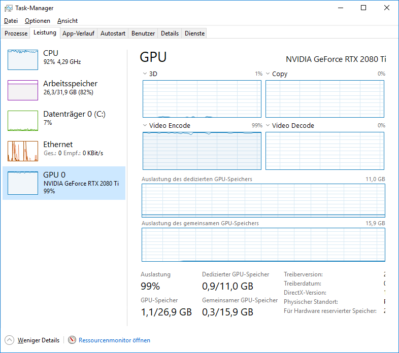

    Hello,
    i don't know if this is a bug or because this version is free but Vokouder r2 beta3 is extremely slow compared to previous beta1 and beta2.
    previous version can export a 6 minute video timeline with grading and PP in under 1.30 minutes.
    settings used in both Vokouder r2 b2 and b3
    with vokouder r2.0 beta3 the same video with the exact same settings require about 8 minute to export and the gpu utilization is 20% compared to 95/98% from the beta2.
    g=15 gpu=0 preset=slow profile=high qp=1 rc=constqp
    mp3 320 mkv
    Premiere pro v 13.1.3
    rtx 2080ti 419.67
    AMD Threadripper 2990wx
    128GB DR4 3600
    Windows 10 ( without april update ).

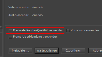

    Voukoder ignored the "Render with maximum bit depth" option before beta3. If activated now it uses a very expensive render path. If you uncheck it you should have the old speed again.

    Quote from Vouk
    I wont see this as an option in beta3.

    • April 4, 2019 at 9:47 PM
    • Official Post
    • #4

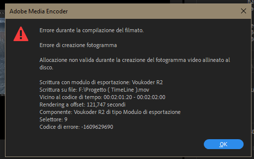

    thank you very much..now is lightning fast but give me this error :(...
    it's italian . hope you can understand what this error says.
    the export disk is a nvme m.2 ssd mp500.
    Thank you so much for this tool :).

    Sorry, i can not speak italian. But you can press ctrl-c in this windows and copy the text and maybe translate it with deepl.com.
    Please open voukoder again and copy the logfile to this forum.

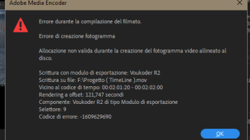

    • April 4, 2019 at 11:58 PM
    • #8
    Quote from Vouk

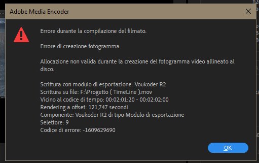

    Ok, Mr Vouk.
    Error
    Errore durante la compilazione del filmato.
    Errore di esportazione
    Il modulo di esportazione ha restituito un risultato non valido.
    Scrittura con modulo di esportazione: Voukoder R2
    Scrittura su file: C:\Progetto ( TimeLine ).mkv
    Vicino al codice di tempo: 00:01:45:08 - 00:01:45:14
    Componente: Voukoder R2 di tipo Modulo di esportazione
    Selettore: 9
    Codice di errore: -2147483648
    here is the log from Vokouder preference tab

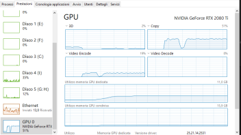

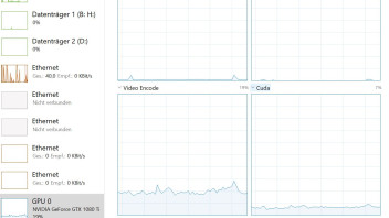

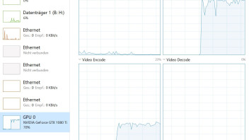

    • April 12, 2019 at 5:10 PM
    • #12

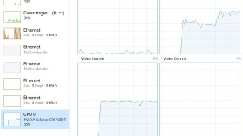

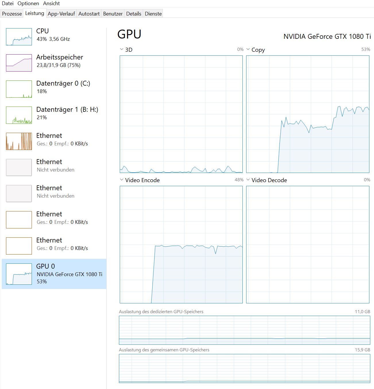

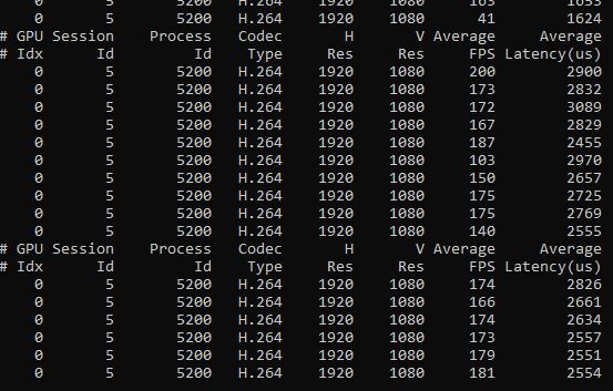

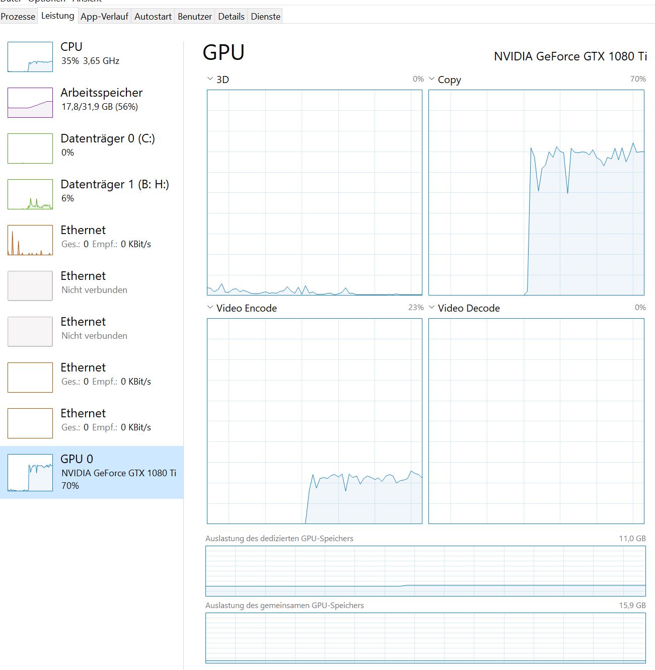

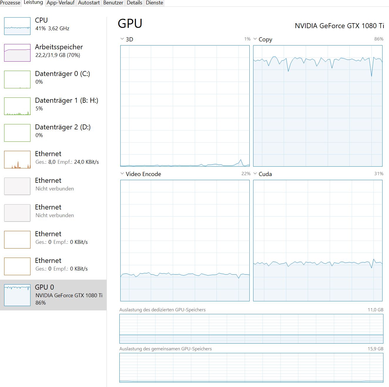

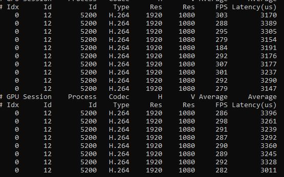

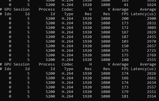

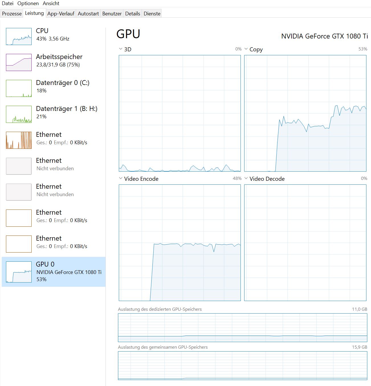

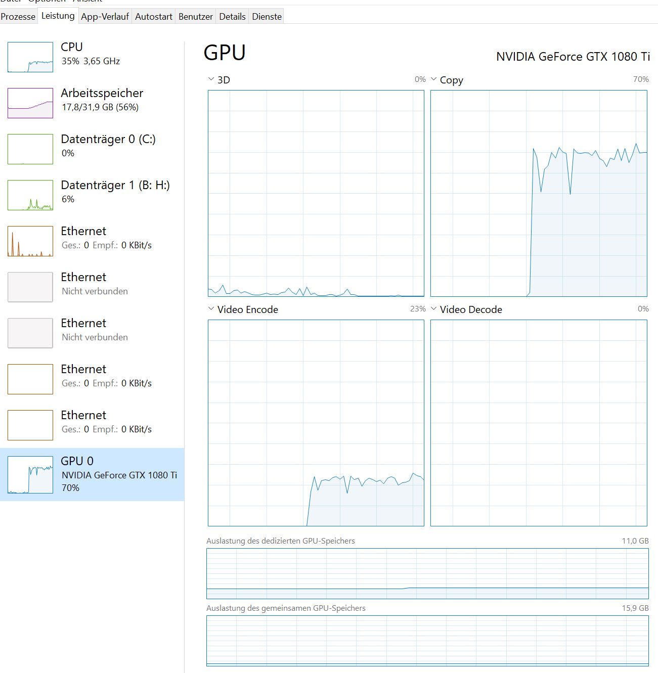

    I have tested the speed differences between Voukoder 1.2.0 and Voukoder R2 (beta3 and beta4). And I can say that Voukoder R2 is very slow compared to Voukoder 1.2.0 with nvenc. I exported a 50 min video with the same nvenc settings in Voukoder 1.2.0 and Voukoder R2. In version 1.2.0 it takes about 5 minutes, in Voukoder R2 (beta3 and beta4) it takes about 9 minutes. I attached two screenshots from the taskmanager which shows that version 1.2.0 uses more Video engine power I think.
    Images
      • 186.78 kB
      • 1,302×1,354
      • 340
      • 181.22 kB
      • 1,301×1,331
      • 343

    • April 12, 2019 at 5:24 PM
    • Official Post
    • #13
    Make sure you use the same settings in both cases. Don't compare the settings in the gui, but the settings in the logfile.

    1.2.0 settings = h264_nvenc with options: b=2000000,bf=2,maxrate=3000000,preset=slow,profile=high,rc=vbr,refs=3
    R2 settings = vcodec: h264_nvenc, voptions: _computeCapability=6.1,_pixelFormat=yuv420p,b=2000000,gpu=0,maxrate=3000000,preset=slow,profile=high,rc=vbr, acodec: libfdk_aac, aoptions: _sampleFormat=s16,profile=aac_low,vbr=3, format: mp4, faststart: 0

    I compared the two files from version 1.2.0 and r2 and I can say that the quality of version r2 is a little bit better in rainy scenes than 1.2.0 but really hard to see . So there has to be some difference in the settings but for this loss of speed?
    There is also a wrong default value in voukoder r2 with nvenc h264 I noticed. In the GUI ref frames have a default value of 3 but the exported video has 1 ref frame.

    I just compared the encoding speed of version 1 and 2. And it is pretty much identical.
    Maybe you are comparing a release build and a debug build? Debug is always slower because performance optimizations are disabled there.

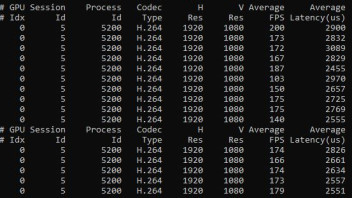

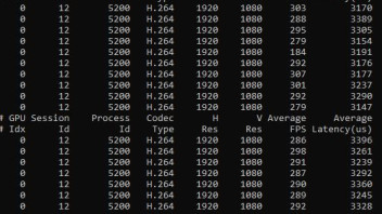

    • April 13, 2019 at 12:05 PM
    • #19
    The R2 logfile looks also pretty strange. I think the log is not complete and missing entries.

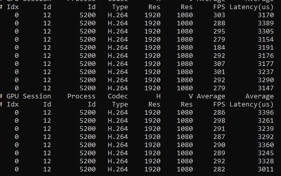

    Here is are my fps values with 1.2.0 and R2 beta4. Hugh difference. And I attached the R2 log.
    I am pretty sure that I am using the same video export settings but also by changing some parameters, R2 is every time much slower.
    Images
      • 54.36 kB
      • 553×353
      • 345
      • 60.53 kB
      • 555×347
      • 345
    Files

    • April 13, 2019 at 9:17 PM

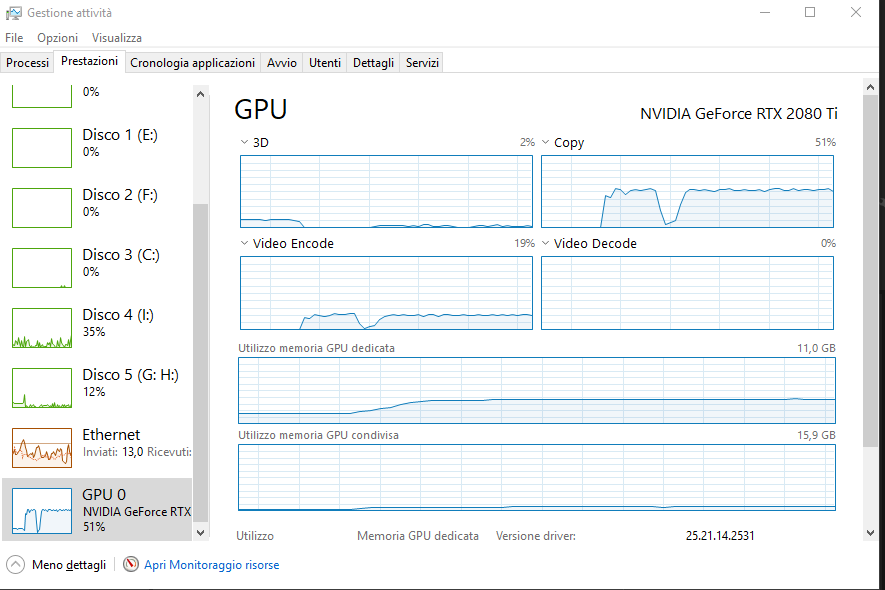

    • #20

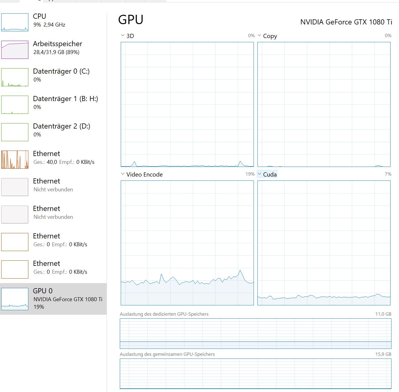

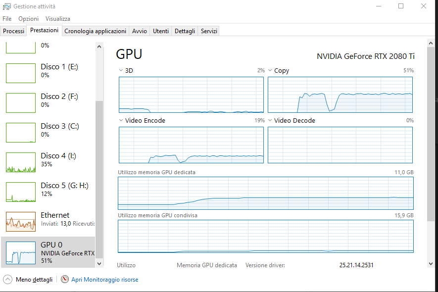

    Hi All,
    Hi Mr. Vouk,
    i've tested the new r2 b4 and i'm soo sorry for the following
    the plugin seems to extremely slow "even wothout high quality checked". Seems to have capped at 20% and seems that ignores every settings combinations :(.
    In task manager i see about 20% of Hardware encode utillizatin. the export works well but the benefit of GPU hardware accelerations completely disappear.
    i have the latest premiere pro "adobe cloud subscription" and a 2080 ti with 425.31 "gaming" drivers.
    Hope i'm wrong but i think that Nvidia is the responsable for this...
    if i can help you . please tell me how.
    ( the export was cancelled by me :) ).
    voukoder.org/attachment/325/
    Images
      • 44.1 kB
      • 885×590
      • 350
    Files
    vokouderr2_b4.txt 677.49 kB – 258 Downloads
