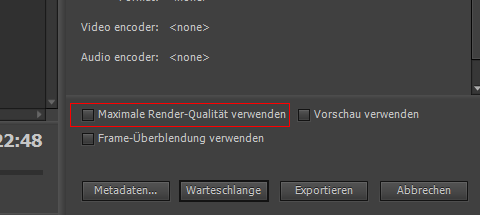

Render with maximum bit depth
I wont see this as an option in beta3.

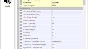

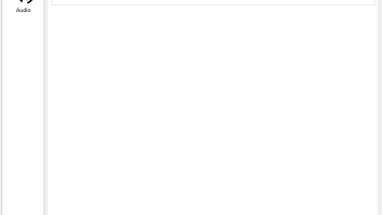

I dont see NVENC so I haven't tested if same happens there, but I can say that this happens with x264 AFTER render is completed and you go back to configure settings.
Still present in beta2. With my testing I only had it with quicktime (.mov) and Uncompressed PCM (16 Bit) combination.
Still happening after render completed and reopening configure menu, in beta2.
x264 strategy resets to crf when reopening voukoder config.

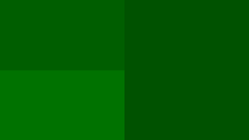

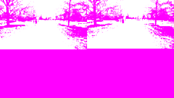

x264 with 4:2:2 10bit produces corrupted videos with wrong format specifications.
