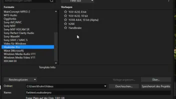

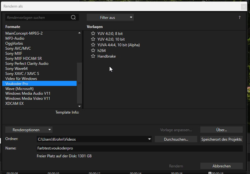

    I cannot get the right scene stored with a Voukoder Pro (2.0.14) render preset (see also screen recording attached):
    1. I select a predefined preset like "YUV 4:2:0, 8 bit"
    2. select the scene I want to use from the scene list
    3. rename "YUV 4:2:0, 8 bit" to something different and save the render preset
    4. when I reopen this preset, a different scene is selected for this preset
    5. when I correct the scene and save again, the scene does not change
    Is there something I''m doing wrong?

  • Hi,
    I tried the Vegas cache flush and complete settings reset but to no avail.
    What's interesting: The .SFT2 plugin-preset file itself seems to be written correctly. If I open it in a text editor, it shows the correct scene name, although the settings windows in Vegas/Voukoder gives the wrong name.
    Any further ideas? Thanks!
    Nils
    EDIT: Not only the .SFT2 file is written correcly, Voukoder also actually uses the right scene file for rendering. So, it looks like a dialog display issue.
    A workaround might me to integrate the scene name into the plugin preset name to be aware of which scene is in use.
