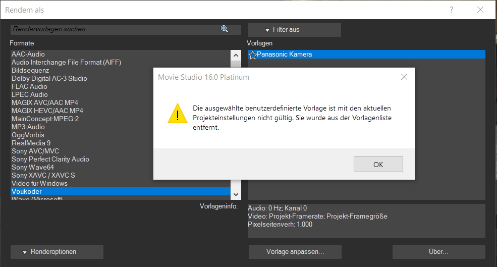

It obviously has something to do with audio:
Render with "include audio" activated in Voukoder:
Rendering does not start and a new preset is automatically deactivated by Movie Studio (...preset is not valid...)
Render with "include audio" DEactivated in Voukoder
Renderering works and a new preset can be stored
Any Ideas?
Thanks,
Nils
Also tried connector 0.6.1 with Voukoder 3 now, but it does not start to render either. Also no log file created.
Vegas Pro 15 does work in any case.
Anybody successfully running Voucoder under Movie Studio 16?
Thanks
Nils

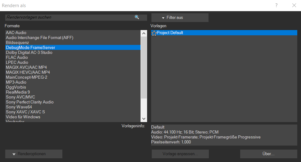

I noticed that for Movie Studio with connector 0.70 Voukoder only shows up in the list if there is a valid preset stored under "C:\Users\%username%\AppData\Roaming\VEGAS\Render Templates\voukoder\" already. No preset, no voukoder.
Nils
Hi,
when I select Voukoder for rendering (basic preset) and click render nothing happens (mouse pointer is the busy ring). Clicking on cancel stops the busy ring and closes the render window.
This happens on two different systems with Voukoder 4.1, one with connector 0.70 (Vegas Pro 15 is working well with Voukoder here), and one with connector 0.61 (Voukoder does not show up in the list with connector 0.70).
Any Ideas?
Thanks,
Nils
I had right the same problem today on one system with Movie Studio 16 P. With connector 0.70 no way, but 0.61 made voukoder visible in the render target list. It did not render though, but this seems to be a Movie Studio specific issue as Vegas Pro ist working.
Maybe you should give 0.61 a try?
Nils
