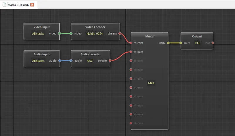

First capture is without LOUDNORM, works perfectly. Although weirdly, when batch rendering regions in Vegas, it's losing about 20% speed each regions as it progresses through them .... e.g. 80fps, then 64fps, then 50fps, then 35fps, then 20fps, etc until it slows to a crawl. There's no visible memory leak detectable in Task Manager for either CPU or GPU.

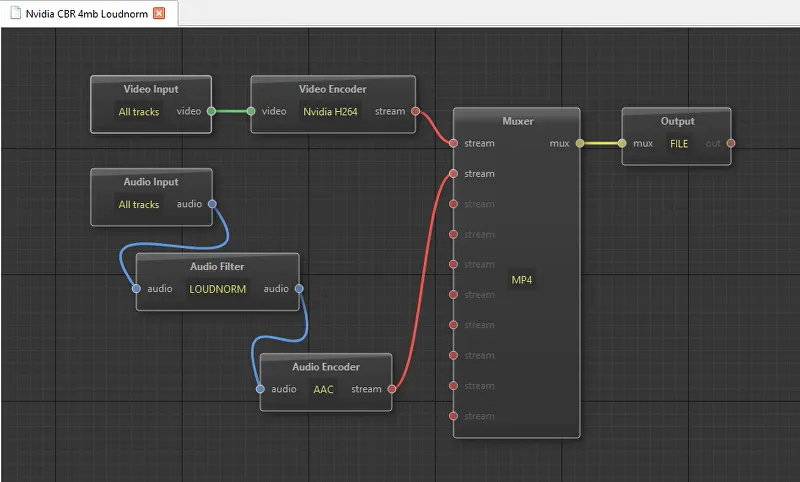

Second capture is with LOUDNORM, same profile, just inserted in between audio IN and render OUT. This immediately fails, and the rejected bitrate message is curious because the same bitrate works perfectly in the above profile without LOUDNESS. It also works as expected when used in ffmpeg from command line : -af loudnorm=I=-24:LRA=11:TP=-2

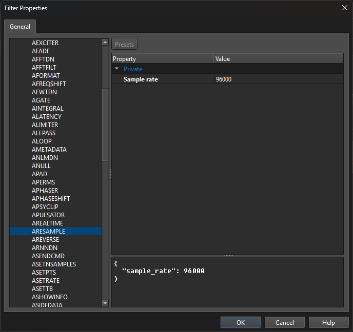

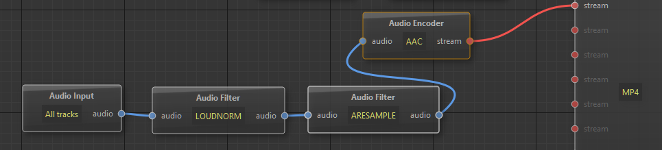

That does appear happier ... weird that it would have to be resampled like that. I presume the resample and the AAC rates both should match?
Alles anzeigen2026-01-15 14:42:28 (info) Validating license ... 2026-01-15 14:42:29 (info) License is valid! 2026-01-15 14:42:29 (info) Counting seat usage ... 2026-01-15 14:42:30 (info) Active seats: 1 / 1 seats 2026-01-15 14:42:30 (debug) License responder started ... 2026-01-15 14:42:30 (info) ### PHASE: PRE-INIT 2026-01-15 14:42:30 (debug) Filter config: buffer@a539ecc215e24336a5406809b8429260=width=1920:height=1080:pix_fmt=yuv420p:time_base=1/30:pixel_aspect=1/1,format=pix_fmts=yuv420p,buffersink@e11b009cad9b4b4bb0c45eff2a427f79 2026-01-15 14:42:30 (info) ### PHASE: INIT 2026-01-15 14:42:30 (debug) Dumping filter graphfor NLE Track #0: +-----------------------------------------+ | buffer@a539ecc215e24336a5406809b8429260 |default--[1920x1080 1:1 yuv420p]--Parsed_format_1:default | (buffer) | +-----------------------------------------+ +-----------------+ buffer@a539ecc215e24336a5406809b8429260:default--[1920x1080 1:1 yuv420p]--default| Parsed_format_1 |default--[1920x1080 1:1 yuv420p]--buffersink@e11b009cad9b4b4bb0c45eff2a427f79:default | (format) | +-----------------+ +---------------------------------------------+ Parsed_format_1:default--[1920x1080 1:1 yuv420p]--default| buffersink@e11b009cad9b4b4bb0c45eff2a427f79 | | (buffersink) | +---------------------------------------------+ 2026-01-15 14:42:30 (info) Initializing video encoder: h264_nvenc 2026-01-15 14:42:30 (info) Successfully initialized the output format. 2026-01-15 14:42:30 (info) ### PHASE: PRE-INIT 2026-01-15 14:42:30 (debug) Filter config: abuffer@491abb00bc9641cca9ebb07bf107b1b6=sample_rate=48000:sample_fmt=flt:channel_layout=stereo,loudnorm,aresample=sample_rate=96000,aformat=sample_fmts=fltp,abuffersink@79de9b8b101d486e9ae1f061592c6d22 2026-01-15 14:42:30 (info) ### PHASE: INIT 2026-01-15 14:42:30 (debug) Dumping filter graphfor NLE Track #1: +------------------------------------------+ | abuffer@491abb00bc9641cca9ebb07bf107b1b6 |default--[48000Hz flt:stereo]--auto_aresample_0:default | (abuffer) | +------------------------------------------+ +-------------------+ auto_aresample_0:default--[192000Hz dbl:stereo]--default| Parsed_loudnorm_1 |default--[192000Hz dbl:stereo]--Parsed_aresample_2:default | (loudnorm) | +-------------------+ +--------------------+ Parsed_loudnorm_1:default--[192000Hz dbl:stereo]--default| Parsed_aresample_2 |default--[96000Hz fltp:stereo]--Parsed_aformat_3:default | (aresample) | +--------------------+ +------------------+ Parsed_aresample_2:default--[96000Hz fltp:stereo]--default| Parsed_aformat_3 |default--[96000Hz fltp:stereo]--abuffersink@79de9b8b101d486e9ae1f061592c6d22:default | (aformat) | +------------------+ +----------------------------------------------+ Parsed_aformat_3:default--[96000Hz fltp:stereo]--default| abuffersink@79de9b8b101d486e9ae1f061592c6d22 | | (abuffersink) | +----------------------------------------------+ +------------------+ abuffer@491abb00bc9641cca9ebb07bf107b1b6:default--[48000Hz flt:stereo]--default| auto_aresample_0 |default--[192000Hz dbl:stereo]--Parsed_loudnorm_1:default | (aresample) | +------------------+ 2026-01-15 14:42:30 (info) Initializing audio encoder: aac 2026-01-15 14:42:30 (info) Initialization succeeded. 2026-01-15 14:42:30 (info) ### PHASE: PRE-OPEN 2026-01-15 14:42:30 (info) Registering 1 video stream(s) 2026-01-15 14:42:30 (debug) Registered stream e11b009c-ad9b-4b4b-b0c4-5eff2a427f79:0 2026-01-15 14:42:30 (info) Registering 1 audio stream(s) 2026-01-15 14:42:30 (debug) Registered stream 79de9b8b-101d-486e-9ae1-f061592c6d22:1 2026-01-15 14:42:30 (info) Pre-open phase succeeded. 2026-01-15 14:42:30 (info) ### PHASE: OPEN 2026-01-15 14:42:30 (info) Opening video encoder plugin 'h264_nvenc' with params '{"rc":"cbr","b":8000000,"bufsize":10000000,"g":60,"bf":2,"profile":2,"strict_gop":true}' 2026-01-15 14:42:30 (info) Opening audio encoder plugin 'aac' with params '{"rc":"cbr","b":96000,"profile":"aac_low","cutoff":20000}' 2026-01-15 14:42:30 (info) Successfully opened the output format. 2026-01-15 14:42:30 (info) Open phase succeeded. 2026-01-15 14:42:30 (info) Waiting for frames ... 2026-01-15 14:42:30 (debug) License responder stopped. 2026-01-15 14:42:30 (info) Executing pre-close phase ... 2026-01-15 14:42:30 (info) Flushing video encoders ... 2026-01-15 14:42:30 (debug) Muxing packet with pts 0 2026-01-15 14:42:30 (info) Flushing audio encoders ... 2026-01-15 14:42:30 (info) Pre-close phase succeeded. 2026-01-15 14:42:30 (info) Executing close phase ... 2026-01-15 14:42:30 (info) Closing video encoders ... 2026-01-15 14:42:30 (info) Closing video encoder 'h264_nvenc' 2026-01-15 14:42:30 (info) Closing audio encoders ... 2026-01-15 14:42:30 (info) Closing audio encoder 'aac' 2026-01-15 14:42:30 (info) Successfully closed output. 2026-01-15 14:42:30 (info) Close phase succeeded. ---- Exported 1 frames in 0.057192 seconds. This is a theoretical average export speed of 17.485 fps. IMPORTANT! Real exports using an NLE might be slower due to the NLE overhead. -
I think so.
