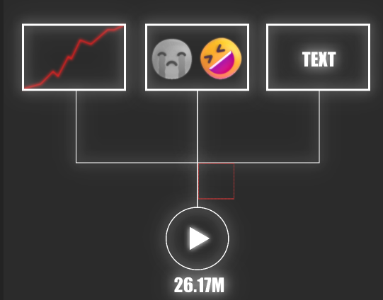

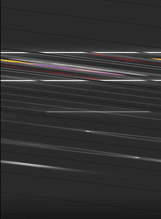

Hello, I have came across the issue where after rendering the footage using Voukoder it comes out distorted and stretched out. I have linked the screenshot of how it looks like on the timeline inside the project, how it gets exported and the log file below. Hoping to get some help, thanks

Does it work if you render it to a resolution of like 1088x1920?
Thank you so much king I just tried and it works, any reason behind why adding 8 pixels makes it render normally lol?
- Official Post
Some encoders require a width and height dividable by 4,8 or 16. I guess that has something to do with the macroblocks. I really need to fix this issue.
