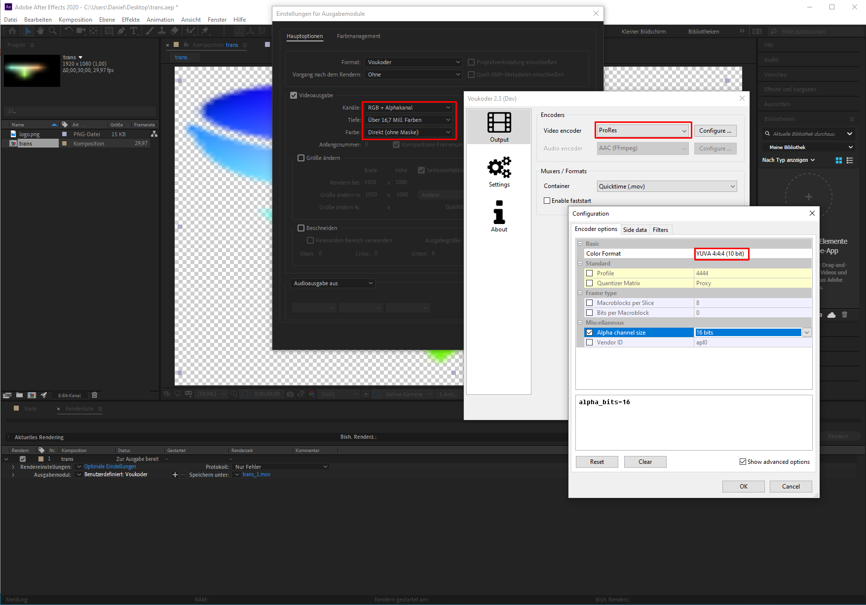

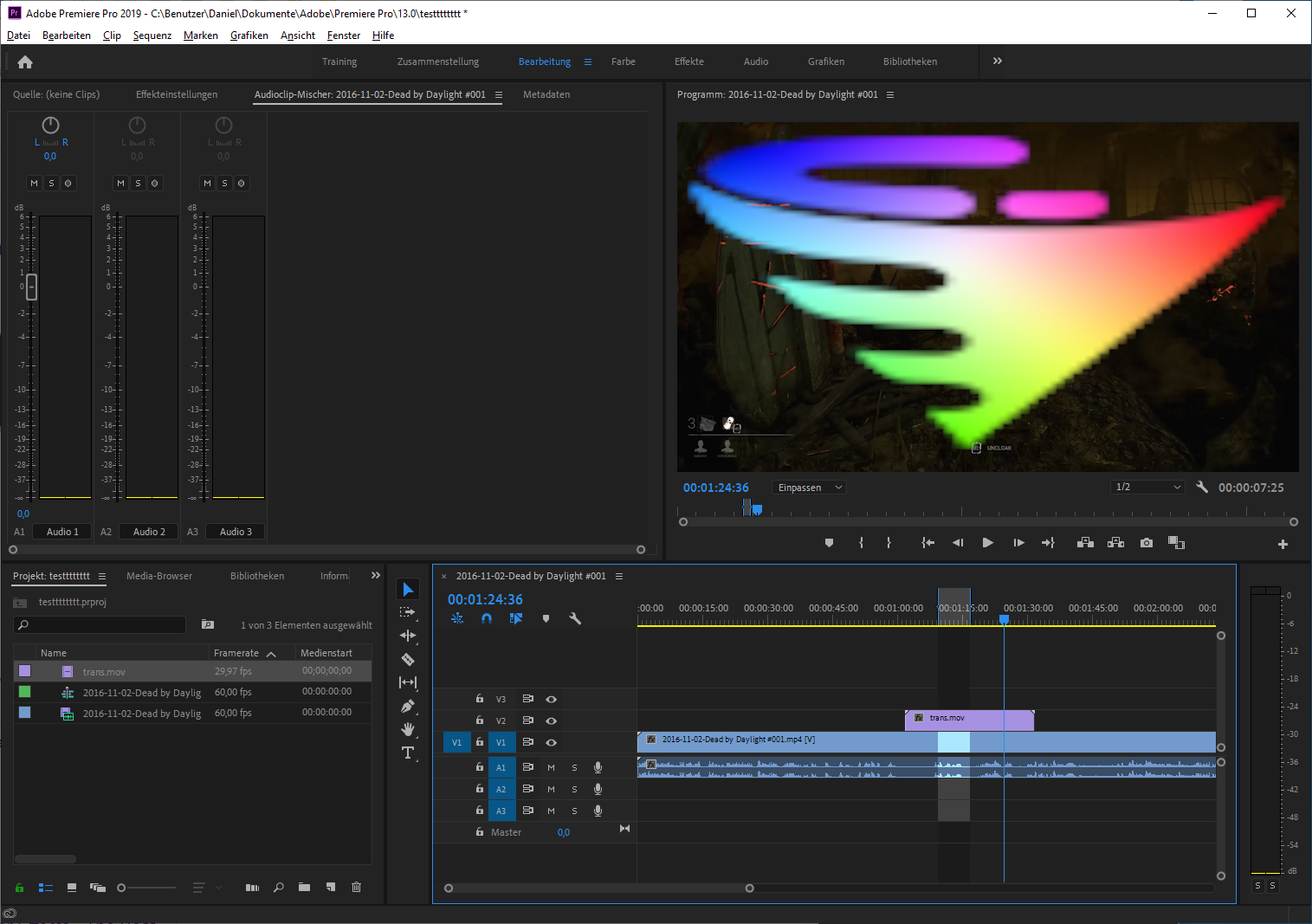

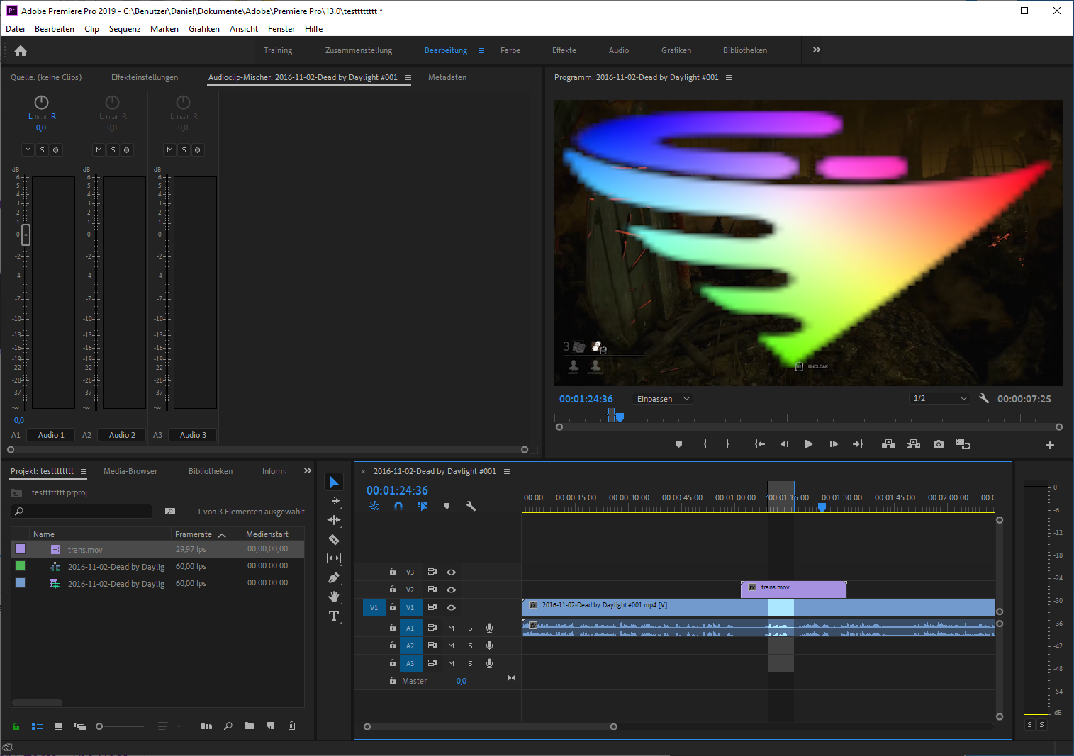

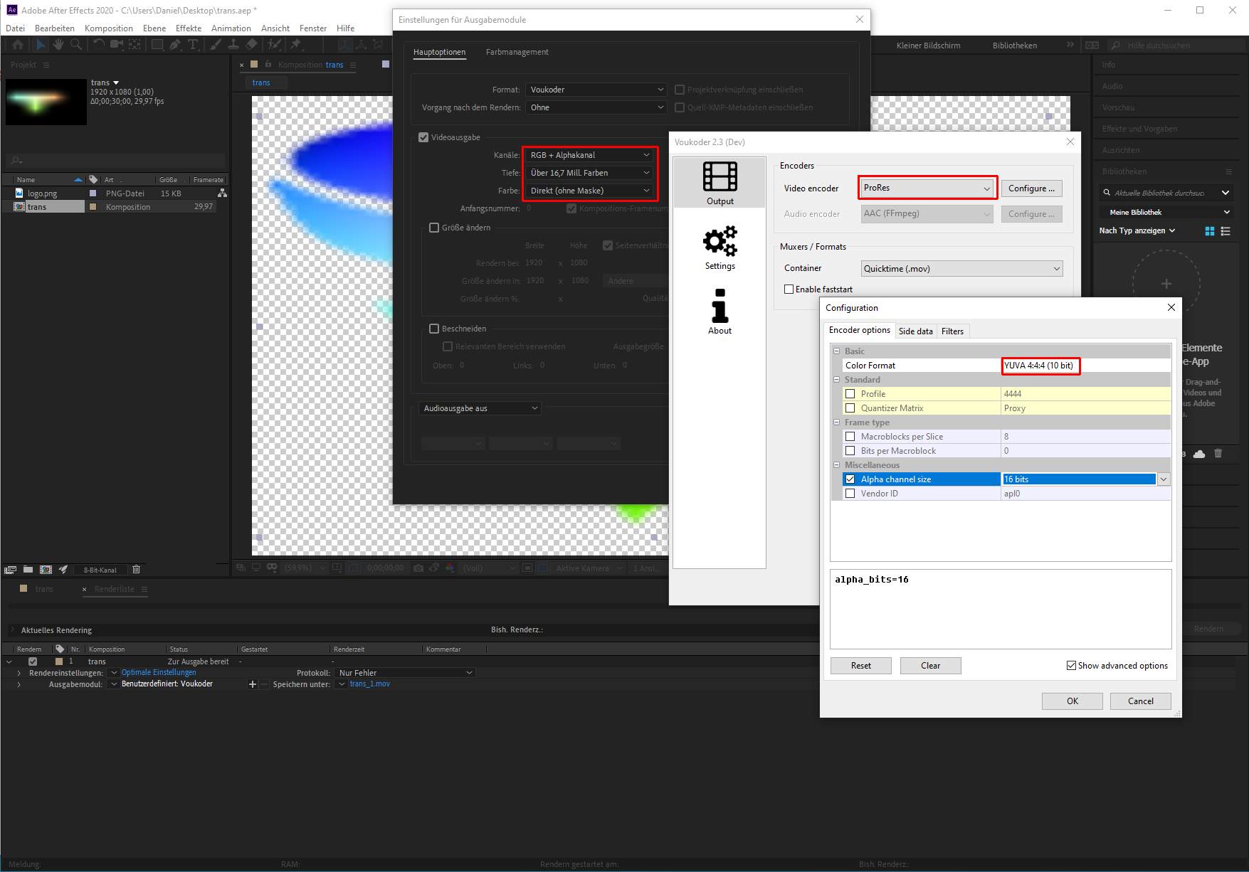

  • Good news! I tested it and it was already working with 2.2.
    It is important to use a codec / encoder that supports alpha channels (like ProRes) and a pixel format that contains an alpha channel (YUVA - A=Alpha).
    Works for me as you can see.
    Set the Label from Investigating to Done

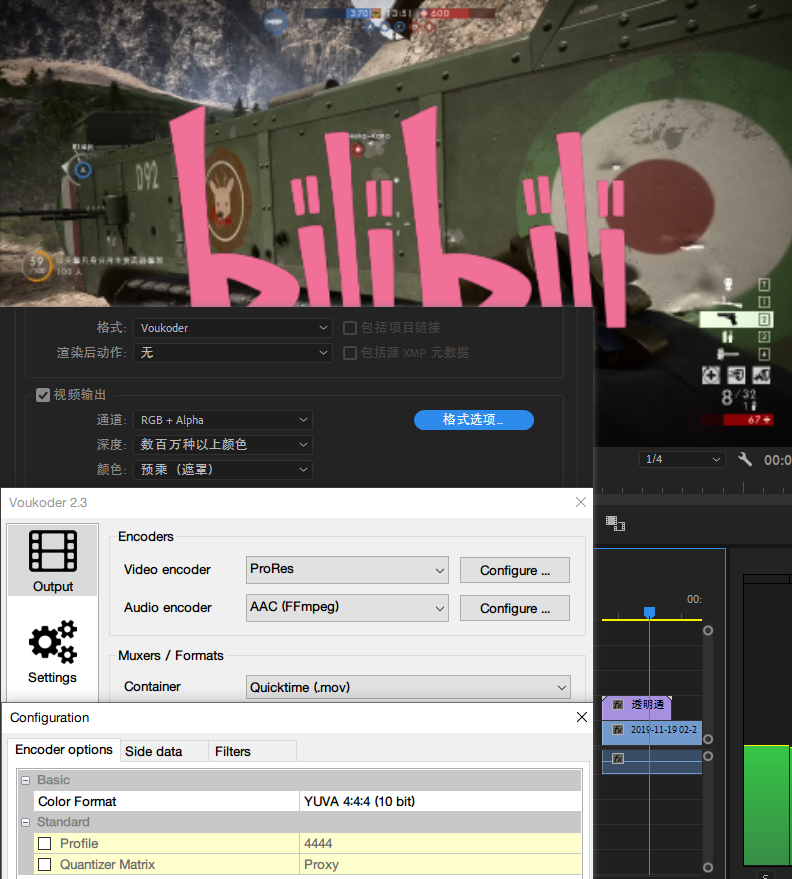

  • Thanks Vouk of your develop!:*

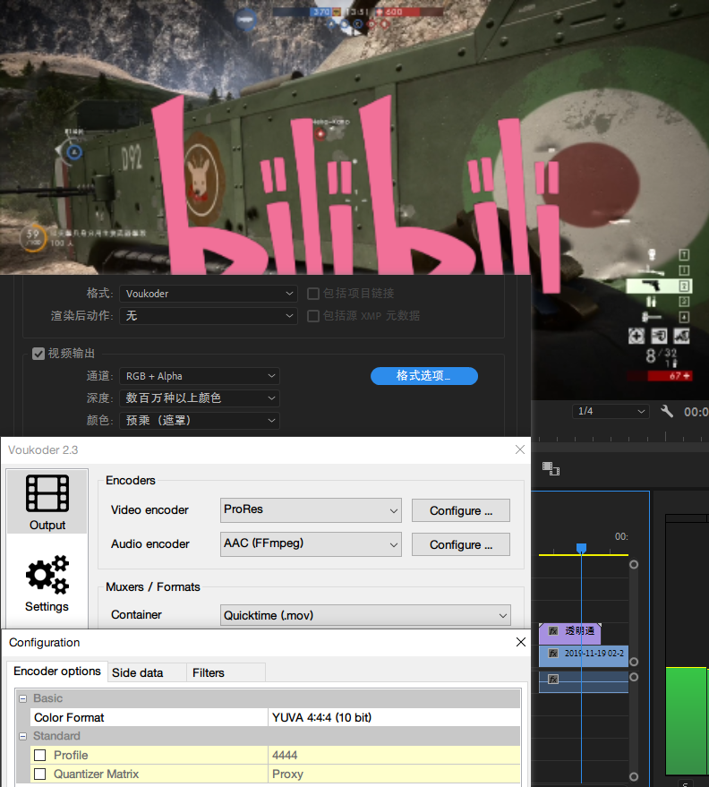

    I had test it on AE2019 with voukoder 2.3.
    I use your preset and it looks pretty awesome!

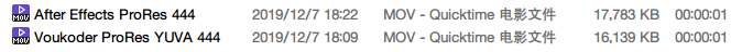

    But the file size is not too smaller than AE ProRes 444.
    Does the H.264 support alpha channal?
    I think the H.264 encoder's file size is the samllest.
  • You don't want the smallest file size here. Smallest file size means highest compression. And as you want to put this clip as source media in a premiere project I guess you'd even like to have no compression (-artifacts) to get highest quality and fast timeline scrubbing.
    Don't care about 17MB files. :)
    Alpha channel makes only sense with intermediate codecs (like ProRes). You need these in the editing process. When you're exporting a finished project you don't need it anymore. h.264 does not support it.

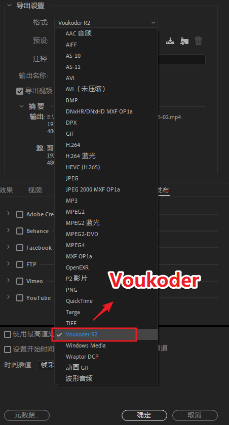

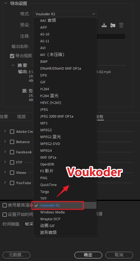

    And I have a suggestion. Change the codec name "VoukoderR2" To "Voukoder“.Just like AE ,bro.
