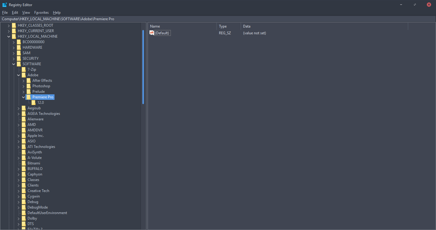

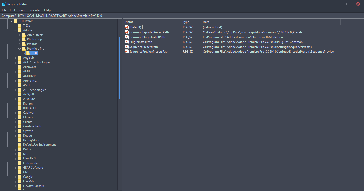

  • can you start regedit.exe and make a screenshot of this key with all its entries first, please?
    HKEY_LocalMachine\Software\Adobe\Premiere Pro\
  • So, also strange one. According to the Premiere Developers Guide a key "CurrentVersion" should be present.
