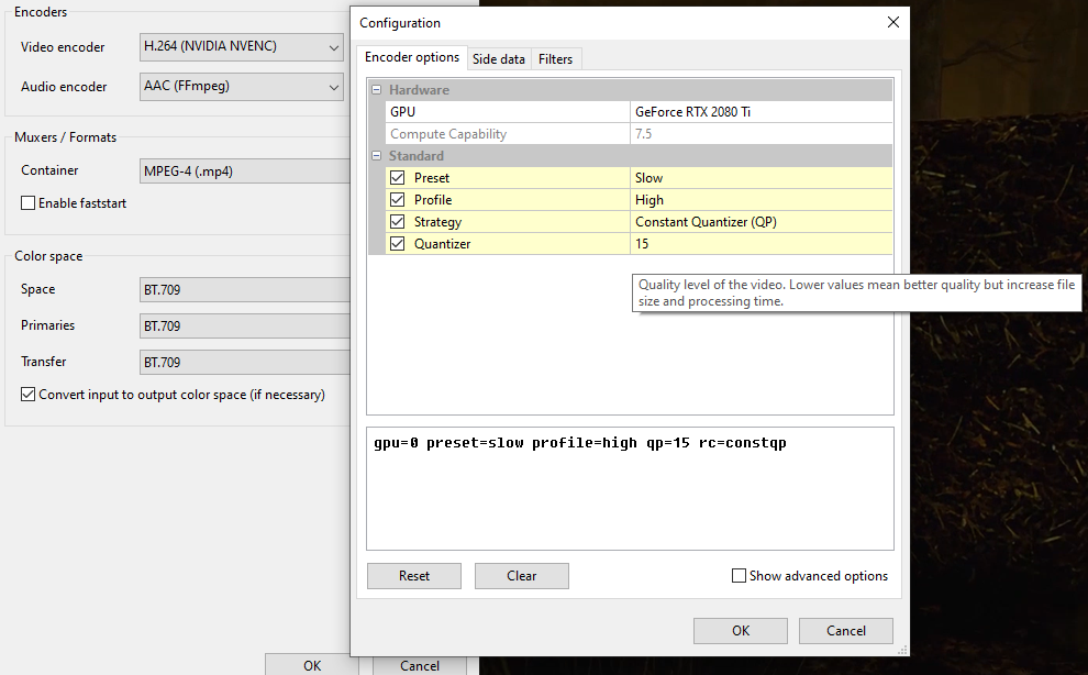

    These settings are a good start:
    If you want to tweak it a little more click "Show advanced options" and choose:
    • RC lookahead: 16
    • Number of B-Frames: 3
