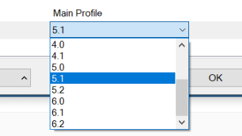

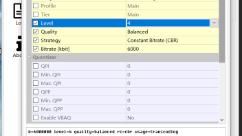

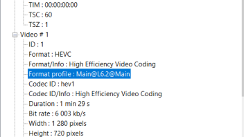

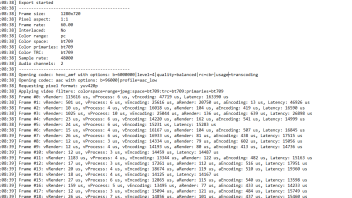

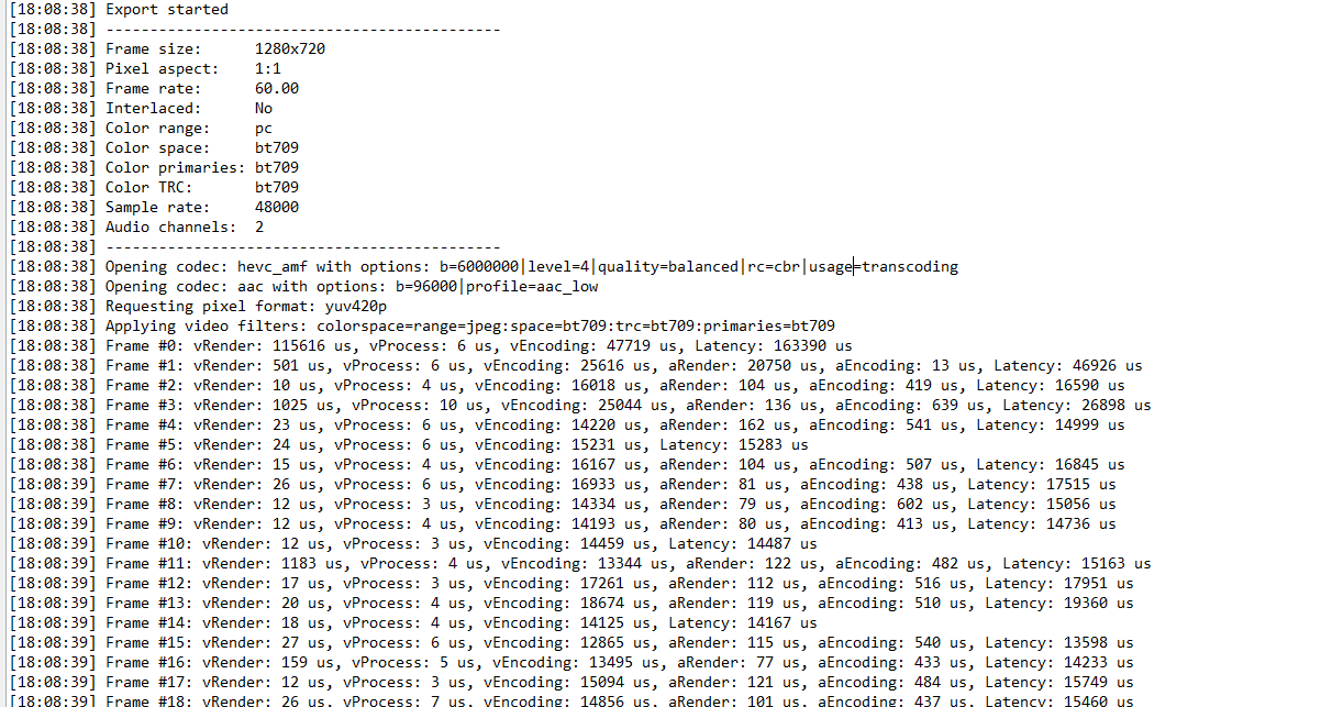

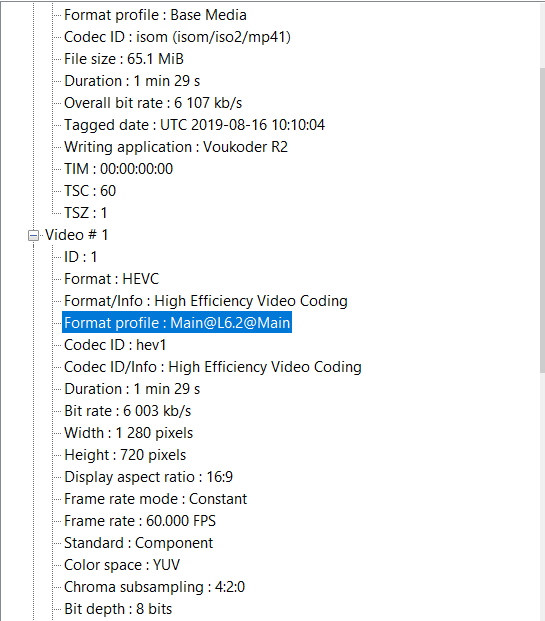

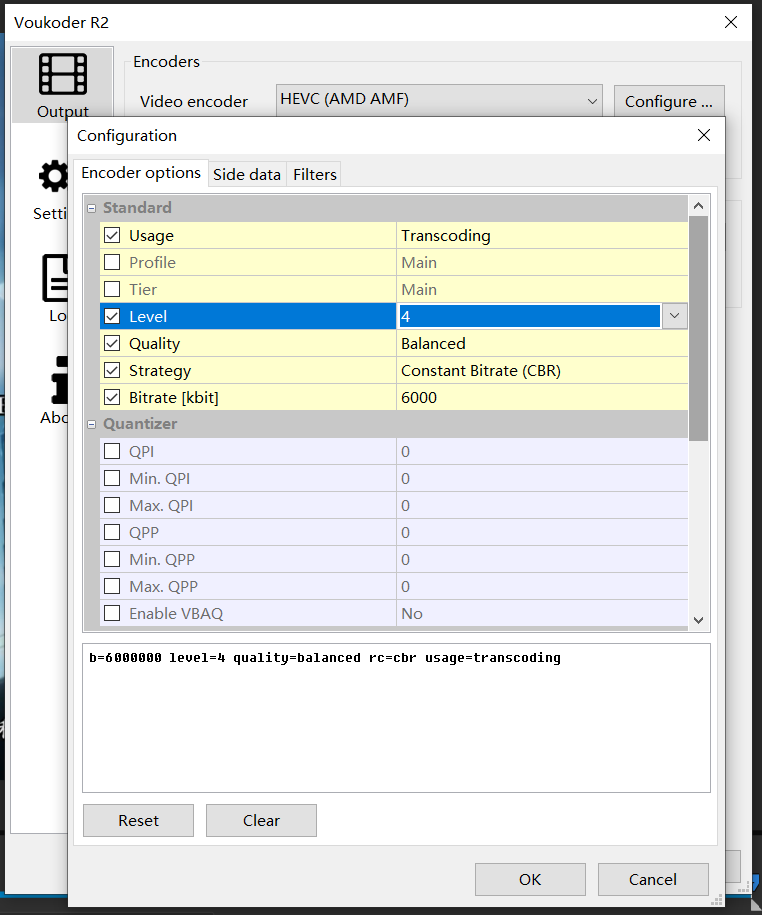

    Hello. I tried Voukoder today and found it very easy to use. But there is a bug about the AMF HEVC encoder that is annoying. No matter what profile level I set, the final output video is profile level 6.2. I also tried to adjust the options next to it, but it didn't work. After viewing the log, I found that the level in the input parameters is also correct. In contrast, the AMF H.264 encoder can properly adjust the profile level.
    If possible, I hope that developers can help me solve this problem. thank you very much!
    Version: 2.2
    GPU: AMD RX 560
    Driver: 19.8.1 (latest)
    Log file:
    AMF HEVC Encoder options:
    Output video information through potplayer:

    This looks okay from the voukoder point of view. Did you try to do this directly with FFmpeg?

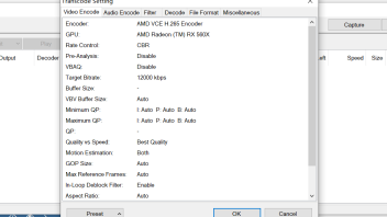

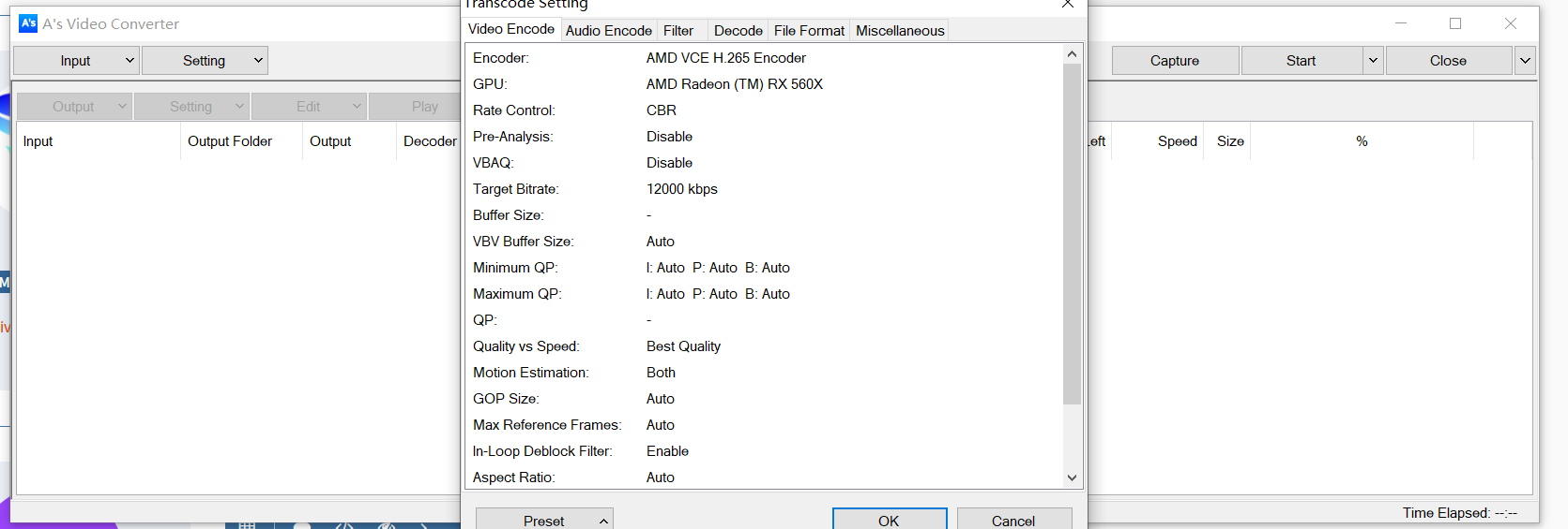

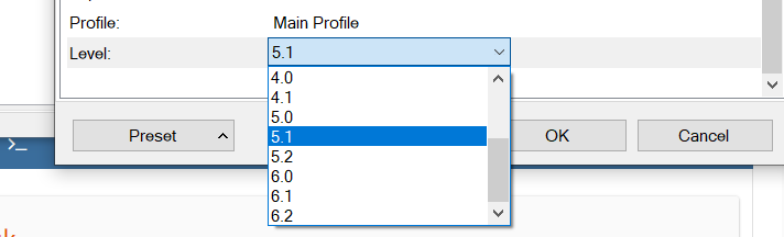

    BTW I know a transcoding tool called A's Video Converter that can also take advantage of AMF HEVC. It correctly adjusts the profile level and other parameters. But I don't know if it is also composed of ffmpeg.
    So I don't know if the root of the problem comes from AMD driver or ffmpeg.
    A's Video Converter: https://bluesky23.yukishigure.com/en/AsVideoConv.html

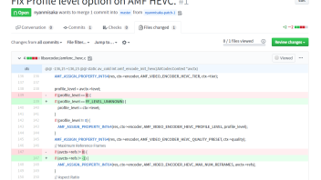

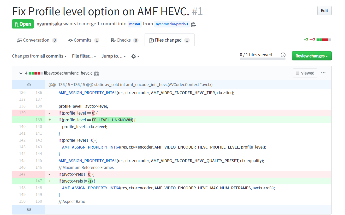

    Thank you for your inspiration. I have fixed this ffmpeg bug and pulled request to FFmpeg.
    I hope that Vuokoder will be able to follow up on this change in a future release.

    Voukoder does build from FFmpeg master and will use it once it got merged.

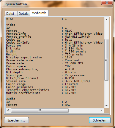

    Only for information:
    Same Problem with nV HEVC. MPC-HC reports L5.1, requested was L3.1. This doesn't happen with the nV AVC encoder.
