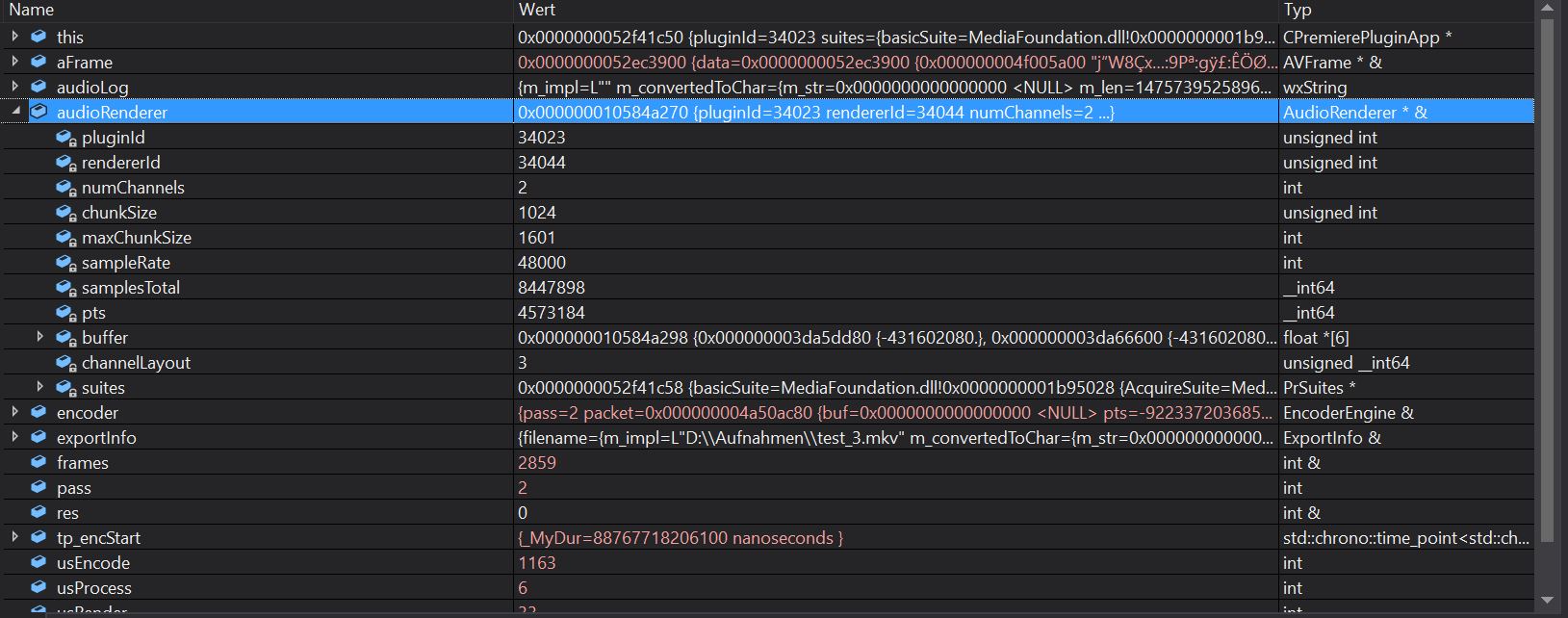

Maybe the issue could be this commit. When the seconds pass starts the audiorenderer is not created would be my assumption.

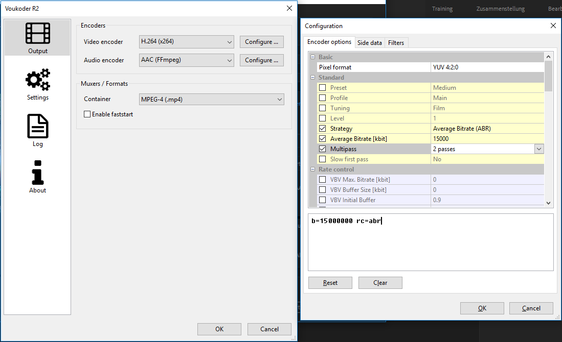

I used the same settings you have posted Vouk. Here is a complete logfile.

Checked mp4 and mkv. I can not reproduce the issue, but I see the issues in the logfile. I'd guess that in your case:
if (audioRenderer)
audioRenderer->Reset();
audioRenderer is suddenly NULL and the Reset() is not called. But i'm not sure how this can happen.

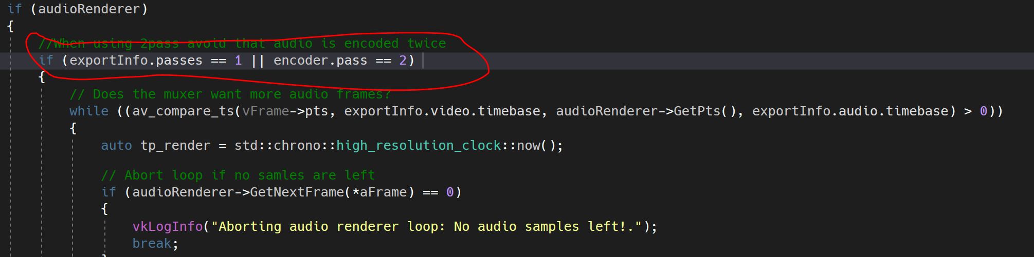

Yes, in the pull request I have replaced if(audioRenderer) with if(exportInfo.audio.enabled) then everything works fine.
I have also made an if clause to avoid that audio is encoded twice when using 2pass.

That's strange audioRenderer isn't NULL while debugging, but why it doesn't work?
When using 2pass the audio is encoded already in the first pass. When the second pass starts audioRenderer is NULL because it's already done in the first pass I think. With my added if clause that prevents encoding the audio twice, it is fixed.
