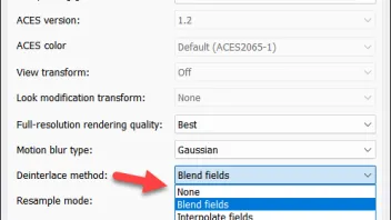

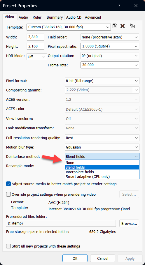

  • This error is actually misleading. It complains that no interlace type has been set (-1). Can you check what type you have set in your project? Upper first, lower first or progressive?
    Ahh that explains that then, I have Interlace Type set to Blend Fields but often turn it off completely. Also, fwiw, Resample is always disabled here.
    I did try some other settings for Interlace Type but still get the crash. The render immediately goes to 100%, no file is created, and Vegas then crashes.
