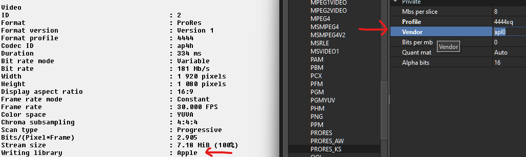

There are several problems here. All color tags are listed as unknown, despite Set Params being used. The file is also falsely tagged as progressive and not interlaced (but the footage is indeed properly interlaced. Only the tag is wrong.). Lastly, vendor is being reported as "FFMP" and not the specified vendor "apl0".

This fixes the color tags except color_range. I'm not sure how to get it to properly set color range. I found this documentation on color tags and color range, and it outlines two color schemes for full range and video range, but it doesn't seem to say how they are tagged in the file. Maybe I'm missing something? https://developer.apple.com/documentation/…_parameter_atom
Additionally, the field_order tag is corrected, but the vendor tag remains incorrect.
Lastly, interestingly ffmpeg switches the order of the streams around. I normally keep video as stream 0 and audio as stream 1, but I'm not sure if this actually ever matters in practice. I just thought it was interesting to note.
Would it be possible for Voukoder to do the following:
1) Have the option to write the colr atom to MOV files
2) Have the option to apply the prores_metadata bit stream filter to prores_ks (and maybe to the other ProRes encoders?)
3) Fix the vendor tag to properly reflect what is defined in the prores_ks encoder (apl0 in my case)
4) Fix the field_order tag to get the proper value from Set Params or the Field Order filter.
