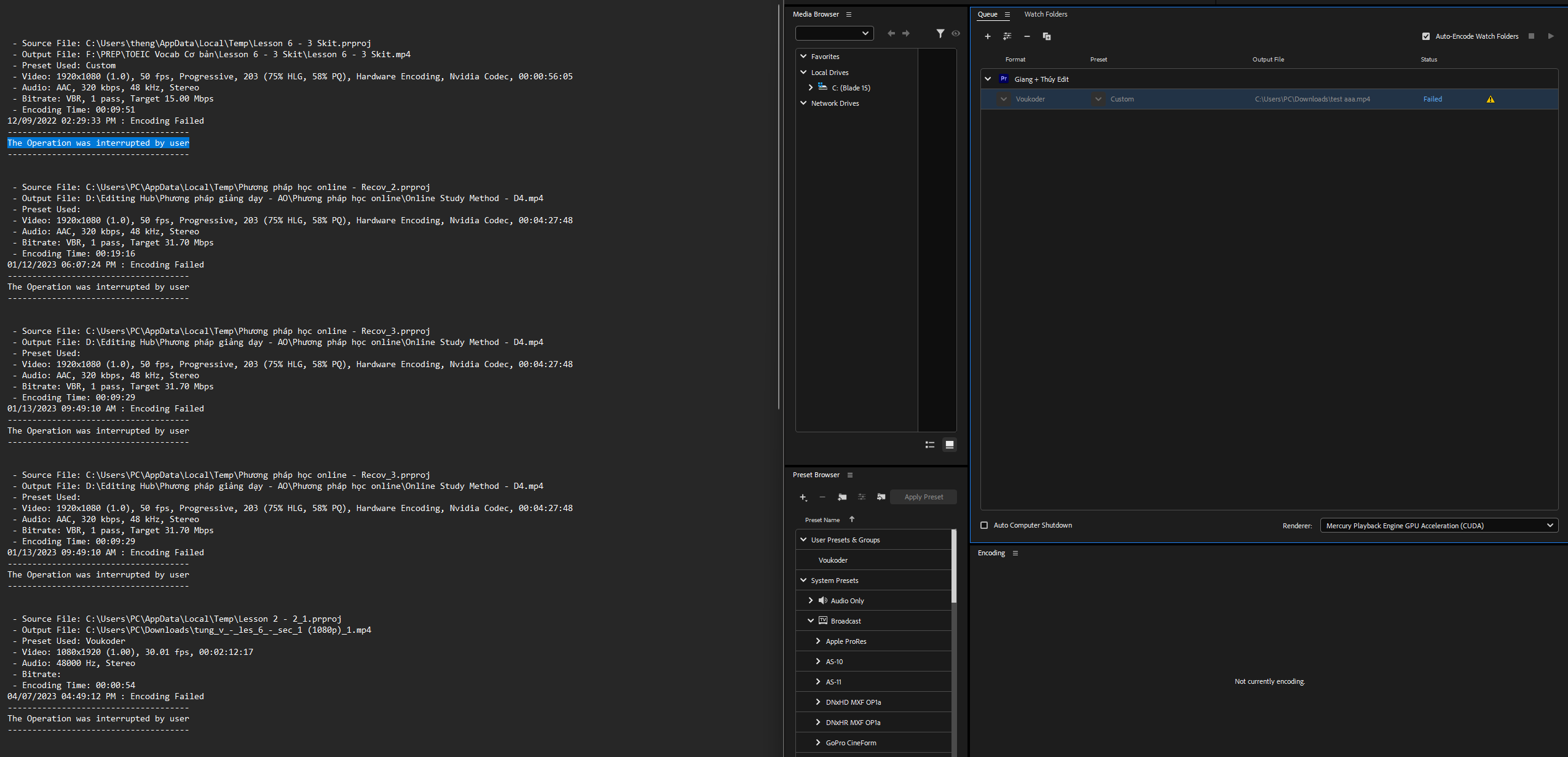

"The Operation was interrupted by user" Bug after 13.1
thenguyen2812 -
May 6, 2023 at 9:06 AM

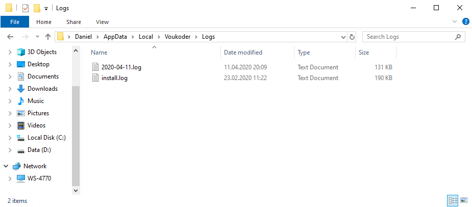

ThreadWhere do I find the log file?

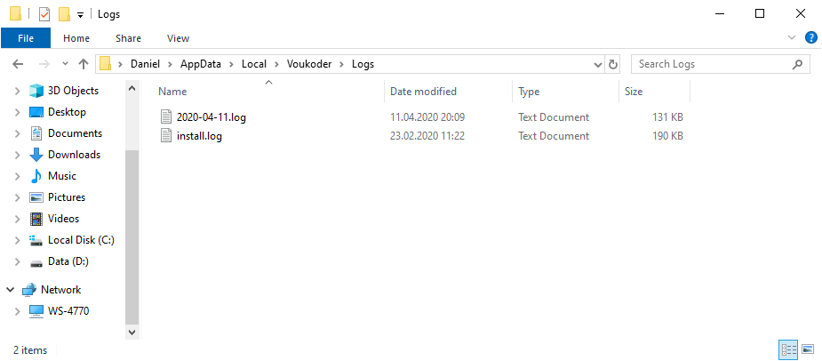

Main log file
The main log file contains all log data for one single day:- Voukoder initialization
- All exported files
(Code, 1 line)
The files are named by the ISO date (yyyy-mm-dd).log:

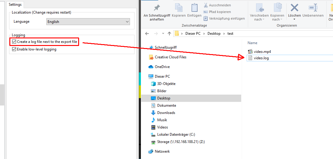

Export specific log file

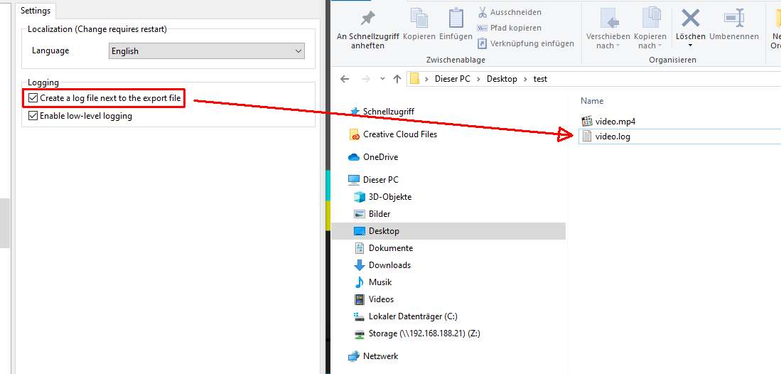

If you have "Create log next to the export file" enabled you can also find it - well ... - next to the exported file. This log file contains only the export relevant information.
Low level debugging
Sometimes its neccessary…VoukApril 20, 2020 at 2:57 PM -

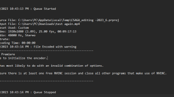

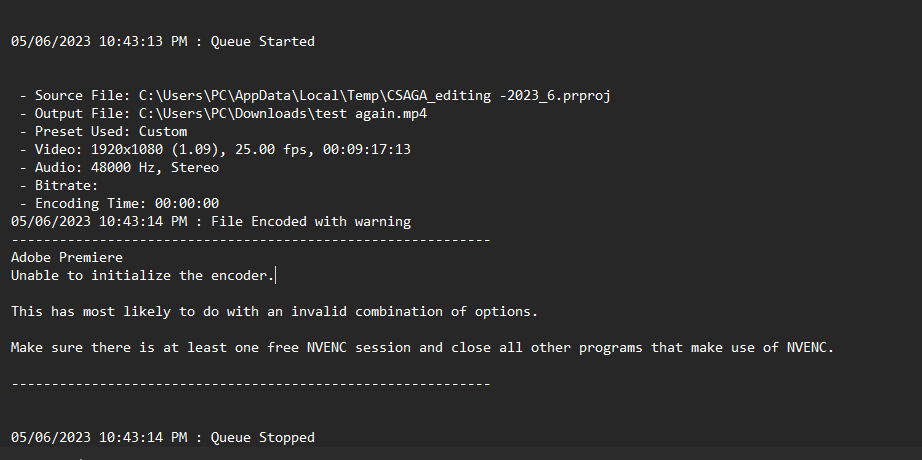

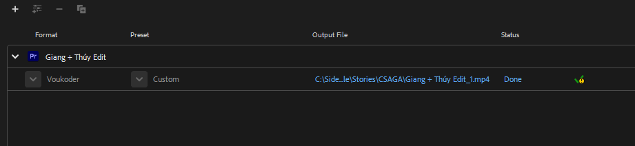

Thank you for responding.
Here I zipped both a log before and after I updated. -

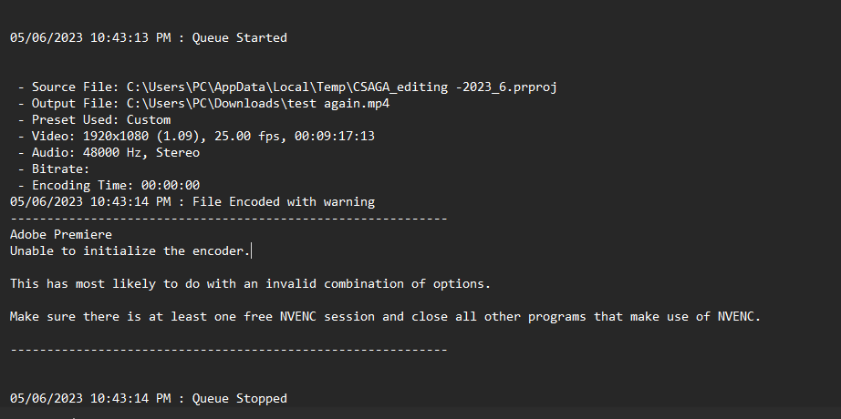

I found out it only happens when I try to use H264 (NVENC), regular H264 it runs just fine despite the framerate.
I've been trying to update my graphics drive but the H264 (NVENC) just ends up disappearing from the dropdown list.
Update: I managed to get the option back to the drop down but it still has the same problem for NVENC
