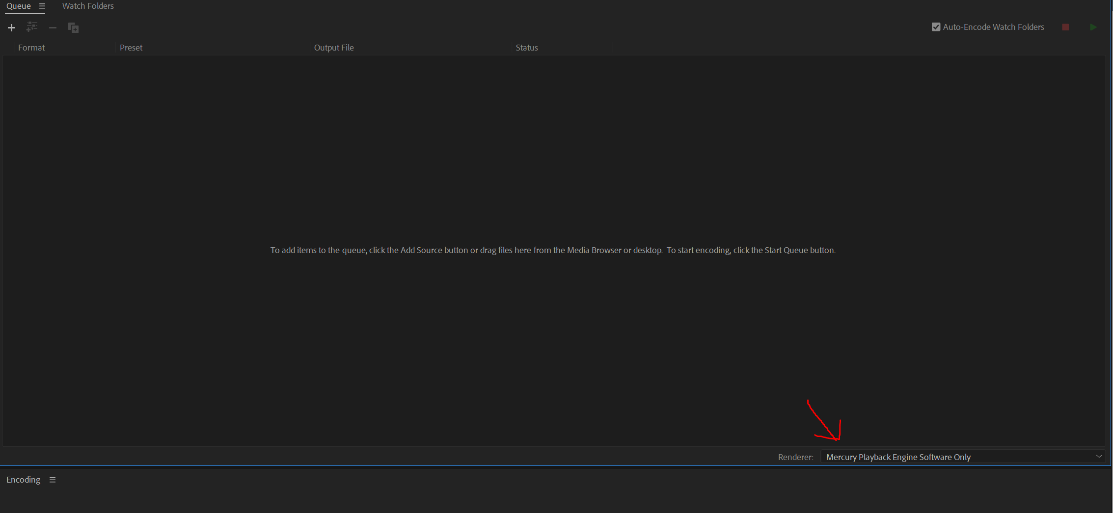

You could try to export without CUDA acceleration in Media Encoder. But you need a lot of CPU power then.
