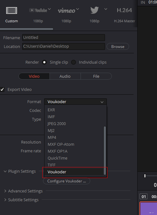

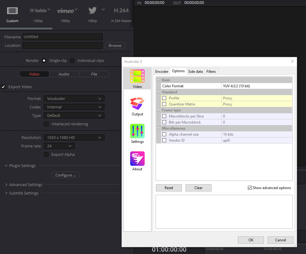

1. Basically export speed is the reason. If you export a yuv420 (8 bit) it is significantly faster to use the 8 bit output mode in resolve. Otherwise each frames data has to be converted from yuv444 16 bit down to 8 bit first, and then sent to the encoder. If resolve delivers 8 bit already we can just pass it through to the encoder.
2. It is a bit tricky because it just shows the available containers that support the current selected audio and video container. But I'll see what I can do.
