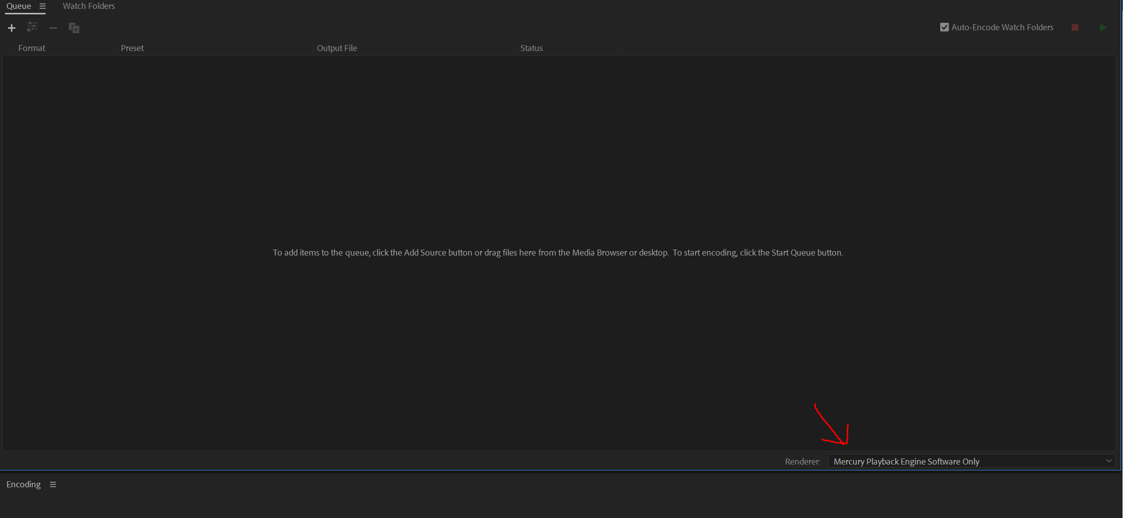

  • You don't understood me. Media Encoder uses the GPU (CUDA cores) too. You can disable this by turning the Renderer to Software only in Media Encoder.
    Turning this to software only helps maybe.
    NVENC is an encoder not a renderer and is still used.
