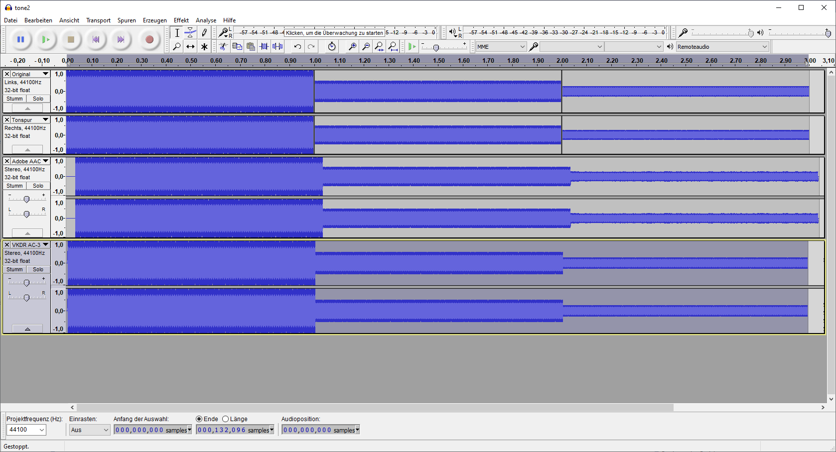

- Created an audio file with Audacity. First tone is 100%, second is 50% and third is 25% (First two mono tracks)
- Adobe AAC created this stereo track. Amplitudes look okay
- Voukoder (Connector 1.2.0, Voukoder 3) with AC-3 also created same looking results.
Can you try to reproduce?
would you believe me that playing back the file made in vouk, it is much louder?
But when bringing the same file back into premiere the peaks and waveforms look exactly the same and the playback within premiere of the encoded file is NOT louder?
I know this sounds goofy but it's true.

So from the encoder and decoder point of view everything looks alright. So no bug in premiere and/or voukoder.
Ergo: It has to do with how the player plays it and thus it should be the metadata in the encoder settings: https://www.ffmpeg.org/ffmpeg-codecs.html#AC_002d3-Metadata

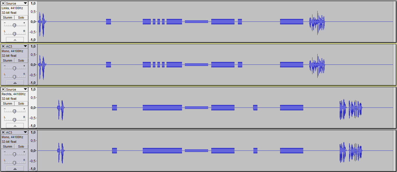

But what I've also found is:
- Premiere renders a mono audio track of 100% amplitude to only 70%
- Stereo is 100%
I really don't understand this. Why does mono get rendered to 70% only?
