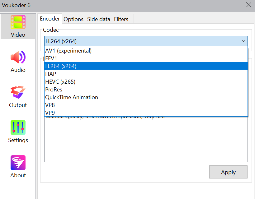

On a Quadro machine with latest Quadro NVIDIA drivers (517.4), NVENC options are gone in 12beta6
The problem is fixed with latest Nvidia driver and 12beta6,thank you!
I will check this evening and report back!
Please try if version 12beta6 fixes this issue.
Looks like NVENC options are gone in this beta?
