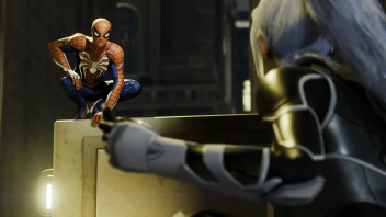

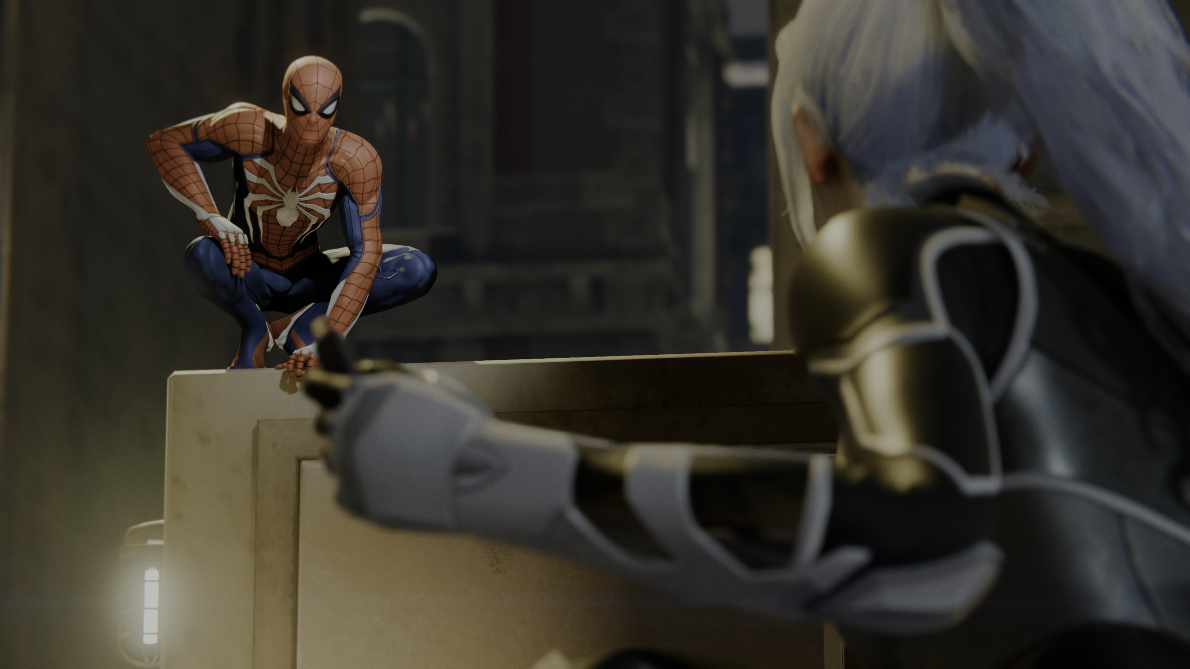

    When I select rec2020 for output in Voukoder, there appears to be some color space conversion going on, which causes a serious shift in colors, making everything appear greenish. I'm guessing Voukoder sees the footage as rec709, and wants to convert the colors to rec2020, but even though Premiere interprets it as rec709, the footage is actually rec2020 and so should need no conversion. Here is a raw frame as it appears in Premiere on a normal monitor:
    and here is how that frame gets encoded with Voukoder set to rec2020:
    Right away, even in the unprocessed raw footage you should be able to tell that colors appear more washed out, and more green tinted. But here are the same two images, with HDR-to-SDR tonemapping applied, to give you a more "correct" look at how the images would display:
    That's a major shift in color, and looks really bad.

    2.2 doesn't save any of my advanced x265 settings, so I can't exactly encode HDR properly, but outputting with bt2020 settings in the main Premiere window does in fact cause the same color shift.
    In the meantime I've found using a rec2020 to rec709 conversion LUT, applied in Lumetri Color is a workaround to this issue, but of course this limits the color gamut to SDR color, so it's not ideal.
