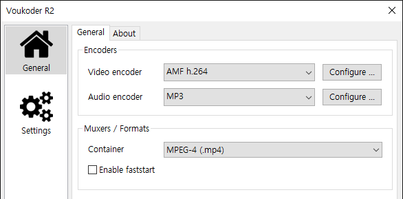

The 2.1.1 version does not seem to be compatible with AMD's rx 5700xt.

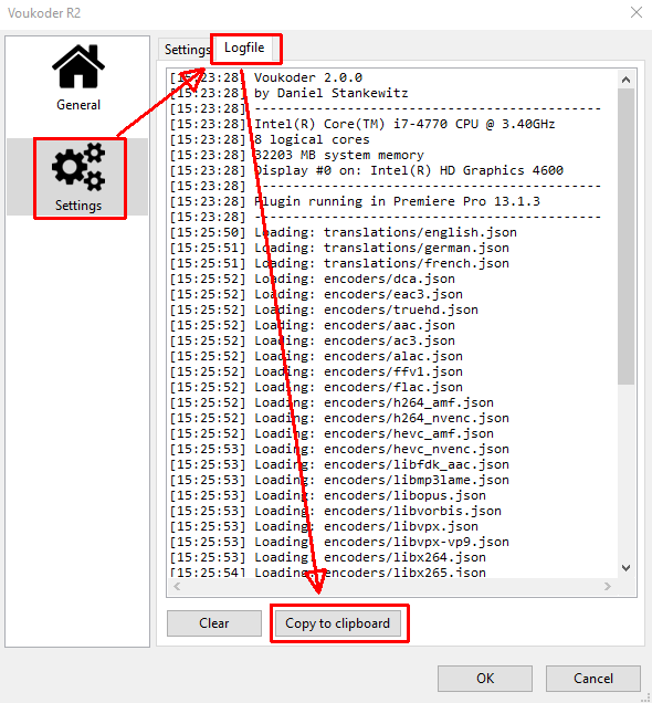

Could you let me know where is the logfile??
- Official Post
See: Settings > Logfile

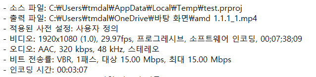

Ticks = 1405766 <2220> <EncoderStateH264> <1> Time taken for; video =165946 audio=7342 mux=15
Ticks = 1405766 <2220> <ExporterHost::BeginThreadExport> <5> Exporter finished in : 185.973 seconds. Result code: 0 Destination:C:\Users\tmdal\OneDrive\諛뷀깢 ?붾㈃\Voukoder_Test_2.mp4

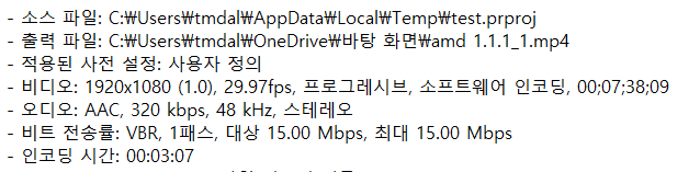

Okay, render times look pretty good. It is actually the video encoder that is slow.

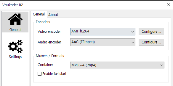

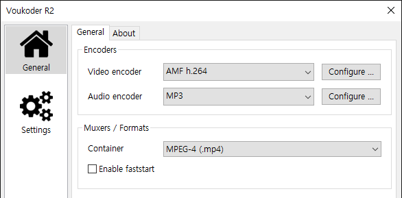

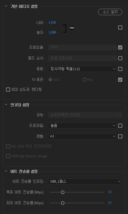

umm... i don't know it is surely faster. almost same! but I found something new. When I changed from AAC (FFmpeg) to mp3, the encoding speed was reduced by about 7 minutes. This is about 20 percent time saving. Is this a natural thing?
- Official Post
Yes, it should be slightly faster because premiere is not involved rendering the frame. But if it is almost the same then it is okay.
About aac vs. mp3... did you try to export video only? What about that?
