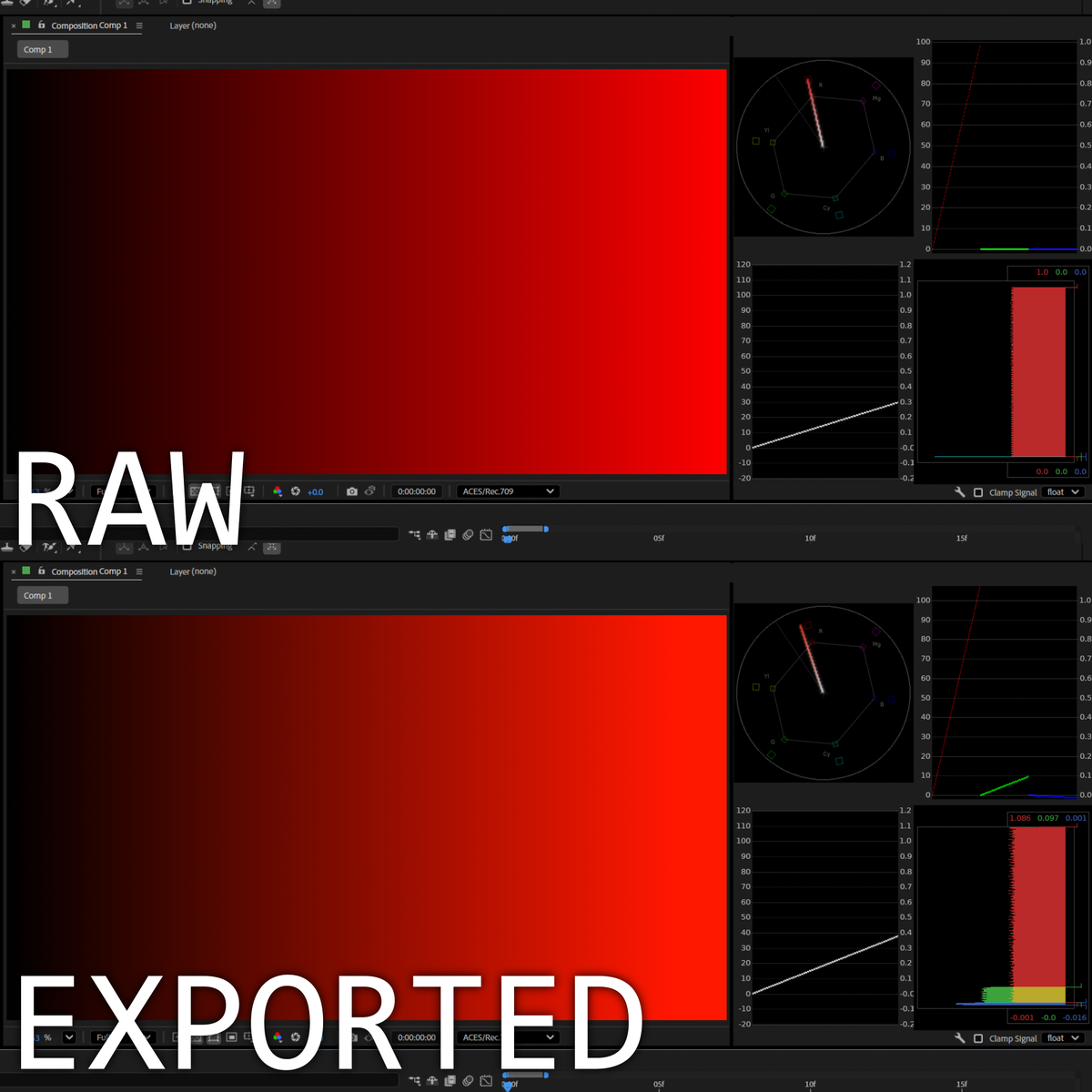

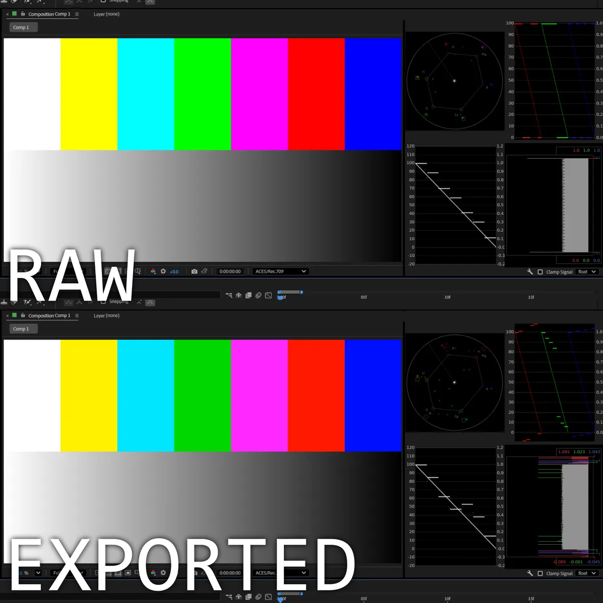

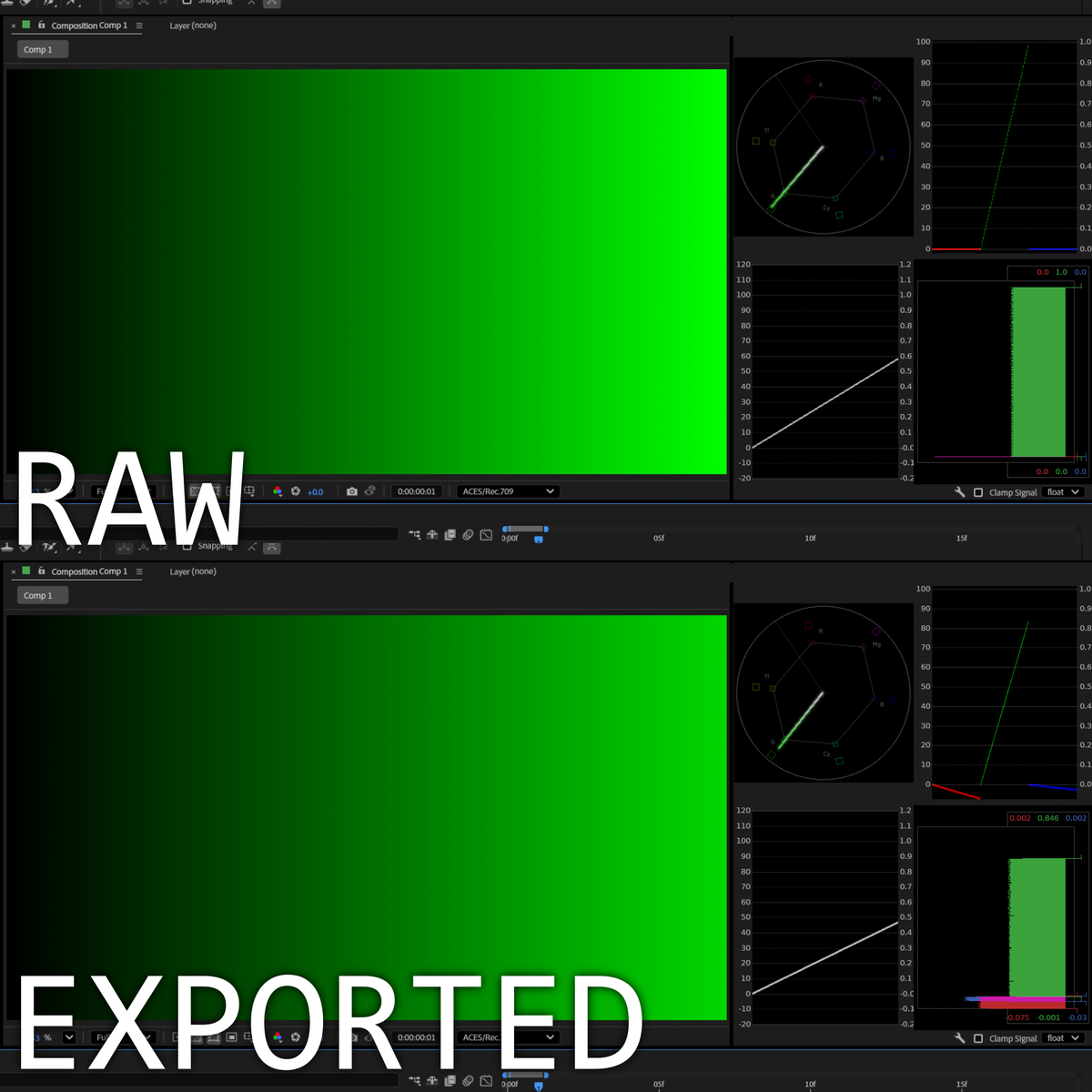

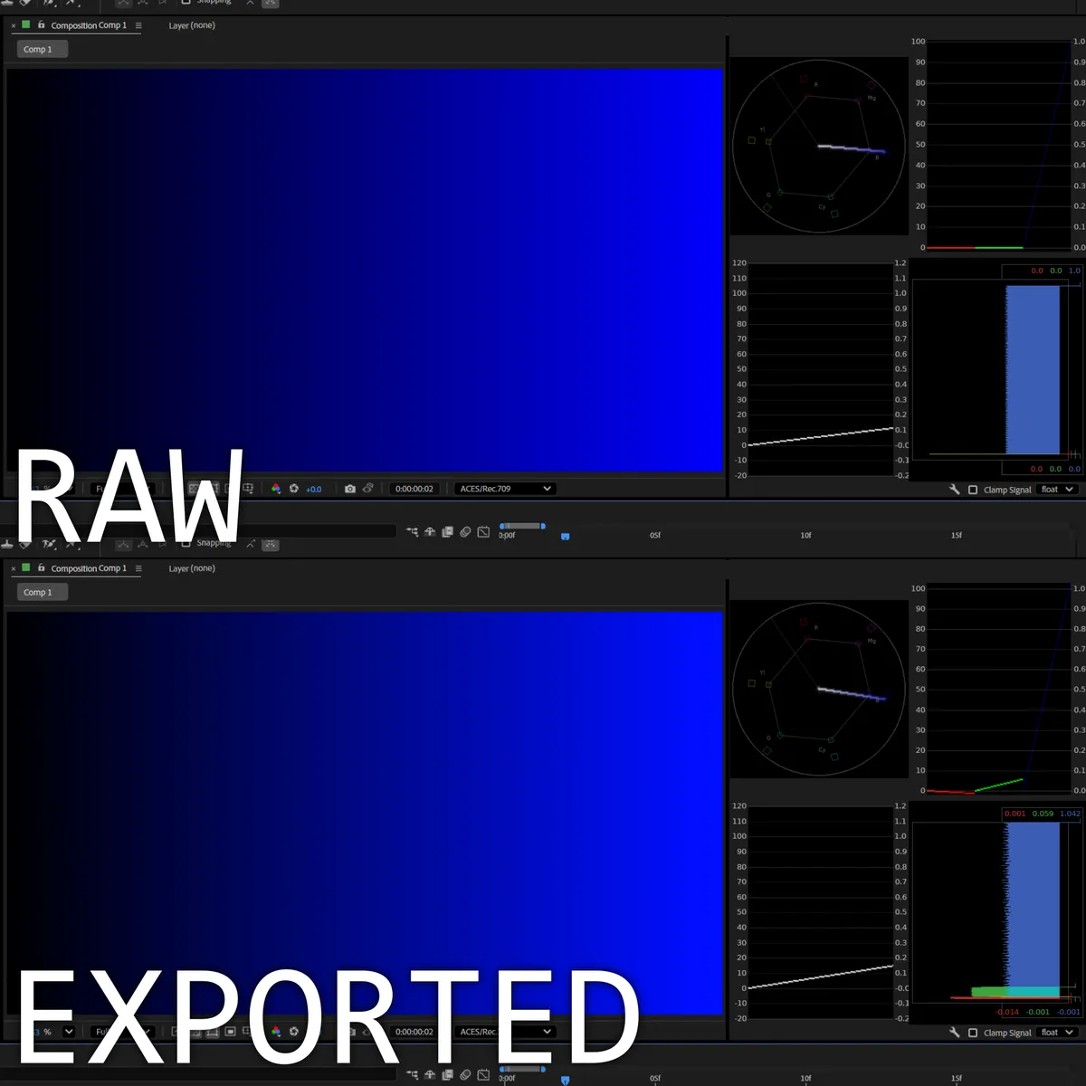

Adobe Color Space Bug
  • Encode Format: PRORES_KS 422
    Version: Voukoder Pro 2026.0.18 | After Effects Beta 26.1.1x31
    Since voukoder pro 2026 (beta or later version), VIDEO encode format has this color issue on adobe, no matter what config I use about Color Space (AE & VKP, even the HDR metadata)
    (VKP 2026 works well on VEGAS)
    It seems NOT the plugin's fault cuz the issue still there when I replace them with legacy (version 2)
    Different video encode format's issue varies on detail, but yes, all of them have this issue (at least I tested H264, HEVC, PRORES)
    * my scenes

    *btw the pic i posted was rendered on 32bit
