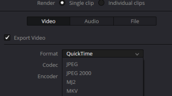

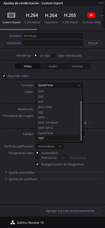

    I am looking to use Voukoder with davinci resolve 18.
    After installing the latest version of the connector and Voukoder.
    I followed the readme in the connector to set it up, but Voukoder does not appear in the davinci resolve 18 format...

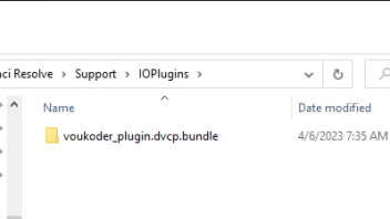

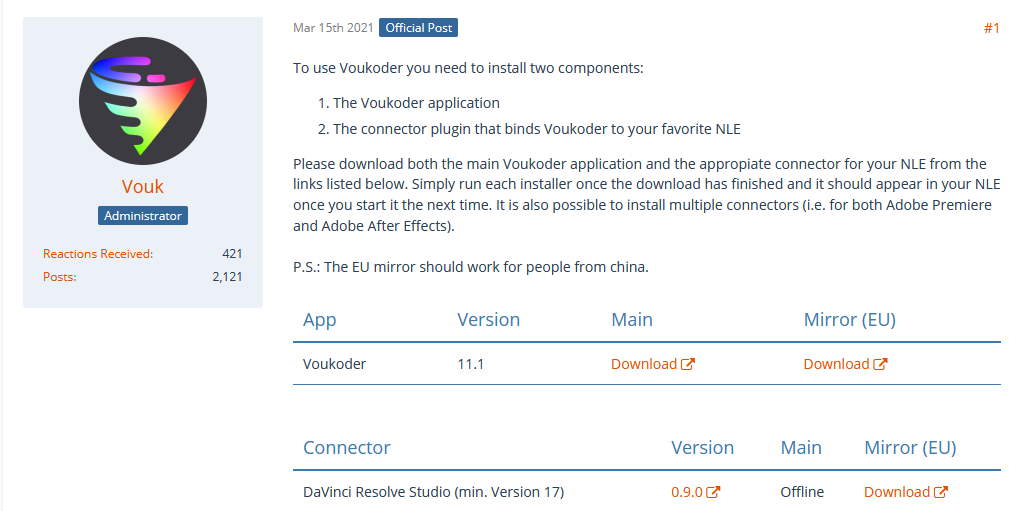

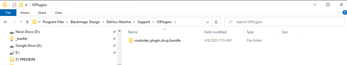

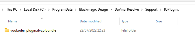

    Are you sure you have the connector installed to:
    It has to be Program Data, not Program Files!

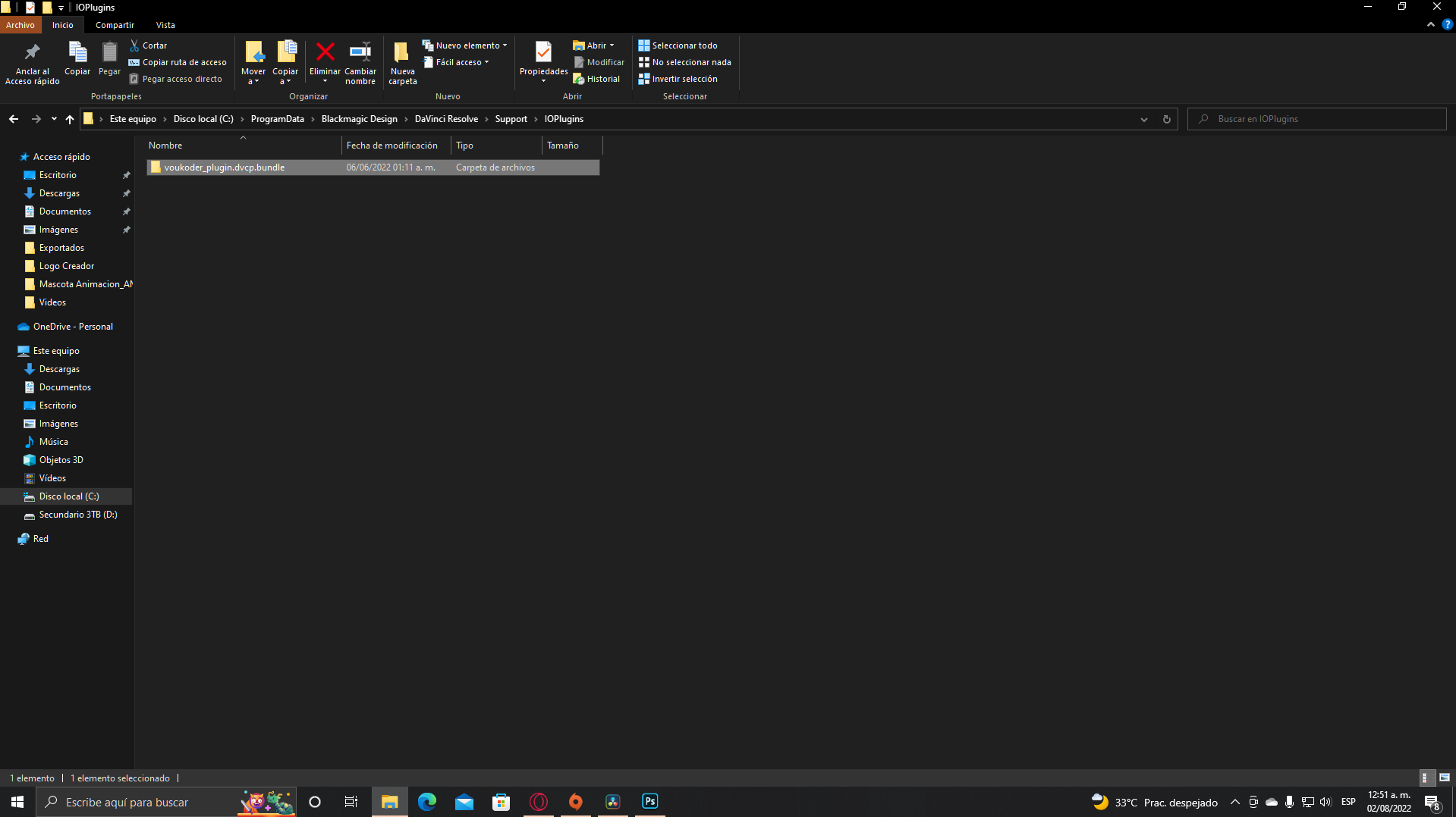

  • Voukoder doesn't start in DaVinci Resolve 18.
    I had the plugin installed in Progam Files first, and i searched how to fix it, then i saw this and moved the connector to the correct place and still doesn't work.
    Do you have any idea why it still doesn't work?

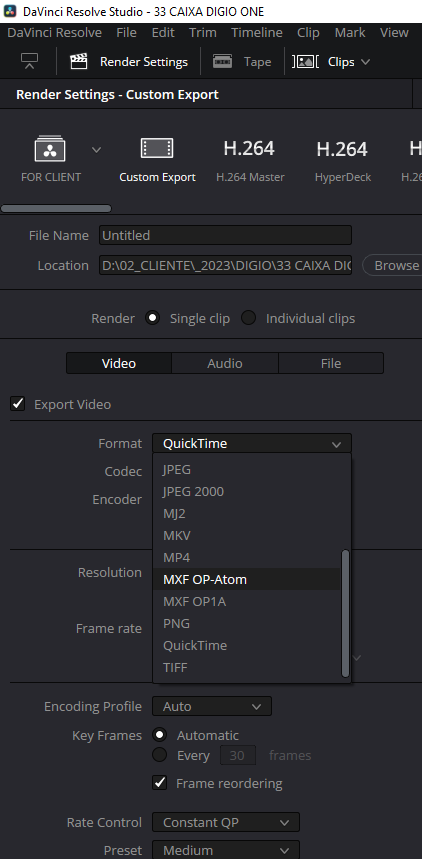

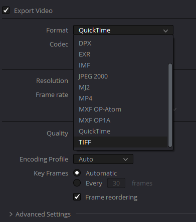

    If you are using the free Version of Davinci Resolve, Plugins do not work. You need the Studio Version to use plugins.
    Thank you for your kind reply.

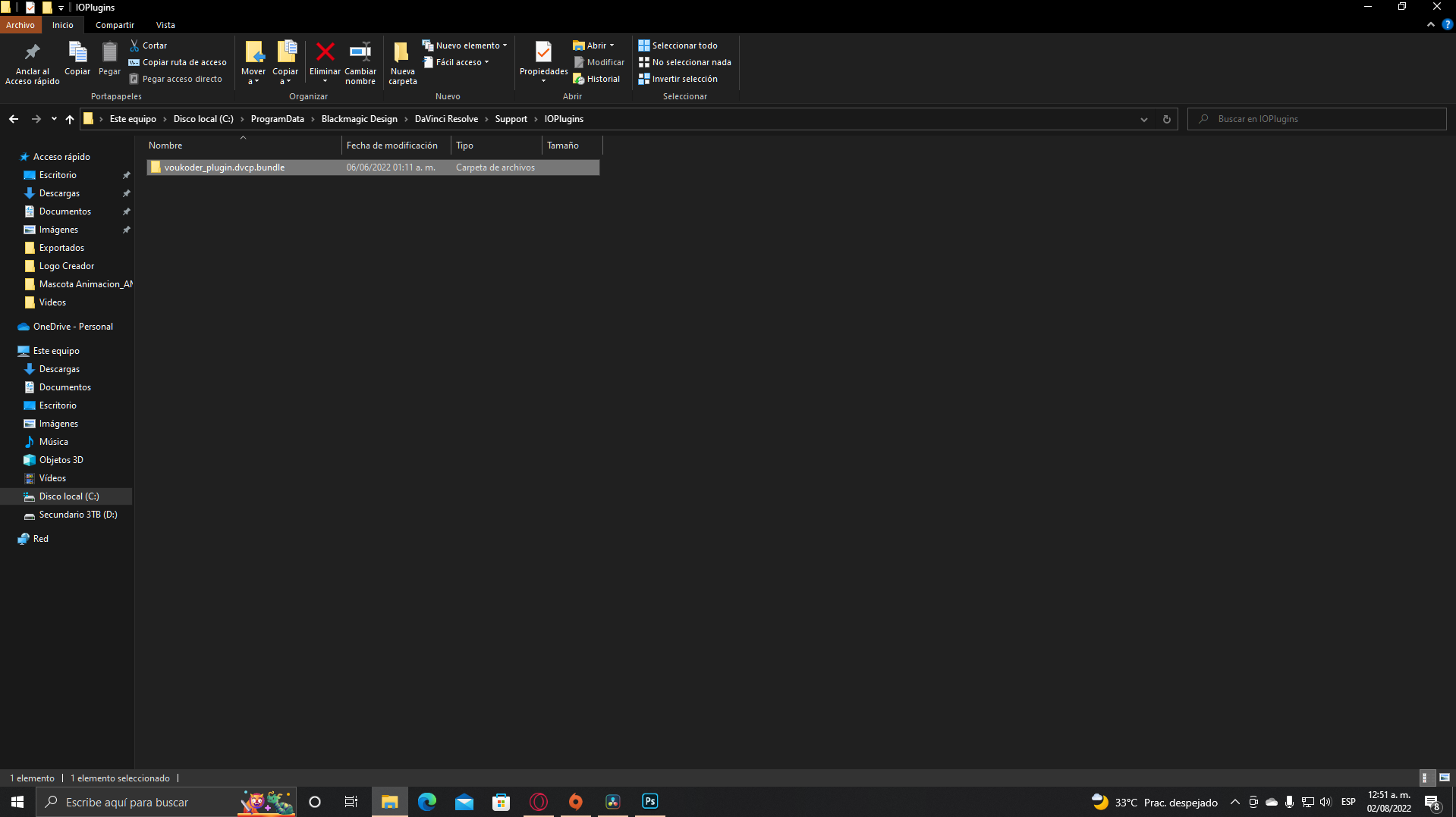

    I am using the free version of Davinci Resolve 18.
    As for the setup, it is the same as how Vouk and ElPichiSebas do it.
