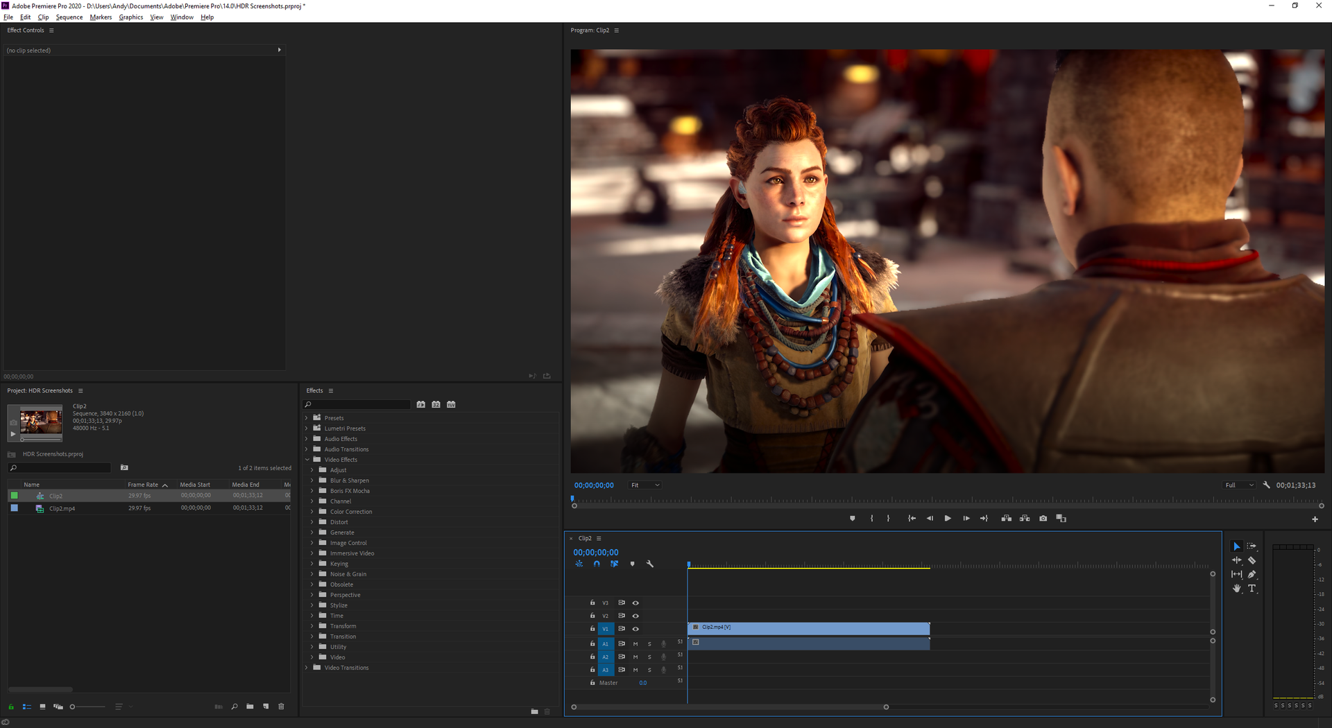

    For an example, here is a project I'm working on right now. Here's what it looks like in Premiere:
    This is the raw unprocessed ST2084/BT2020 footage. Because of this I can use voukoder without my preset. Premiere (wrongly) thinks it's loading rec709 footage because my footage looks like this in MediaInfo:
    and here is how the same frame appears with the HDR tonemapped to SDR correctly:
    much more natural
    and here's what Premiere WOULD have looked like if it originally recognized my source footage as HDR:
    Colors and highlights quite a bit more blown out. While I've used a Lumetri preset to simulate what Premiere does with HDR footage, it's essentially the same idea. They apply a conversion to the original raw data to make it viewable on an SDR screen, but just as a flat 100nit clip instead of tonemapping. Thankfully because of the floating point nature of their video processing, I can reverse this conversion for the most part with my preset, but because that then becomes two colorspace conversions in a row, some loss of color accuracy occurs in the process.
