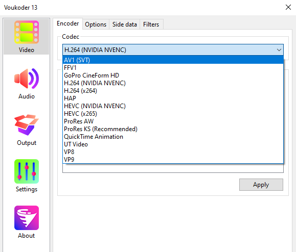

    Is a Nvenc VP9 version a possibility?
    Sure... if and when Nvidia builds a GPU that includes a VP9 encoding engine! So far they haven't done that.
    NVENC is hardware (a special module in your GPU), and not a software program. You can only use NVENC to encode the formats that the physical chip was designed for. So you can't retroactively add NVENC VP9 support to an existing GPU.
    Currently, NVENC supports formats: h.264, h.265, and AV1 (on 40-series GPUs).
