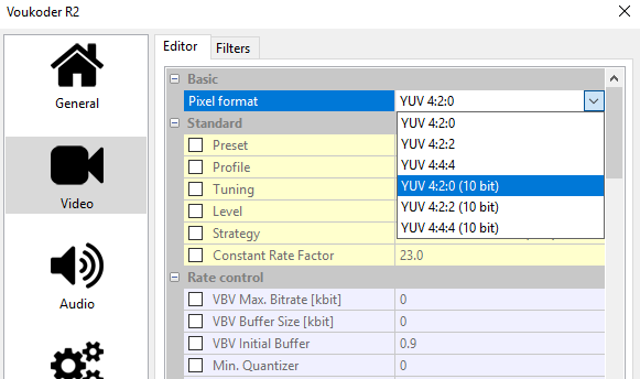

    Second, I love encoding at 10 bit for a bit more efficiency and better dark values for potential screenshots/regrades. I know there's no hardware acceleration, but could this be made possible somehow either way? A 10 bit version is included with the tmod version.

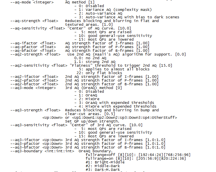

    The difference in tmod are a few extra settings, mostly aq-related afaik, see this screenshot from the --fullhelp:
    In particular I found the OreAQ setting of --aq3-mode rather useful as well as --aq3-boundary (helped preserve more details in shadows and highlights in my test by setting it to fullrange values). It plays together rather nicely with a strong normal AQ, as the normal AQ at higher intensities tends to lose detail around edges, which OreAQ restores.
