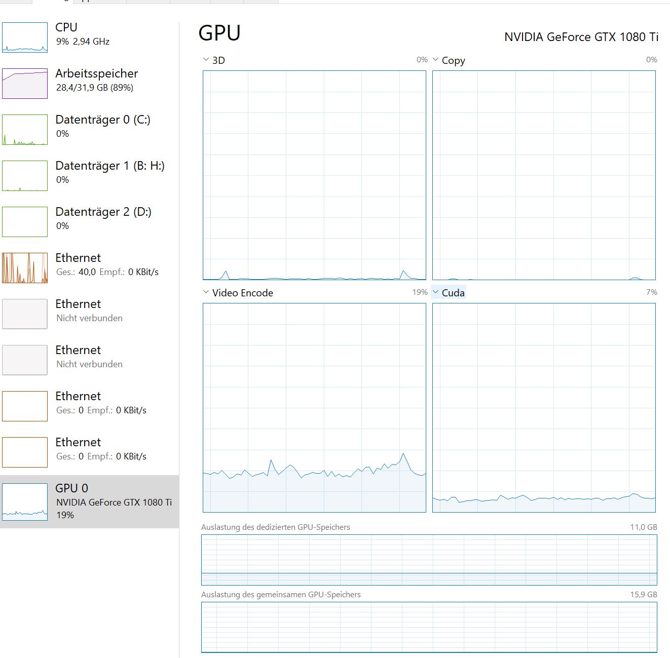

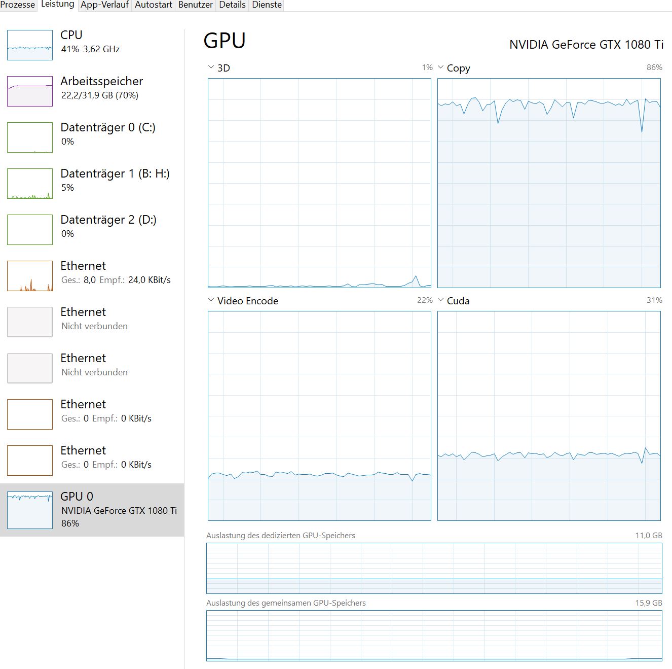

Here are two screenshot from the Taskmanager (CC 2018 usage and CS6 usage) and the logfile which shows the latencies.
CS6 uses way more RAM than CC 2018 but the CPU and GPU usages are pretty low.
It's interesting to see that every 4th frame is slow.
