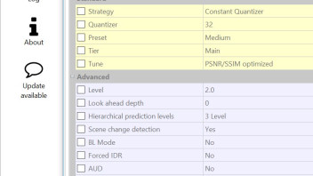

					Yes SVT-Vp9 and SVT-AV1 are pretty experimental. SVT-HEVC works without the two others fine on my side. I think implementing SVT-HEVC is ok, but with the two others we should wait a while. I have done a lot of encoding and stability tests with SVT-HEVC in voukoder now and everything worked. Edit: I can upload a Voukoder .prm file with SVT-HEVC included if you want to test some encodings
					I have implemented SVT-HEVC right now. Doing a pull request tomorrow or Friday which will also include the updated translation

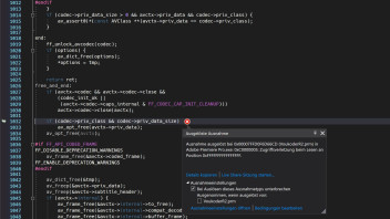

					The smallest resolution I could set without the exception was 1280x720. I have also tested SVT-Av1 in release mode now with this lower resolution. Premiere freeze hasn't stopped in general, but I could open export window more often without freezing with this lower resolution (something around 3/10 times it works instead of 1/10). For now we should wait a while as you said, before implementing it finally. I will test SVT-HEVC and SVT-VP9 in the next days if they have the same issue in release mode and write my results down here
					I think that resolution is too low. I'm getting this exception then:

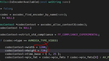

					I think I have maybe found a fix and an speed improvement in general  Setting the resolution to HD instead of FHD speeds up loading times of every video codec. For SVT-AV1 it means RAM usage only goes at 9 GB and the loading time from 9 seconds to 2,5 seconds in debug mode. I will test later in release mode. I have attachted a screenshot with the lines in the source code (EncoderUtils.cpp).
					Yes that would be the best option. I will test SVT-HEVC and SVT-VP9 too if they behave the same.

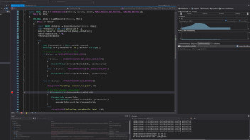

					When opening the export window and svt-av1 is initialized to check if the codec is available, the ram usage goes up to 12 GB from 4GB. In visual studio you can also see that there are a lot of threads which are starting when svt-av1 is loaded. This scenario appears only when svt-av1 is loaded. You can see it in the screenshot below If I skip the check with this code: Codeif (id == "libsvt_av1") { EncoderInfo encoderInfo; if (EncoderUtils::Create(encoderInfo, jsonResource)) encoderInfos.push_back(encoderInfo); return TRUE; }everything works normal.
					It's really strange, sometimes when running premiere it doesn't freeze when opening the export window and I can export a video with svt-av1. But i can't say whats the exact thing that causes the freeze, expect compiling in release mode. But I have also noticed that opening the export window in premiere when compiled in debug mode, premiere is not responding for 1-3 seconds, but then it gets its act together again. I think it could be something with the C/c++ optimizations when compiling, because in debug mode it works every time on my side, except the little not responding time.

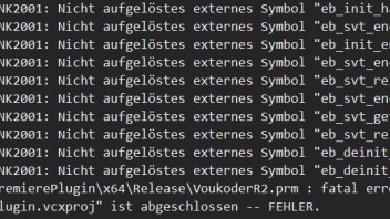

					You need to add the new lib to lavf.h. Thanks, that worked
					But i got another problem now.
