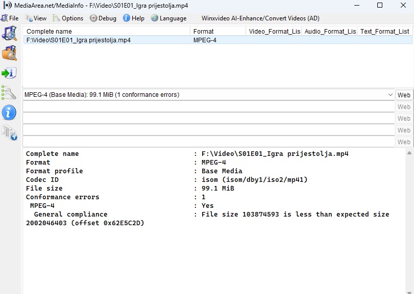

miki1hr Can you please try if this issue has been fixed with this build? https://d.voukoder.org/VoukoderPro-2026.0.18.msi
I tested the new version and now all HDR data is displayed. I am using nvidia (hevc) for encoding.
Thanks again for your support.
Got it fixed! This seemed to be broken since version 2 or even longer. I'm preparing a new build ...
Thanks for quickly discovering the problem.![]()
Yes, I will check tomorrow.
Edit: I have checked this. The data is written just like in version 2. But it doesn't show up in MediaInfo anymore. Maybe FFmpeg 8 is handling this differently now.
Edit: Seems like this data is supposed to be set per frame now, not per stream. Checking ...

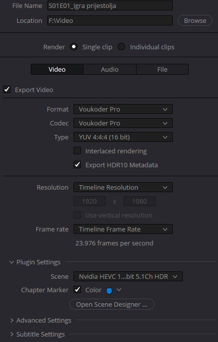

Thanks for the new version, it is now properly displayed in the media info. Can you also solve the problem of missing HDR metadata data after encoding the video?
Hello,
I am using the latest version of Vokuder Pro (Vokuder Pro v2026.0.16.0) and I have a paid license.
I tested the video export with HDR settings and after encoding the HDR data is missing again. The problem was the same in Voukoder Pro 2.
Is there something wrong with the settings?

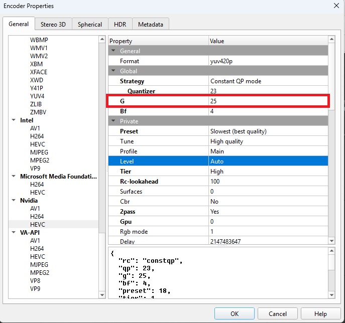

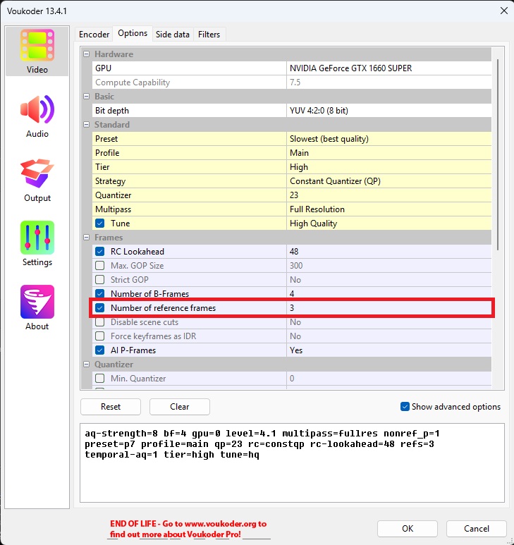

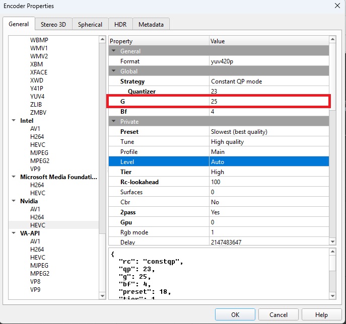

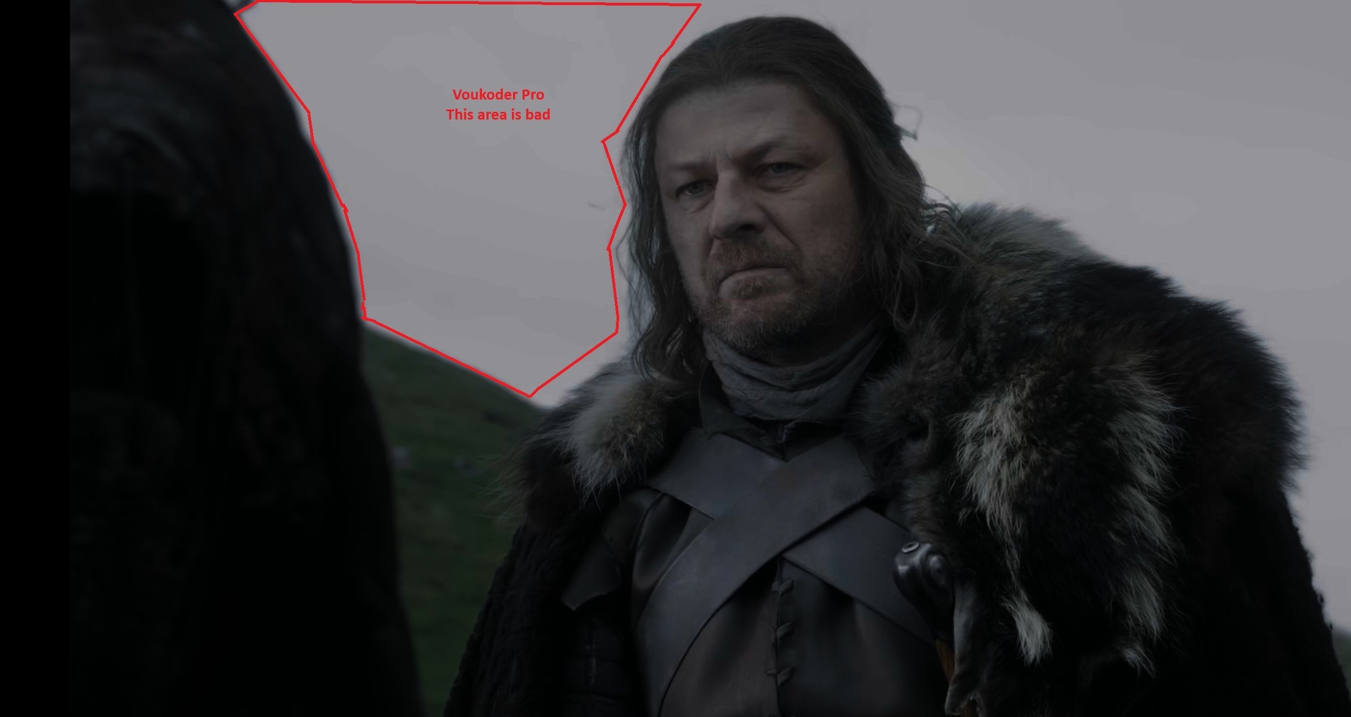

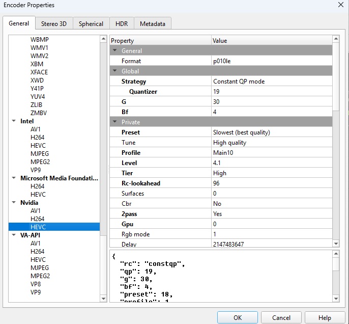

Hi,
I need help. I'm trying to set the settings for HDR video in Voukoder Pro, but I'm doing something wrong because after encoding the video is not good.
When I encode the video with the old encoder the result is good as you can see from the example.
My settings for both encoders are attached. How to set Voukoder Pro to have the same or similar settings as in the old encoder.
Voukoder_HDR Settings.pdf Voukoder Pro_HDR Settings.pdf
Best regards
