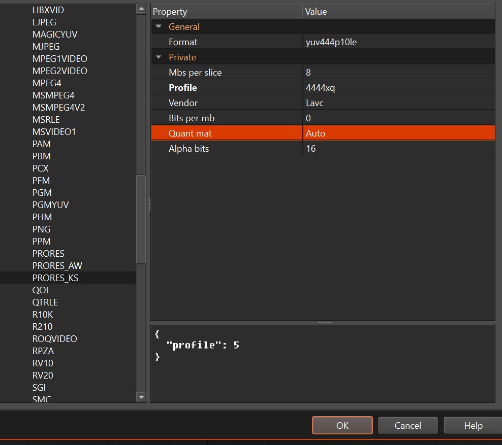

For some reason it doesn't accept the profile setting (only by autodetection through the color format). Sounds to me like a bug inside FFmpeg. I'll investigate this further and report it to the FFmpeg devs.

using the free version of VOUKODER i was able to export 4444 XQ prores files.
Now it seems to don't work with the last version using same parameters on PRORES_KS menu

Yes, you'r right. But i didn't mess those options.

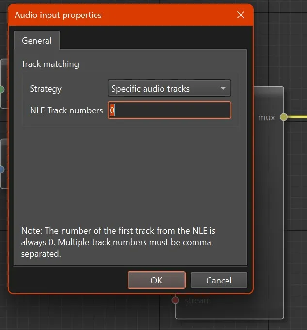

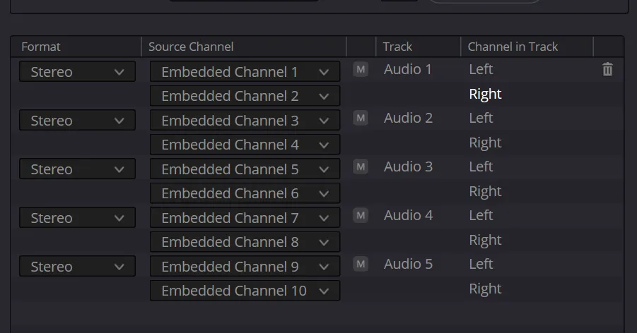

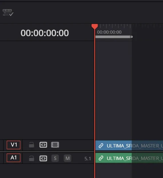

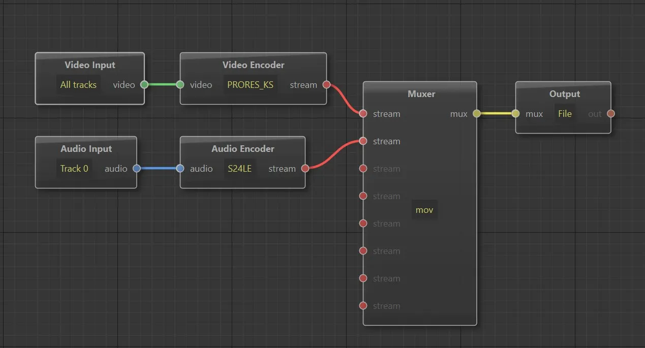

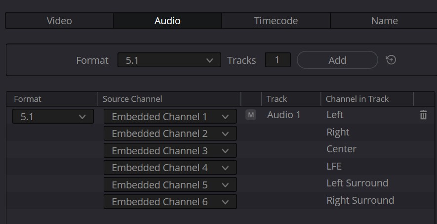

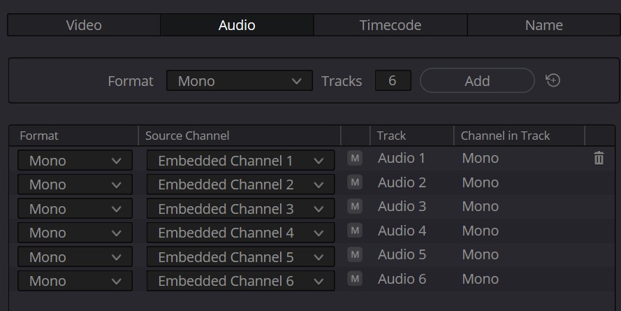

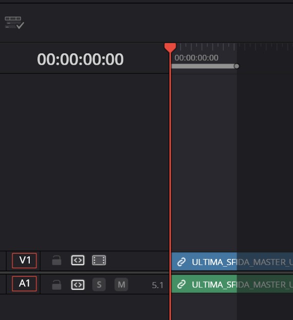

i try to explain! this is my TL configuration and export settings

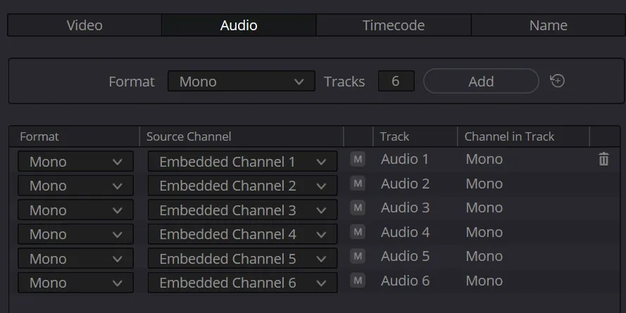

when i import file in NLE software it recognise the 5.1 as a multimono track

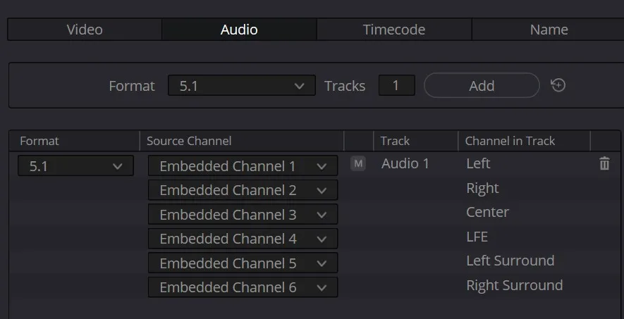

exporting from NLE instead, i can obtain 5.1 interleaved tracks and it would show like this
If i open the prores file using QUICKTIME PRO, and i refresh 5.1 metadata, it will works fine!

Hi Guys... i use to create multi channel MASTER files in with audio channels are grouped into interleaved tracks.
If i have 2 tracks with 5.1 channels, i wuold like to obtain the same scheme into the MOV file. Instead i reach multiple mono tracks. I can fix it inside Quicktime Pro using a manual set.
what i am doing wrong?
